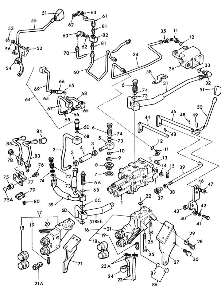

Ok i just picked up my 3910 and there are no hyd Remotes on it.
I would like to add some, What all do i need to do to make this happen? Im waiting on a owners manual and service manual to come in so i got no reference to anything right now..

There are several remote hydraulics options for the 3910. One of them is shown in the attachment below. It is a dual system, but I think there are single remotes available. I have no idea what the price is, but I'm sure they are not cheap. New Holland remote hydraulics kits are elegant and well made.
   / Ford 3910 no HYD Remotes?
Ouch I never thought a price like that. Maybe ill just stick to no putting them on here and just use the 1066 for anything i need hydraulics.

Polaris- It would be cheaper to add a pump driven off the front of the crank and make your own lines and add valves. My 3910 didn't come with an aux pump or valve body either. When I checked the prices of factory equipment, even used, it was more than I wanted to spend on a 24 year old tractor just to have rear remotes. If you're handy at fabrication, the brackets are easy to make. It will also let you choose the pump capacity if you choose to add a FEL later.
