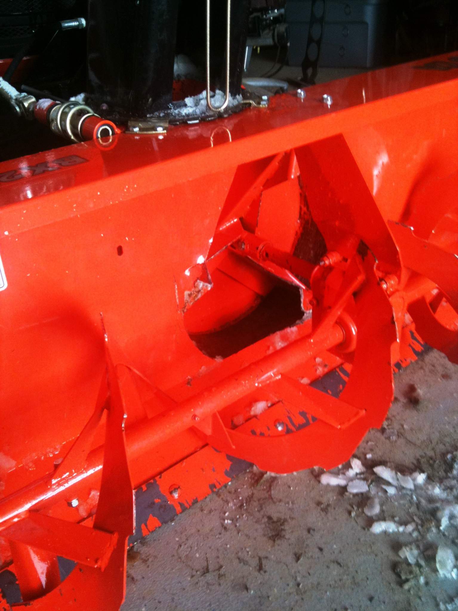

I must have hit a rock and for some reason the sheer pin for the blower didnt go off in time. The impeller literally destroyed the housing to the point where the impeller was locked up (two of the three fins were outside of the "housing" causing it to lock. all the paint broke on the welds. It was a mess.
I took it down to my barn and with the precision of a 20 lb mallet, managed to get it blowing snow again. I do have KCC insurance on it with a 250 deductable, but im sure the dealer would have just bent everything back, and maybe put some paint on it. I have since picked up a bag of sheer pins, both for auger and impeller.

It doesnt sound like the shear bolts did what they were supposed to do. I have broken several shear bolts (both primary and secondary) over the years and they do a good job of stopping things before any damage happens. You might want to check to see that the proper shear bolts were installed. The manual tells you how to identify them.

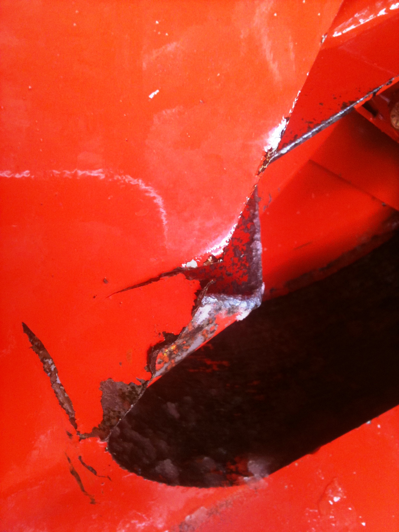

Thanks for the advice. It has gotten worse. The sheer pins that were in it at the time of the "silent accident" were what came with the blower. It seems like the replacement ones I bought are more apt to break, especially the two auger ones. It looks like ***** right now and only has about 5 hours on it. Before I pay it off this year, im going to use my $250 deductable and ask my local dealer to give me a new box, augers and impeller. They all have massive wear on them already. The metal around the front of the impeller (behind the impeller) is very thin, and is just sheering away. You can kinda see from this pic... (sorry its a camera phone pic).
Thanks again guys for all the friendly advice. It still shoots snow like no ones business so Im probably going to get through this winter before I claim anything. Also, tried adjusting the shoes all the way down. Apparently its not enough because im still getting little rocks in there from the stone driveway, granted not as bad, but still.
Andy

Talked to my dealer today and even showed him pictures. He said no problem, they will rebuild it in the spiring with new box, impeller, and possibly augers. That will be a good $250 well spent. Now I just need to devise a system so it doesnt happen again. I had my skids down as far as they would go.
Thanks for the advice!
Andy
