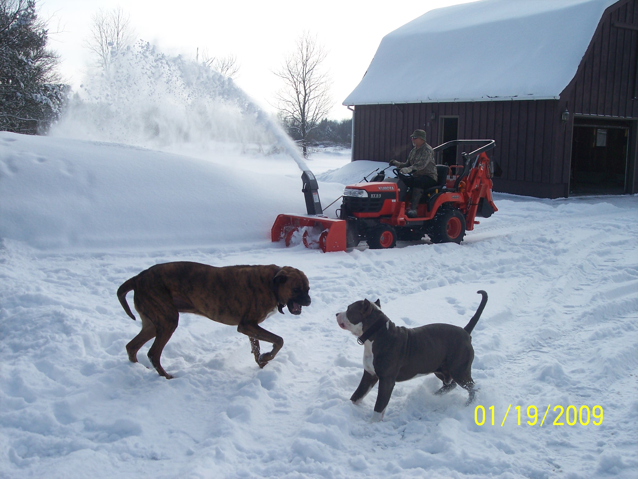

Not to worry about the paint, at the start of every snow blowing season I spray paint the chipped paint. Do the first stage, ( auger) and then do second stage,(fan), you can buy @ TSC. Front blowers with two stage are the nuts, snow does not stop them, but remember to do all required maintance and it will run just fine.

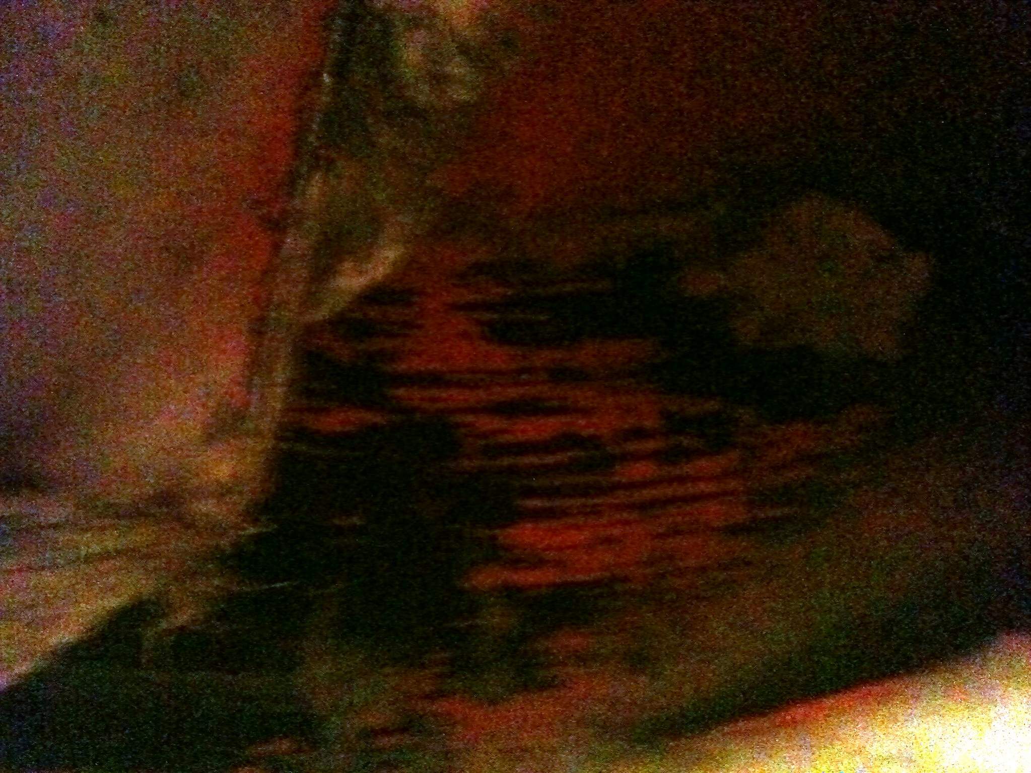

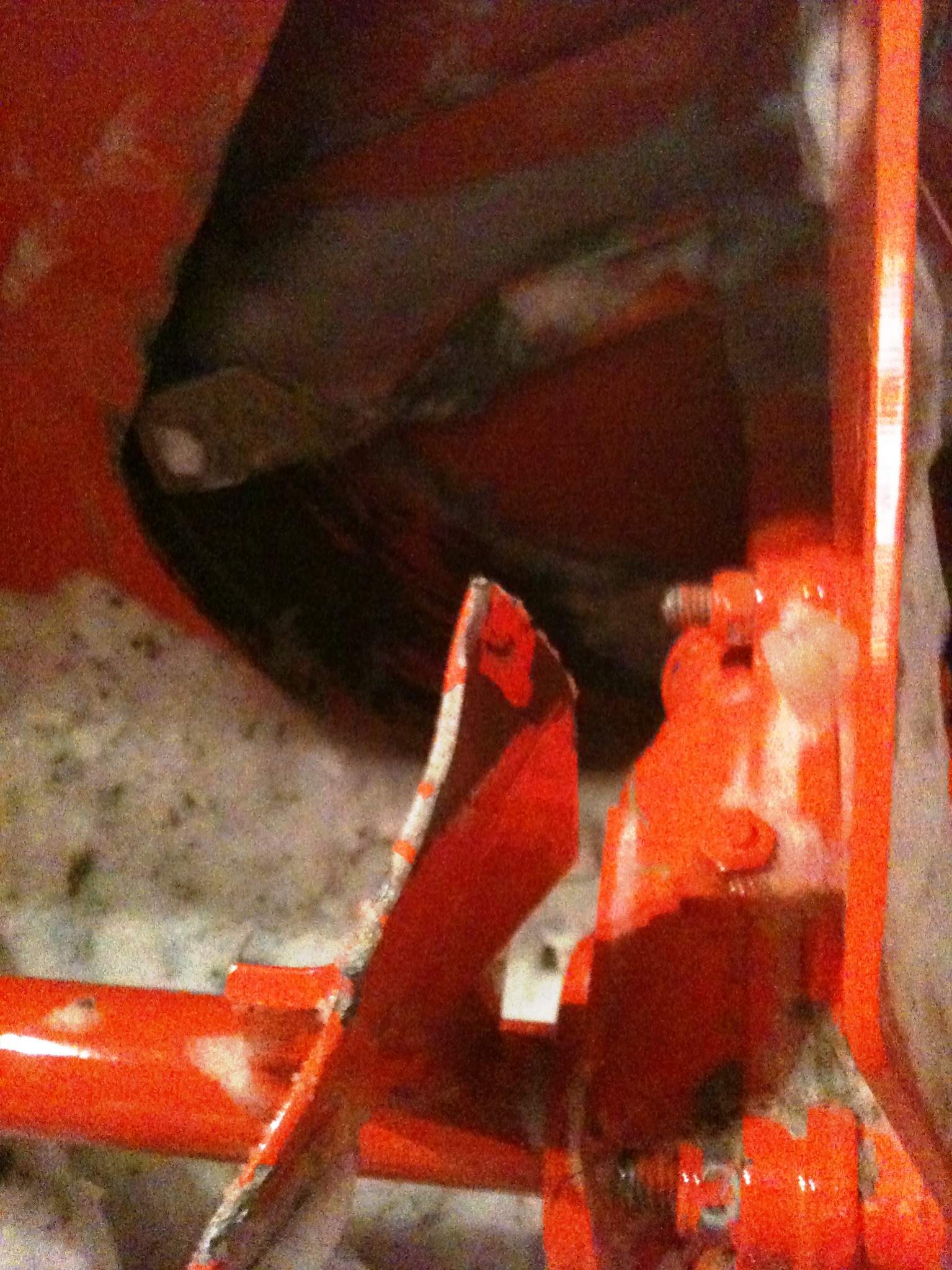

Pics:
I have since took a giant cresent wrench and hammer and straightened it out to factory spec. Is that turbine wear normal?

Mine are both totally silver!!
In float mode, the blower sill sit on the skid shoes- however you have them mounted.
If it were me, I would sit about a quarter to half inch off flat, to accommodate the gravel. You can force the blower down (and raise the front wheels off the ground) to scrape the pavement better but keep in mind, you lose your steering!! I do it in 30-40 foot runs.
If your blower is new, why not use fluid film on the chain?!! Some use motorcycle or bike chain lube, as it is supposed to cling. In the spring and fall I run the blower slow and pour a little 30 weight right on the chain!!

Pics:
99% of the time, damage such as that are the result of rocks, wood or other debris getting pulled in.
Normal, I would say yes for most.

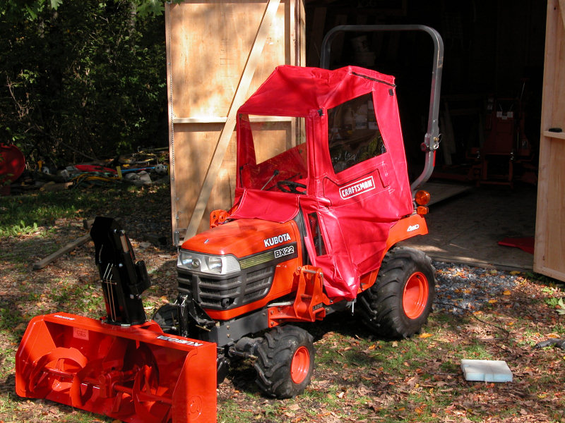

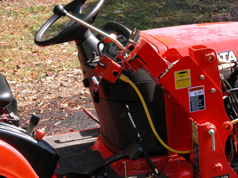

Blower is great.
Blower with remote chute controls is like heaven
Blower with remote cute controls and a cab is not to be matched.

I must have hit a rock and for some reason the sheer pin for the blower didnt go off in time. The impeller literally destroyed the housing to the point where the impeller was locked up (two of the three fins were outside of the "housing" causing it to lock. all the paint broke on the welds. It was a mess.
I took it down to my barn and with the precision of a 20 lb mallet, managed to get it blowing snow again. I do have KCC insurance on it with a 250 deductable, but im sure the dealer would have just bent everything back, and maybe put some paint on it. I have since picked up a bag of sheer pins, both for auger and impeller.
