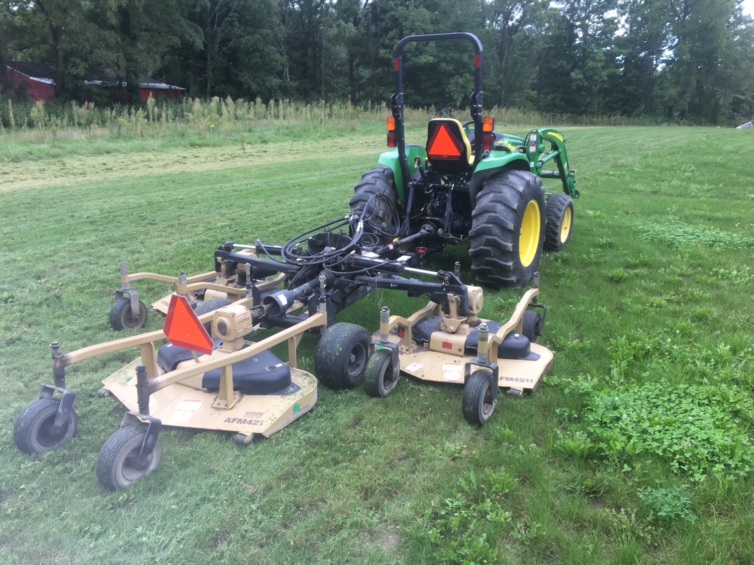

The rear finish mower I’ve been using finally died (extensive deck rot) so I’ve been on the hunt for a replacement and started to look at flex wing style finish mowers. Anyone using them or care to share your experience? Some of them have ridiculously low hp requirements, almost too good to be true. I’ll be pulling it with a 4720 Deere so I’ve got a little over 50 pto hp. How is the cut quality? Any compromises other than how big and bulky they are? Thanks!

I had a 15 or 16 foot Alamo, gearbox driven. For whatever reason, you can get them quite cheap used. Be careful, the main gearbox on my Alamo had a replacement cost of $6000 already ten years ago. I never needed one.
I would go hydraulic so you can operate the decks independently for narrow locations.
I would (ONLY) go with a model that had LARGE castor wheels, like the bushhog.
The sound these high lift mowers make is awesome and leaving a cut width behind you like that will make you smile. :)
Life is too short to cut grass a few feet at a pass!

I got one!!
Picked up a used land pride and ran it for the first time this evening. So far so good, I’ll update when I get a chance to run it more this week.
