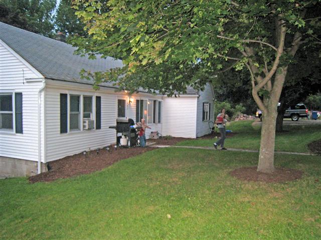

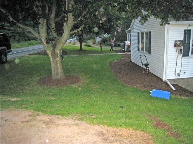

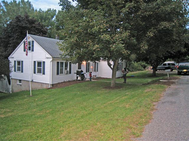

Had to see how it worked in the yard tonight... :) I can clearly see where the missing knifes are! LOL
Now, I want a 48-60" version for my little tractor! The 72" is a little big for smaller lawn mowing.... Although I could settle into it I am sure - just requires more trim work which I hate.

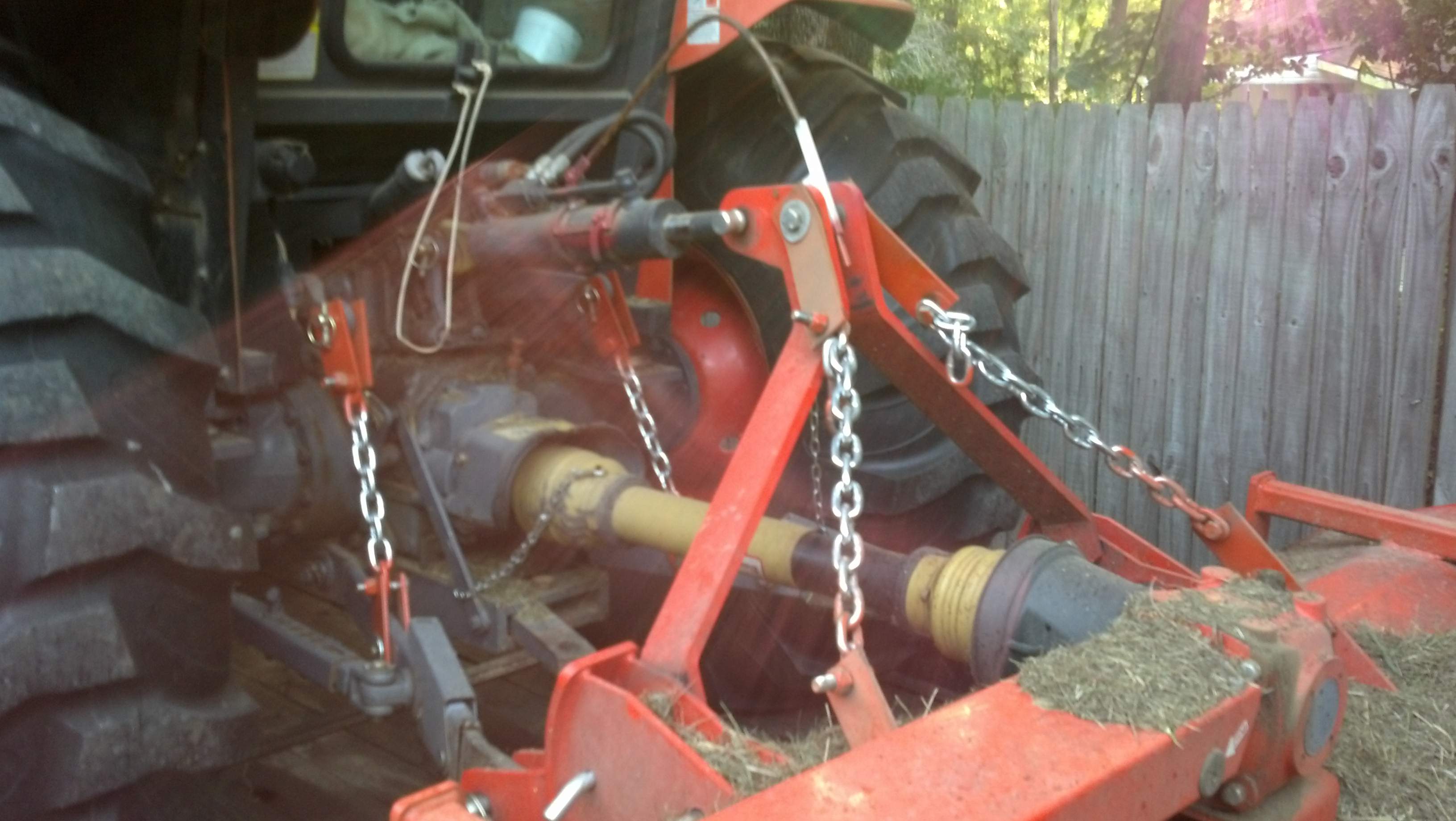

i put chains on mine because i use it to mow ditches and uneven slopes. it helps keep the cutter flat on the ground and takes the stress off the hitch parts when you cross uneven areas. 110.jpg
the chains on the flail mower braces are used because i replaced my rear roller with bush hog style tail wheels.
