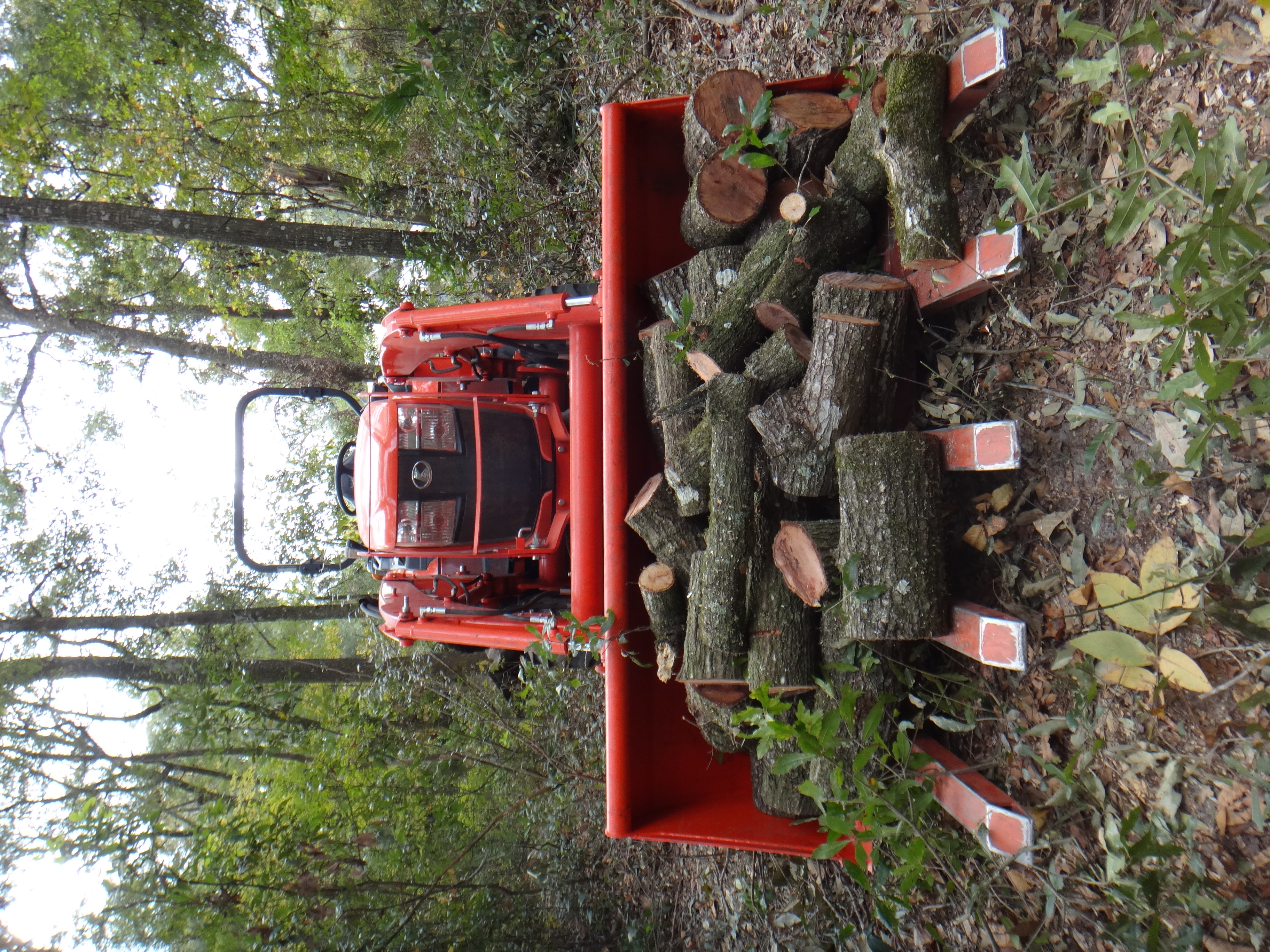

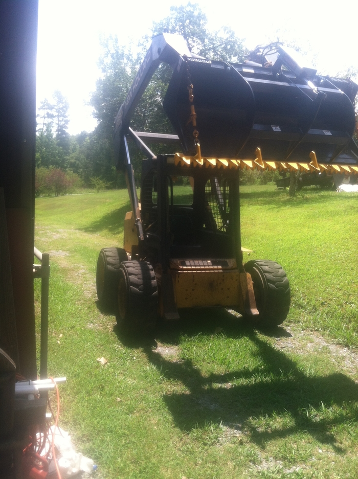

I have clamp-on aluminum Debris Forks by Hayne's but find the blunt forks of the attachment tend to push piled brush in front of the attachment, unless brush is against a tree, or pick up quite a lot of dirt with the brush. So, a little more hand loading of debris on to the forks than I anticipated.
When I sold my Kubota B3300SU tractor-loader in favor of heavy chassis L3560 I kept the Debris Forks. Hayne's Debris Forks have served equally well on the heavier tractor.
Never a question concerning strength of the forks nor solidity of mount on bucket.
Had I a chance to choose over I would test a set of pointed Ultra Forks:
Multi-Spear Ultra Fork
Nice feature of both Debris Forks and Ratchet Rake is minimum storage space required when not mounted.
