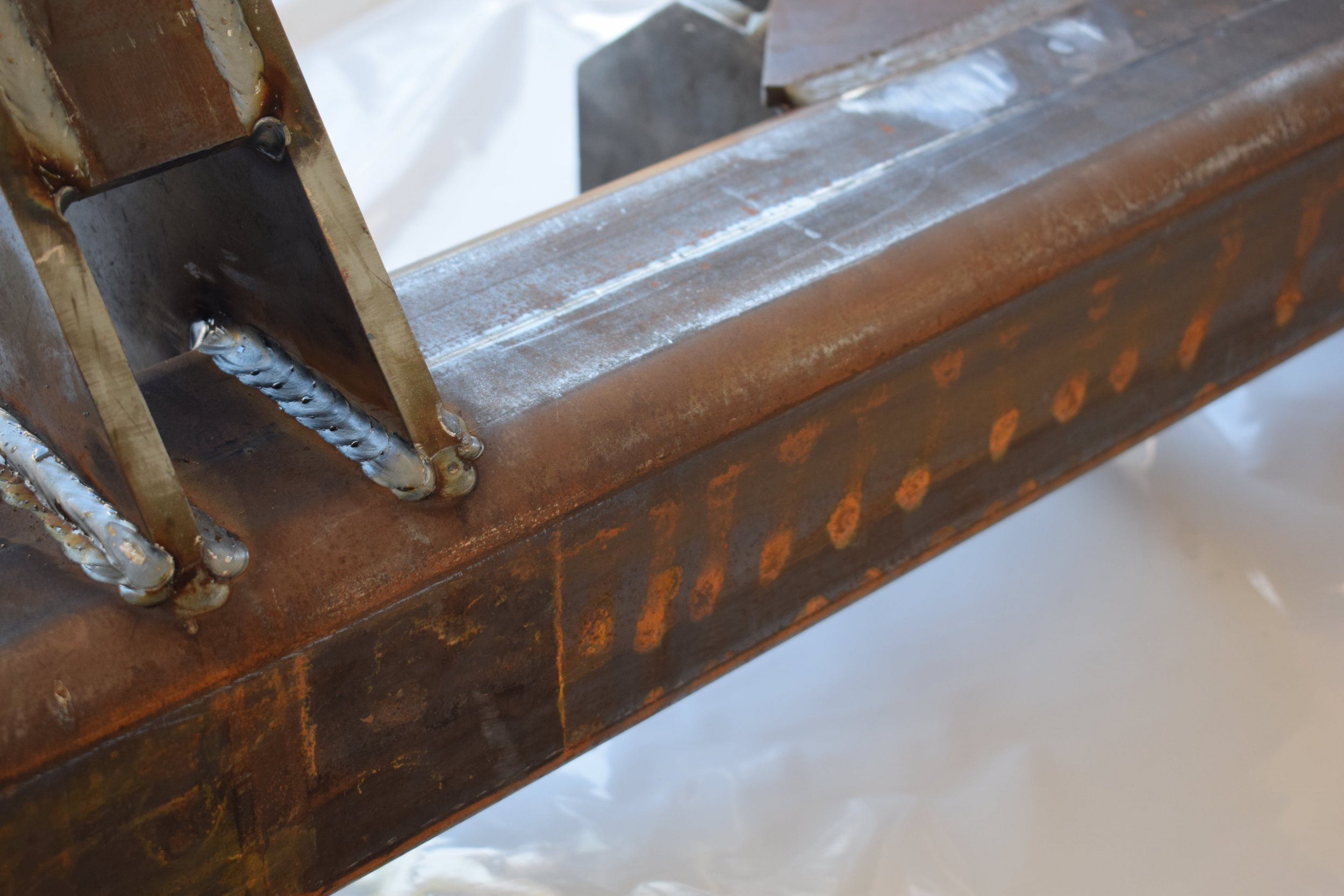

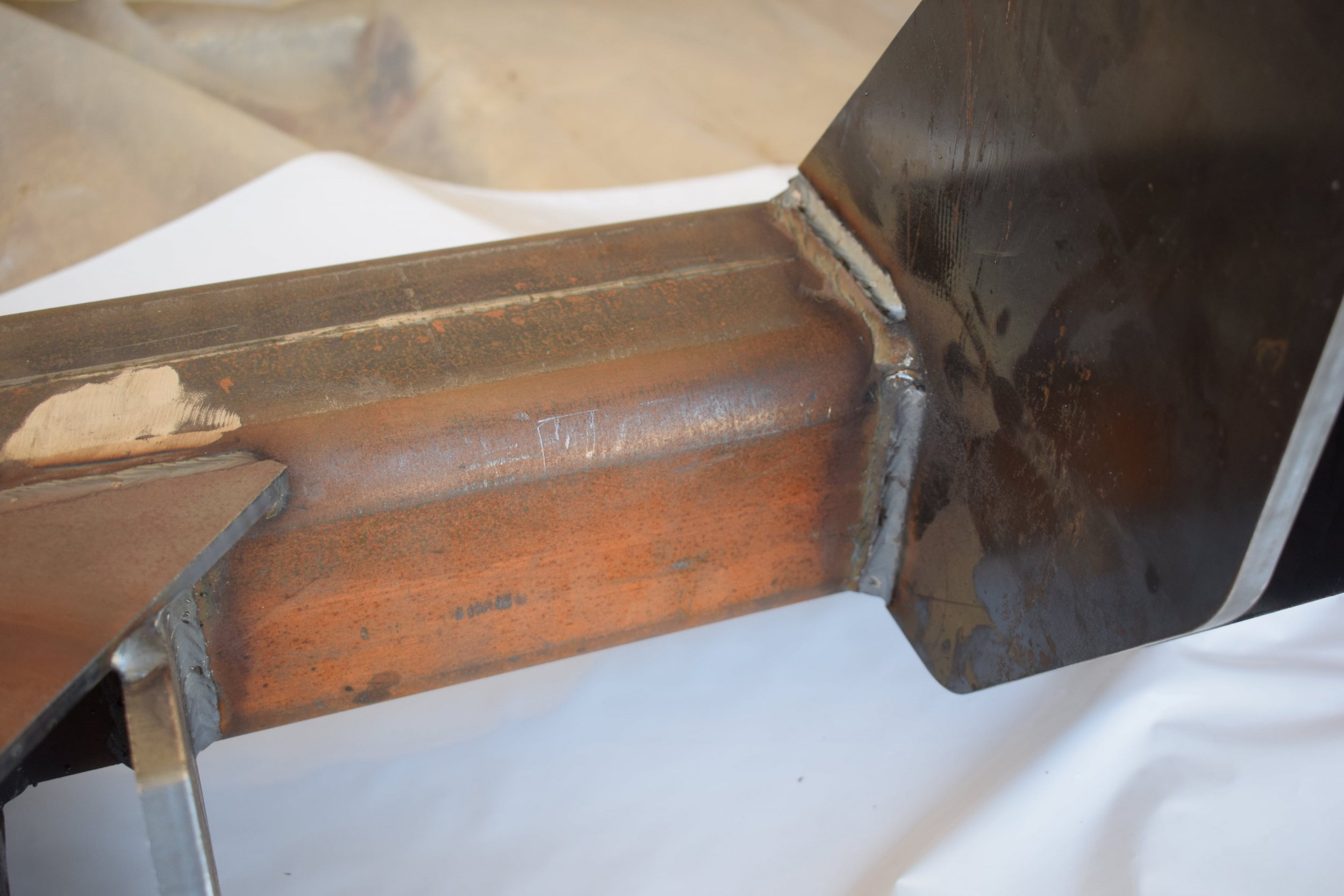

This is my first time spray painting steel. My plan is to use wipe the implement with a thinner, spray rust converter, use a two component primer followed by two component enamel paint. I've been told I don't need to remove the surface rust because it is so thin. What are you thoughts?
If grinded, I am not sure how much of the surface detail is going to show through the paint.. What tool (angle grinder, orbital sander...), what wheel type(flappy, wire, nylon..) and what grit size is best used to remove thin surface rust that will leave appropriate finish for the paint? I feel like angle grinder is going to make an uneven surface. I don't currently have an orbital sander at home, so I cannot test it. Do you think orbital sander is the more appropriate tool?

I'd use a wire wheel/ wire cup brush. Wipe clean, prime, and paint.

Cup brush definately. That sounds like overkill for a farm implement but a good plan. What is the implement? Looks like some very nice fab work you did. Those are excel;lent welds. Pics of what you built would be nice.

I like Ospho for this.
DITTO !!!
OSPHO first, then paint and primer.
No need to sand anything there.
OSPHO will adhere to that very light surface rust even better than absolutely clean steel.

I agree with the phosphoric acid treatment but you need to make sure it is completely dry before priming. It will have a chalky look when dry. If you are painting with a compressor/gun, also make sure your spray air is dry during priming. Use a filter/drier before the hose and blow-out the hose before using it. Drain the filter/drier after each use.
This is cheap insurance when you think about the cost of good paint and all your hard work. Ditto on the excellent welding job. (y) Can't wait to see the finished product. :cool:

NOPE !
OSPHO first!
As described above, allow OSPHO to dry thoroughly, to chalky look.
Then a very light hand sanding+prime+paint.

I would recommend the wire cup brush. Your goal not being to remove all of surface rust, but to knock anything loose off. Without this step, it has been my experience that the loose stuff breaks off regardless, but usually after you have treated it, primed it, and painted it. It leaves a bare rust spot that is deal-able but more involved than a quick wire brush treatment prior to cleaning prep work.

The OP's pictures do not appear to show any "loose" rust.
