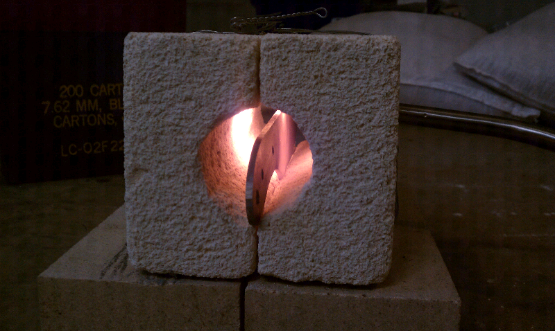

Thanks, the blade is 1/8 inch thick. I got the steel, pins, lanyard tube and micarta from jantz knife supplies. The tools I used were a angle grinder to rough profile the blade, a small 1x30 belt grinder, drill, lots of sand paper, buffer and this small mini forge. I found plans on YouTube, watched other knife makers on YouTube and referenced the $50.00 knife shop by Wayne Goddard.

What steel/alloy are you using for the blade? Do you know how hard you are getting it to when you are all said and done?

NICE ! What temp do you heat to and how long do you quench...quench in oil or water ? where did you find the forge ? what is it's fuel ? oxygen ? sorry bout all the questions...but inquiring minds gotta know ! :laughing:

The temp is around 1800 degrees or so, not really sure. I use the magnet test. When the metal is about whit hot I touch the blade to a magnet and if there is no attraction then its ready. I quench it in canola oil. The forge is a small fire brick I made. Been trying to post a short vid but can't get it to work. The steel is 1095.
