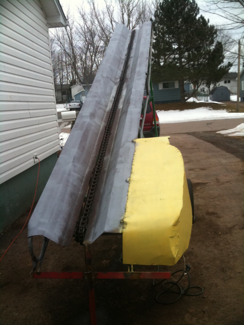

I got a good deal on a ran over, bent up conveyor. It was originally used for hay but converted to firewood.
I change bearings, chain, sprockets and installed a leg, hopper, electric motor and a counter that counts each piece of firewood that goes up the conveyor. I am going to install a deflector shoot so i can direct the firewood to the exact spot on the load.
So now the wood comes off my buzz saw and goes up the conveyor and into the dump box of my truck.
