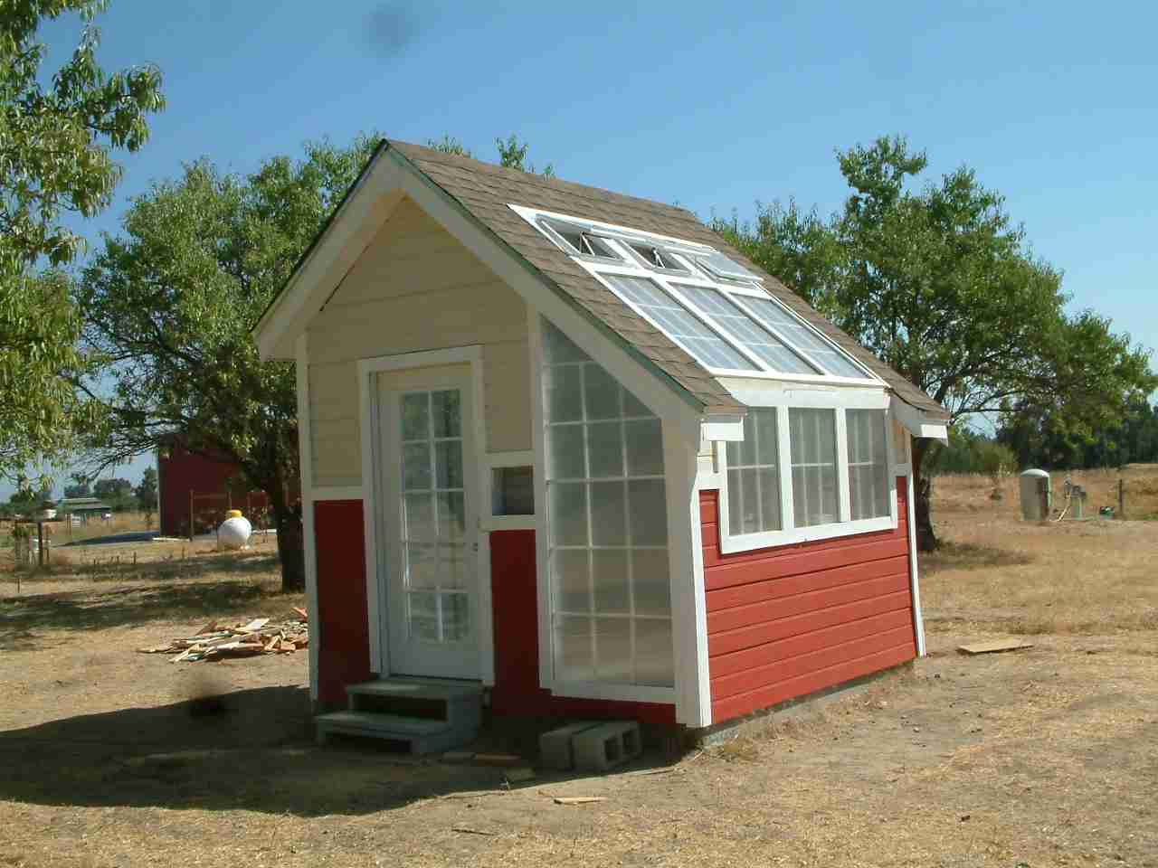

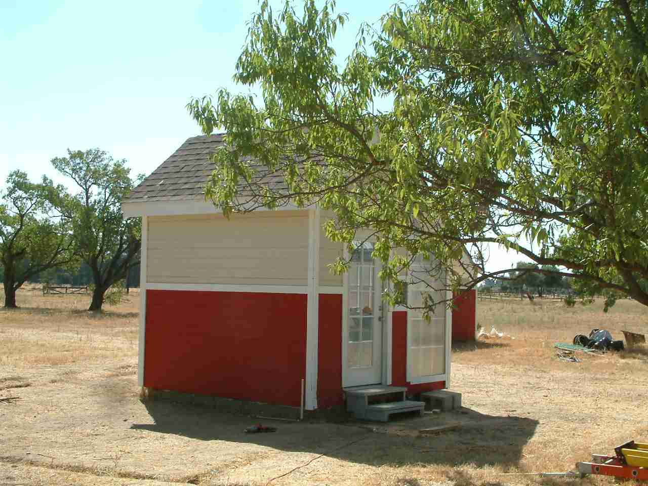

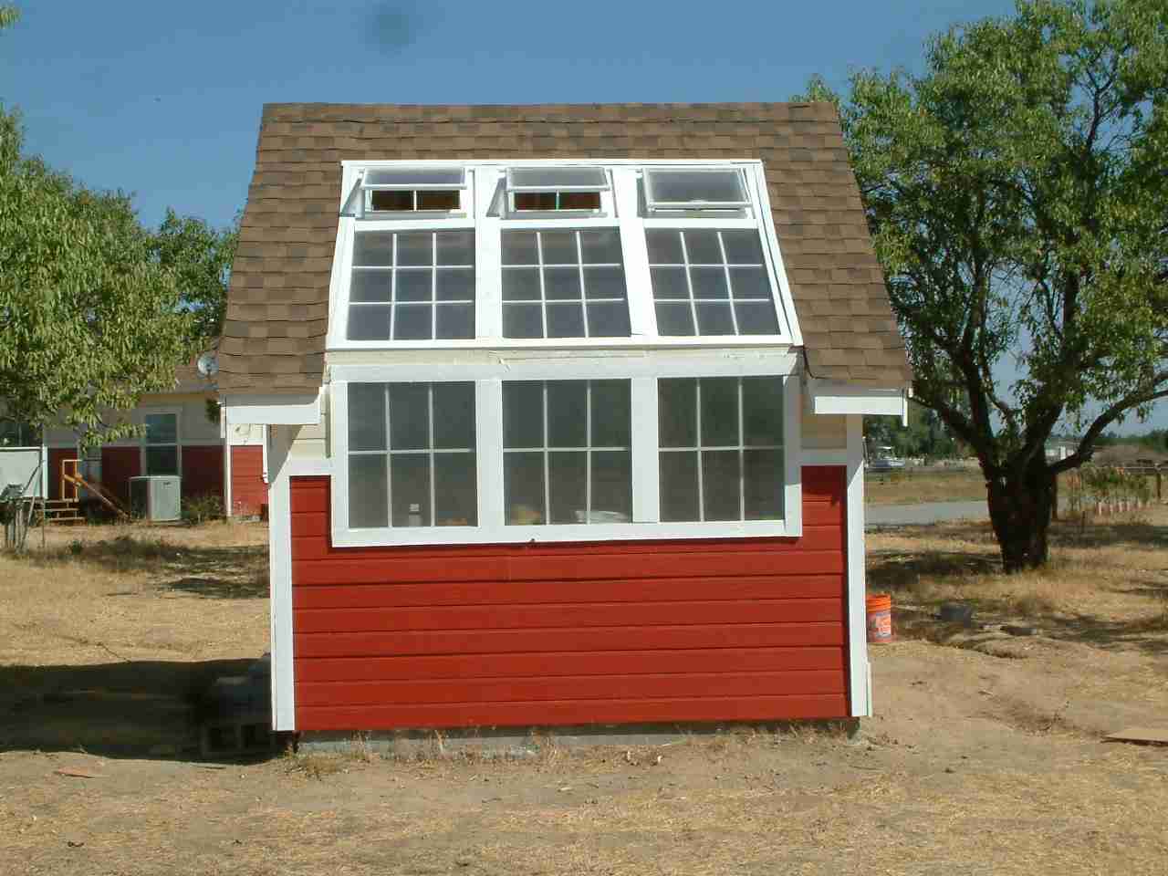

Finished this summertime project a week or so ago. It's a saltbox greenhouse called a "sunshed". Floor plan is 10'x10' with 8' walls.
Windows are polycarbonate twinwall 1/4" thick.
Has three vent windows operated by greenhouse vent openers plus a thermostatically-controlled ventilation fan.
Used the 21-hp Kubota B7510HST/LA302 FEL and the 4-ft KK box blade to clear and level the building site and for toting material to the jobsite.

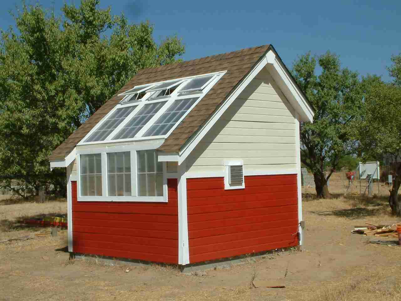

Real nice looking sunshed. Nothing like having a shed (I did once) with only one window on one end and doors on the other end that is dark in the middle! Pardon me for asking but since the windows open up top is there a use specfic reason for what looks like the side vent on the wall of the shed?
   / Finally finished the sunshed
That vent opens towards the inside and the fan pulls air through it.
