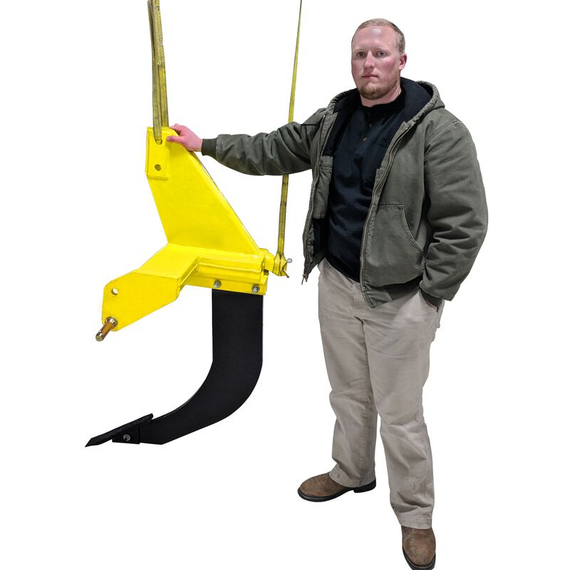

A single shank subsoiler is all your mule is going to be able to handle.
One of the titan subsoilers from the dealer in Ontario will work as long as you have traction and loaded tires.
if you remove the toe/shank you should have no issues as all your doing is breaking and bringing up roots anyway

Turned up, roots will die in the sun.
If your bush is anything like the bush here... It is not going to hurt to paint all the cut ends of bush stumps and root ends you can with Round Up, right from the bottle, even if you eventually turn most of them under..

You never want to invert soil so subsoil is turned up.
Therefore compact tractor plows come in 12", 14" and 16" widths, which turn soil to a depth of 6", 7" and 8".
The larger roots likely lie deeper and can be ignored. If the trees associated with the larger roots are dead, the larger roots will decay over time. I apply an herbicide, usually Cross Bow (2-4d + Triclopyr), to fresh tree stumps to insure rapid death of stump and roots. Others avoid herbicides.
A subsoiler catching a deep 4" diameter root will stop a compact tractor. To be safe, engage Draft Control if your tractor has Draft Control or use a subsoiler with shear bolt or "trip" protection, the same as if plowing.
I don’t understand how Draft Control could help when encountering a large root or other immovable object. How would it react fast enough to prevent shearing the bolt, tripping the implement, or stopping the tractor?
Thanks
   / Field clearing #18
Thanks
When implement encounters an obstacle, pressure is applied to the top link. A sensor then triggers hydraulic system to raise the implement instantly. Sensitivity of the lift is adjustable.
Draft Control was one component of the Three Point Hitch developed and patented by Harry Ferguson in Ireland and England during post WW1 years. Then, everyone plowed and tractors regularly toppled over backwards. Few or none had ROPS and there were regular fatalities.
Ferguson licensed his patented Three Point Hitch to Henry Ford in 1939 and Draft Control has protected operators in USA ever since, WHEN ENGAGED.
   / Field clearing #19
I understand draft control. I asked as the draft control I’m familiar with doesn’t respond that quickly. I’m more likely to be hung up & stopped or spinning tires by a root or stump before it responds. A subsoiler is too much of a fishhook.
