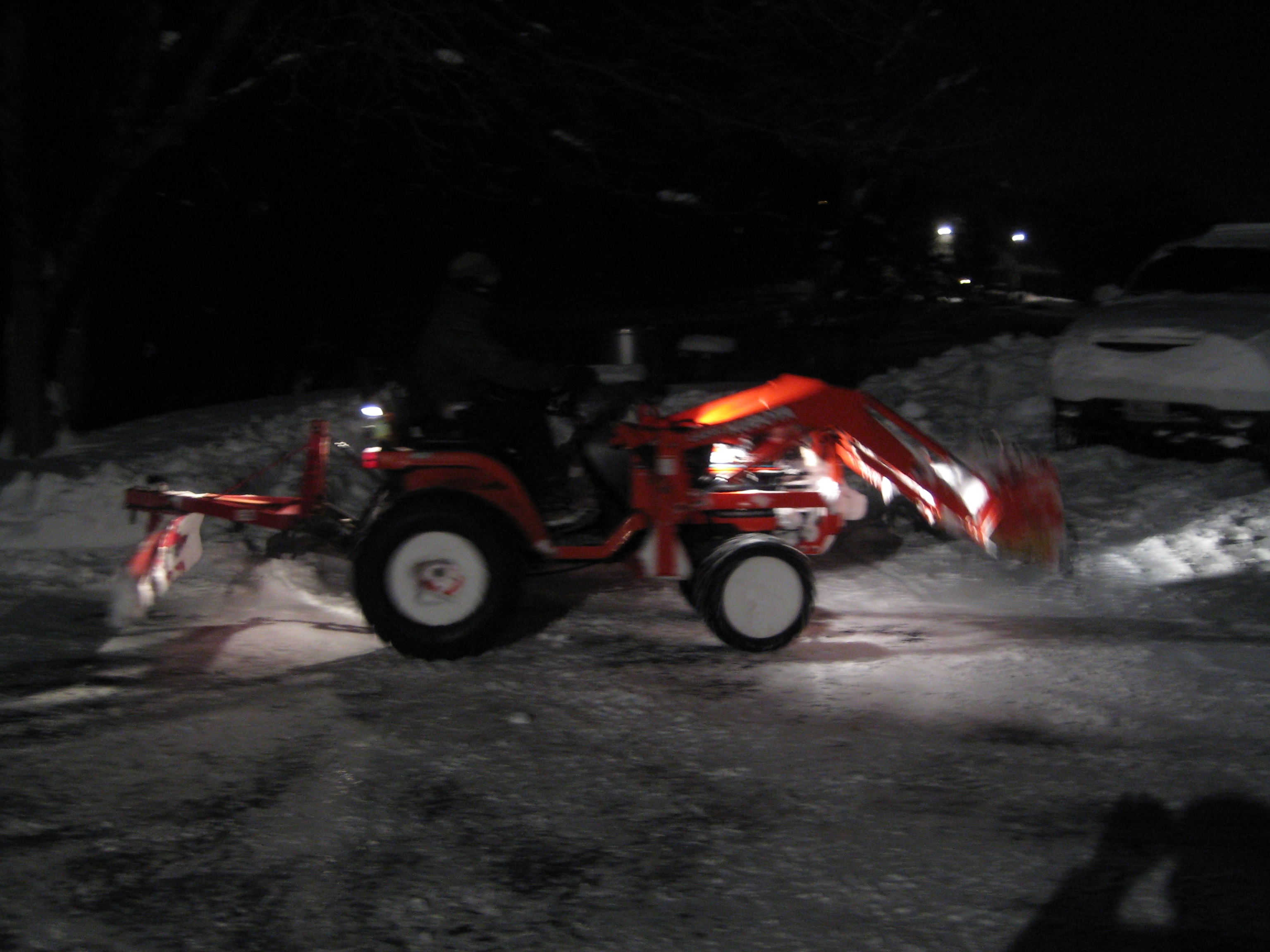

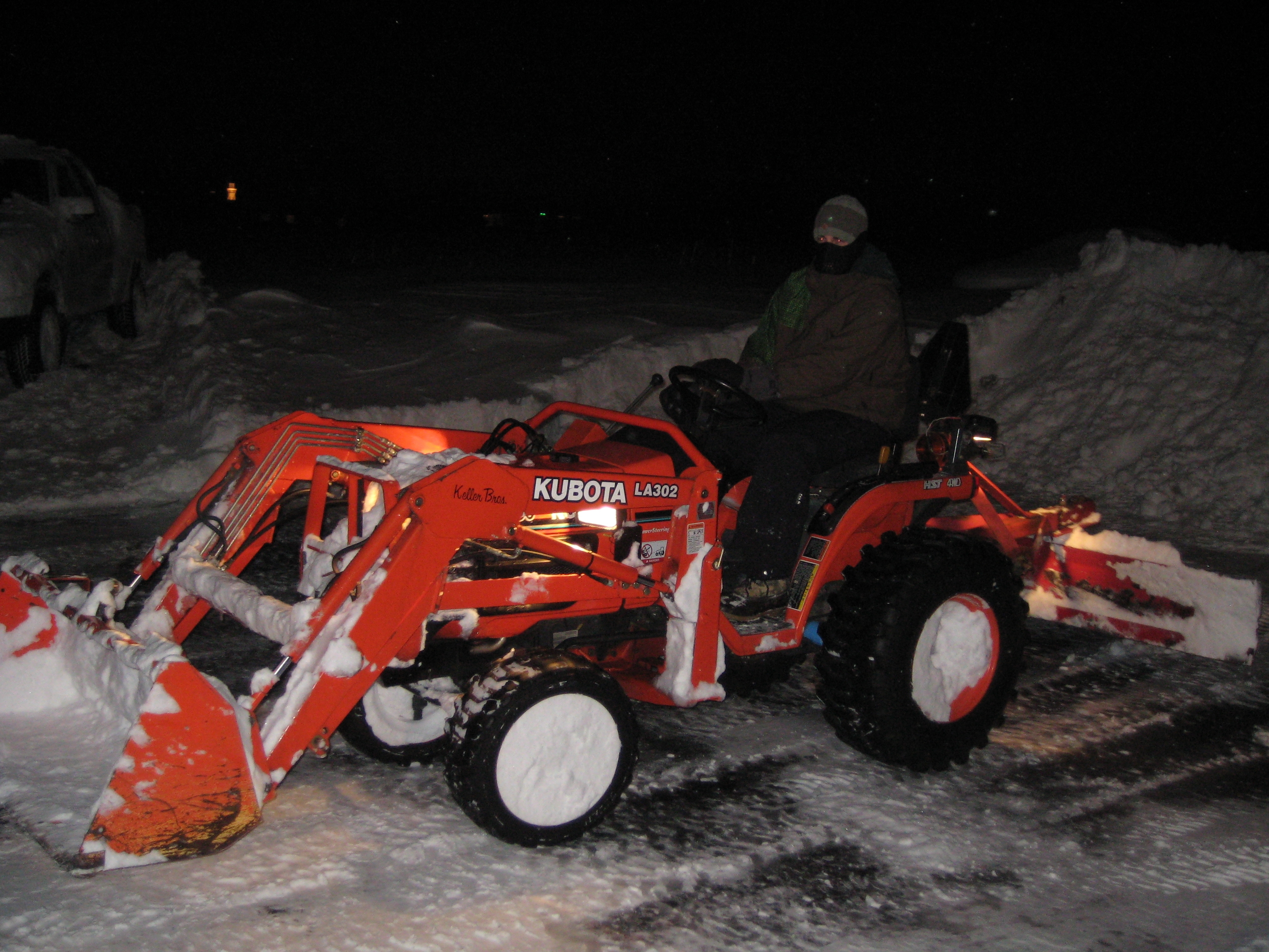

The only fender-mounted lights I had were on the Ford 1210. They were pre-LED and not terrific. On the B7500 I had, I made a couple brackets to mount a halogen flood light on each side between the loader frame and hood. They worked remarkably well and lit an area of almost 180°. Back then mowing often happened after sunset due to schedules and working up to 2 hours away from home.
One thing I mentioned before when discussing lighting is the better definition the halogens provided. The LED's throw blinding light but when mounting them on the ROPS or front of a cab, they didn't contrast the cut/uncut grass like the halogens. That was resolved by mounting an extra pair of LED's low on the front so they "raked" the area in front of the tractor (like when the sun is at the right angle to show all the uneven siding on the house).
In the closer picture the port side light can be seen under the T in Kubota.
