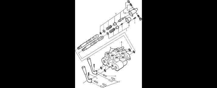

Ok, I would like to thank everyone for their help trouble shooting the valve. The issue is there no power beyond adapter installed so the out port and pb are sharing the same plumbing.
The valve manufacturer is out of business and I'm having trouble tracking down the fitting/adapter. So I may just end up replacing the whole valve. What do I need to look for when shopping for a new controller?
Or, is there a way to 't' the line into the FEL control that would basically select power for the loader control or the 3 point hitch? I could just plug the pb port on the loader control in this scenario...

Have you told us the manufacturer of the valve?
#1 Find a PB sleeve for your valve.
If you cant find a PB adapter for the valve, you can do this, but is not recommended as you will be using the OUT port as the downstream supply, and cyl fluid dump.
The OUT port normally has a pressure rating for about 500 psi. Back pressure from the 3pt could raise it to 2500 psi.
#2 Plug the the PB port with a short plug so as to let the main galleries and the cyl fluid exit the out port.
Then feed the remotes or 3pt using the OUT fluid from the FEL valve.
#3 option, replace the FEL valve with something like this.
This is a 10 GPM joystick valve with float.
Surplus Center - 2 SPOOL JOYSTICK BRAND LV22TSTKAB LOADER VALVE

   / FEL Control Question #29
Unfortunately mine doesn't have the PB port.
This is what mine looks like.
   / FEL Control Question #30
Your valve doesn't have load checks, you well not mess it.
