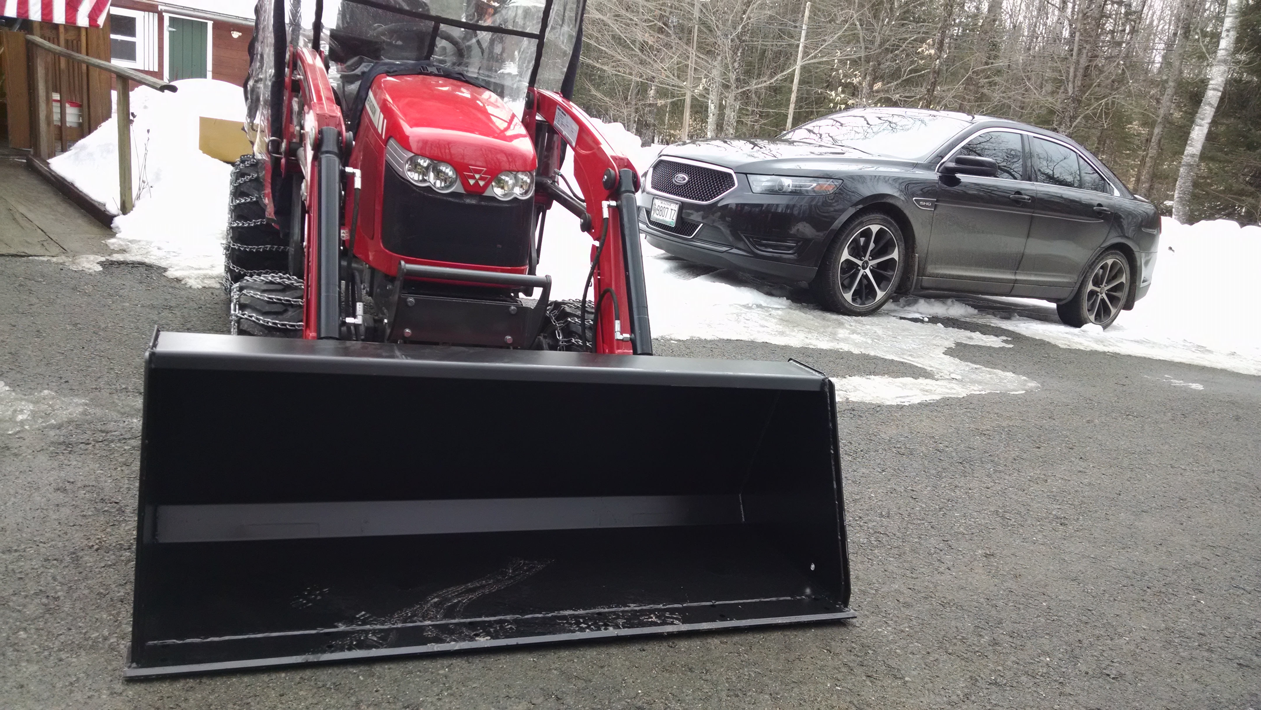

My suggestion is to get the 60" (I did) and immediately add a Piranha cutting bar. Without adding that bar you will pretty quickly bend the bucket down in the center of the cutting edge. That Piranha bar is a nice and thick chunk of steel that significantly reinforced the bucket. I did the Piranha bar also within a couple weeks of getting my B2650, I had already bent the bucket in that first couple weeks.
Once you get the bar added, go ahead and order up the BXPanded pressure kit and bump up your hydraulic pressure, I did this and bumped mine about 150 PSI over the max recommended pressure. This makes a huge difference in ability to lift, curl and dig. Once you do these things, your all set to dig or move things with plenty of hydraulic power and no fears of bending or deforming the bucket.
