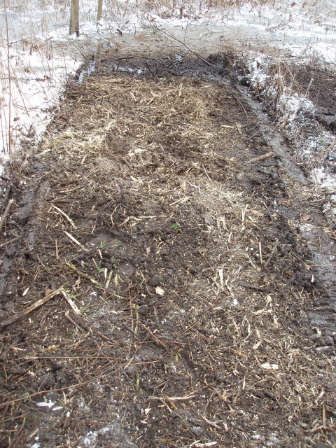

By the way, attached is the pictures of the results of the Carbide Cutter working a 6" diameter tree. As you can see there isn't much left. You can also see that I was working in really soft wet ground and the ASV's left no significant ruts.

   / Fecon Bullhog vs. Loftness Carbide Cutter Comparison #4
I think that is the first picture of the finished product I have seen, better than I thought it would be.
Thanks.
