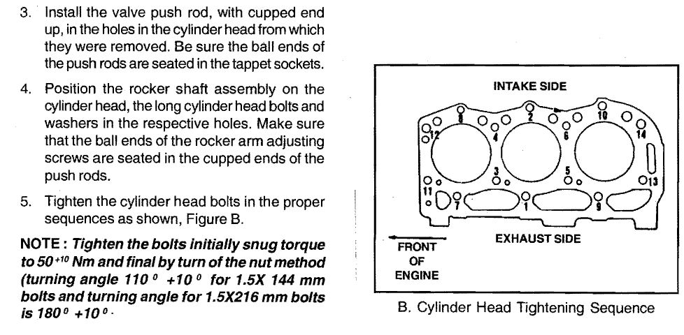

need head tightening sequence and torque for head bolts
   / Farmtrac 60 #2
I don't have the sequence for your specific machine but I'd assume it's like many others... Start at the middle and move outward in a circular spiral Patten.
   / Farmtrac 60 #3
Here's for the FT-70 which has the 3.3L. Looks like the FT-60 has the 3.1L, but this will give you some idea.
