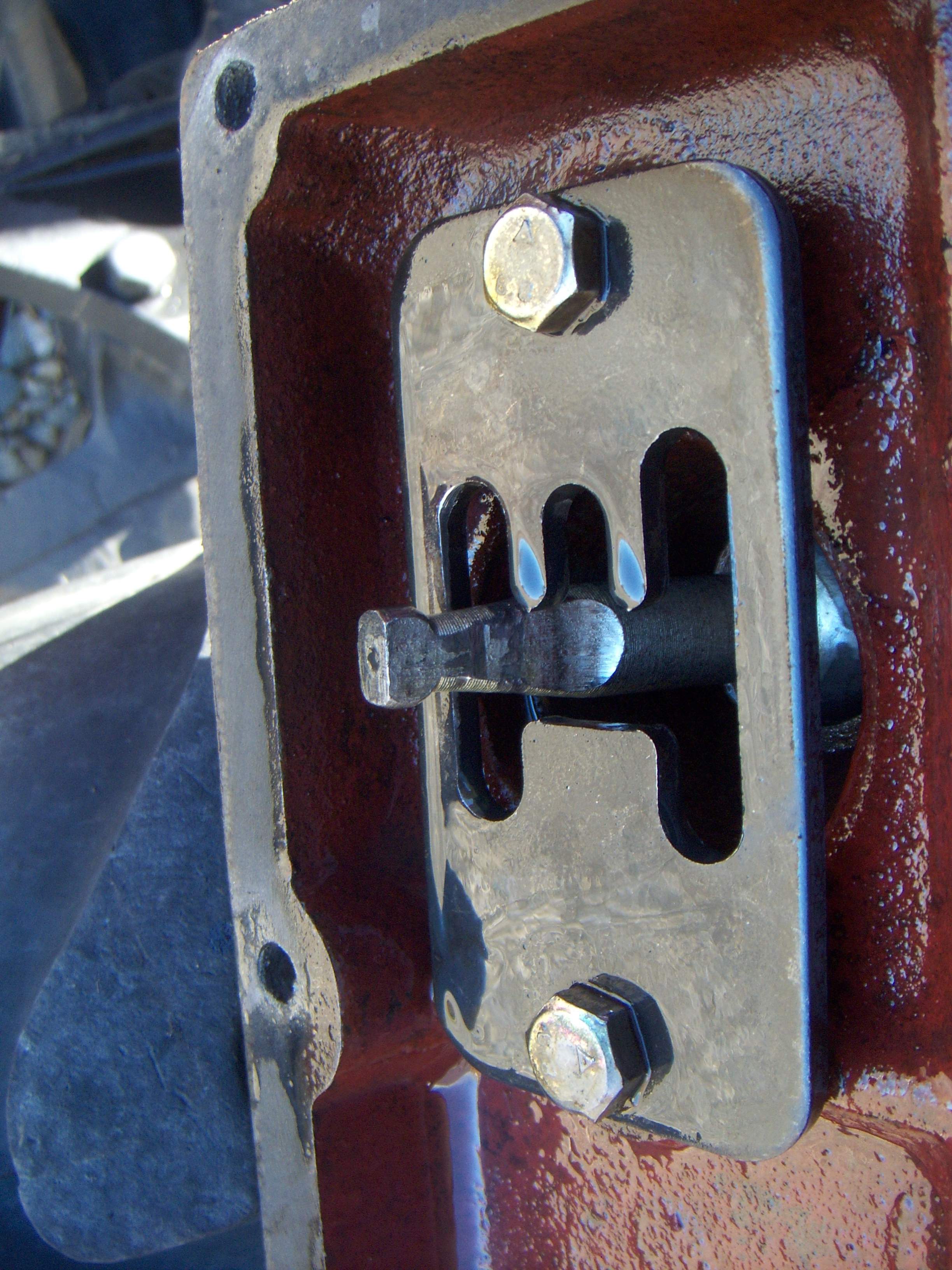

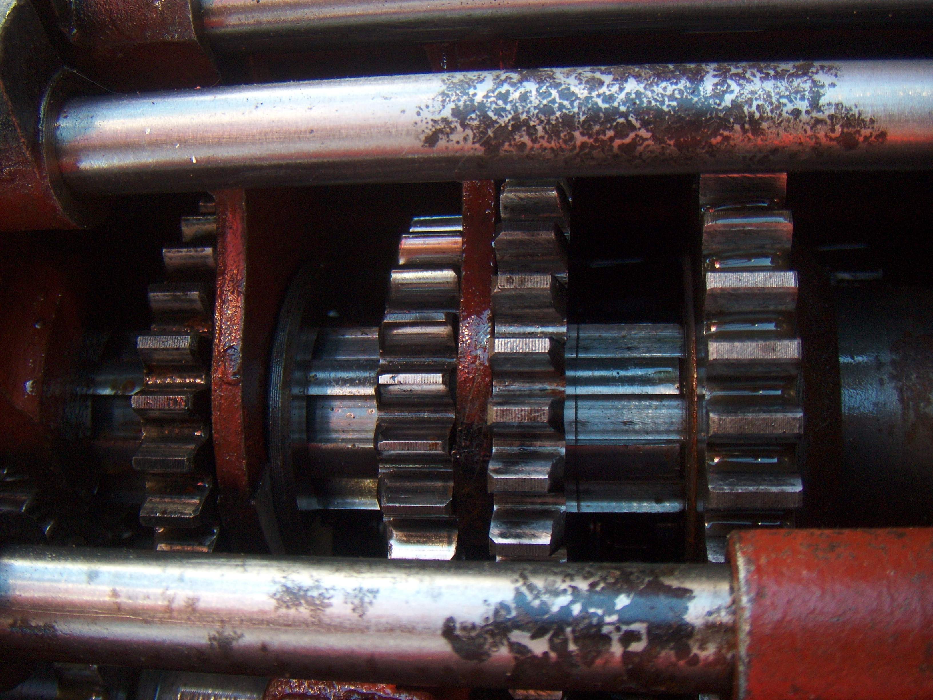

Well, Cover off today & I think my problem is low, very low, fluid. Nothing seems broke or out of place, I can not get either shifter fork to engage by hand.
Shift tubes do have a little discoloration but not too rusty, I am gonna try to post some pics
If shifter tube, gear, or fork is seized, how to remove ?
I assume that this tractor is combined transmission & rear axle fluid, as I could not find a drain for transmission only.
Is the drain at the center of the rear axle ?
Any input appreciated

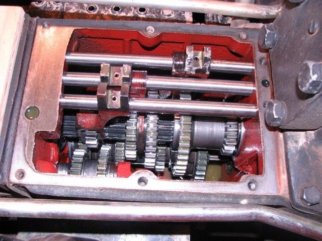

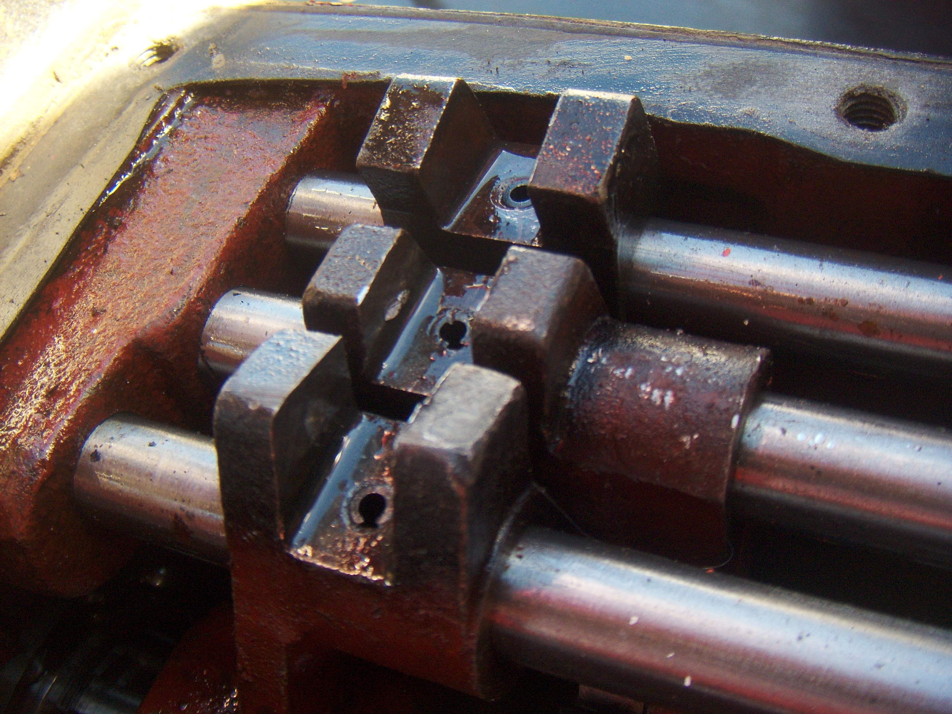

/ Farm Pro (Jinma) 2430 Gearbox Problem #10
David,
Are you saying that the 3 shift forks in the left picture cannot be moved? They are in an unusual position and when I saw them, I thought you had pushed them there. What gear was the gearshift lever in when you removed the cover?

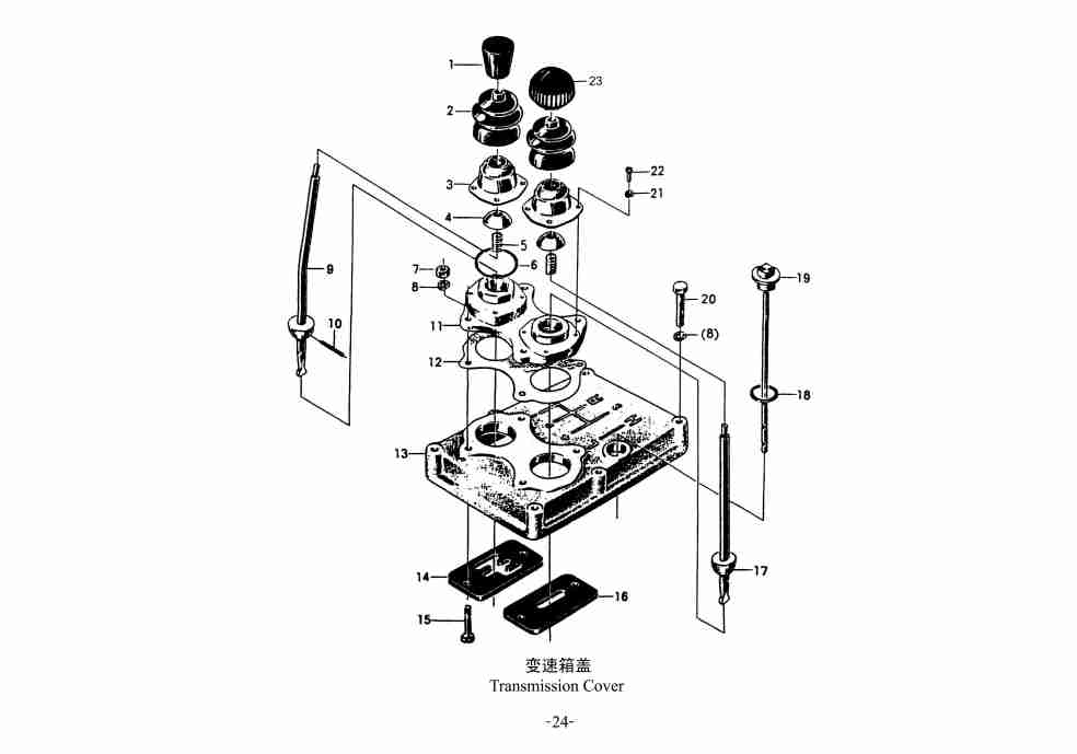

1st picture is shift forks in neutral. 2nd picture is exploded picture of tranny.

erj, is top tube/fork in your pic in neutral ?
My box has 4 tubes, the H/L tube is not in pic
In my pic the middle tube is 3rd gear only. I thought I had everything in neutral, but I will double check
There is no breakage anywhere that I can see, so I think that fork/gear is seized

/ Farm Pro (Jinma) 2430 Gearbox Problem #12
When in neutral the three blocks will be in alignment, yours are not, you run the risk of engaging two gears at the same time that will destroy the transmission.
Let the me mechanic fix it.

Thanks Winmac,
The picture with top tube & fork not in line is not my gearbox, that is "erj" gearbox
My gearbox is pictured in prior thread, & they are inline

/ Farm Pro (Jinma) 2430 Gearbox Problem #14
That (erj) diagram is of the wrong transmission. Here's one that's more representative of the 300 series Jinma.
and the transmission cover
Photos of the problem tranny show clear evidence of long term exposure to wet gear oil. How long have you owned this tractor?

Thanks greg_g
Your diagram is my transmission, with exception of different gear location.
My 3rd gear is by itself where reverse is in the schematic you sent
The picture erj posted looks like failure/breakage of the block,groove that shifter end goes in on the upper tube.
I drained gear oil, & it does have a very liittle yellowish tint to it, but there was not but about 3.2 gal fluid in it.
There is a little rusty stain on the tubes, but none on gears or inside wall of box
I did remove the roll pins & moved forks back & forth & all seems fine
I don't think tubes can be removed unless broke apart, as I could not get them to move back enough to remove.
Will flush gearbox with kerosene & put back together

/ Farm Pro (Jinma) 2430 Gearbox Problem #16
Sorry for confusing the issue. When I saw the 3 tubes in David’s picture, I thought that it was the same transmission as my 284. In my picture, the top tube is the Hi/Lo shifter and is in the Hi position. The middle tube is for 2nd and 3rd gears and the bottom tube is for 1st and Reverse.
