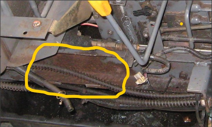

I have now cleaned out what was hidden in-behind the original battery tray due to built up grass clippings having being siting there for few years.

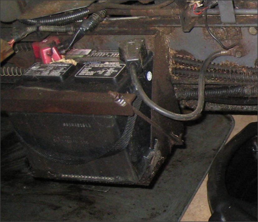

Here is how the factory battery tray looked like before unbolting it and cutting out the welded in to the tractor frame mounting plate!
This is what was hidden behind the welded in steel plate:

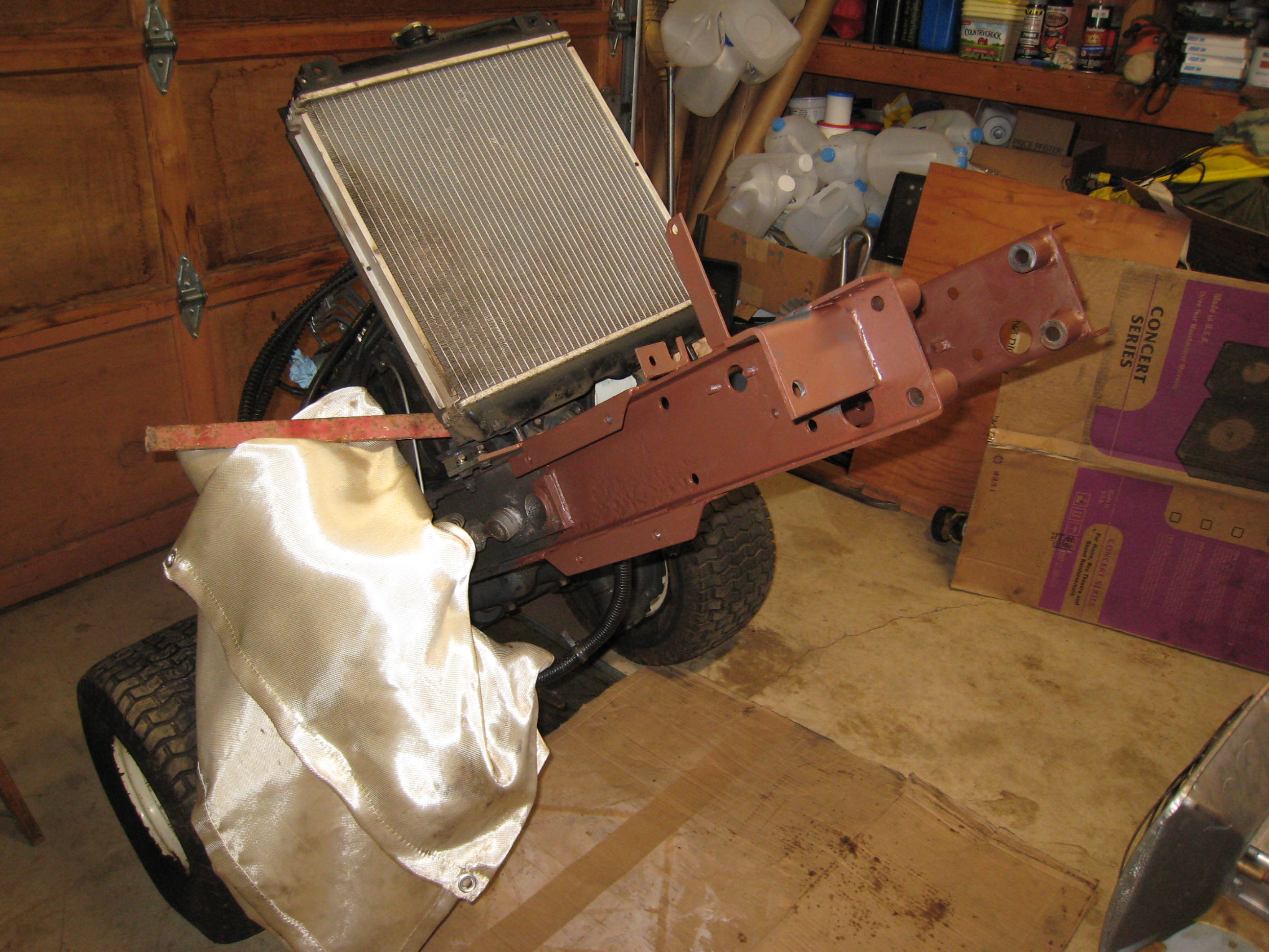

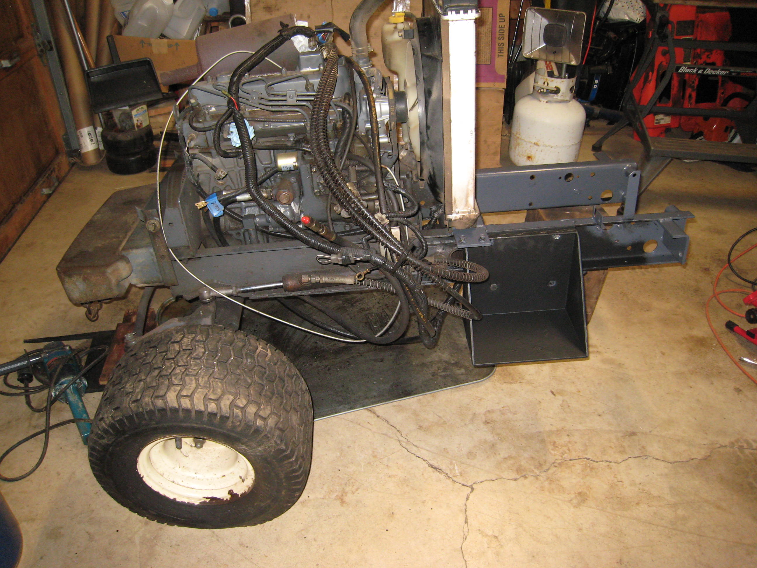

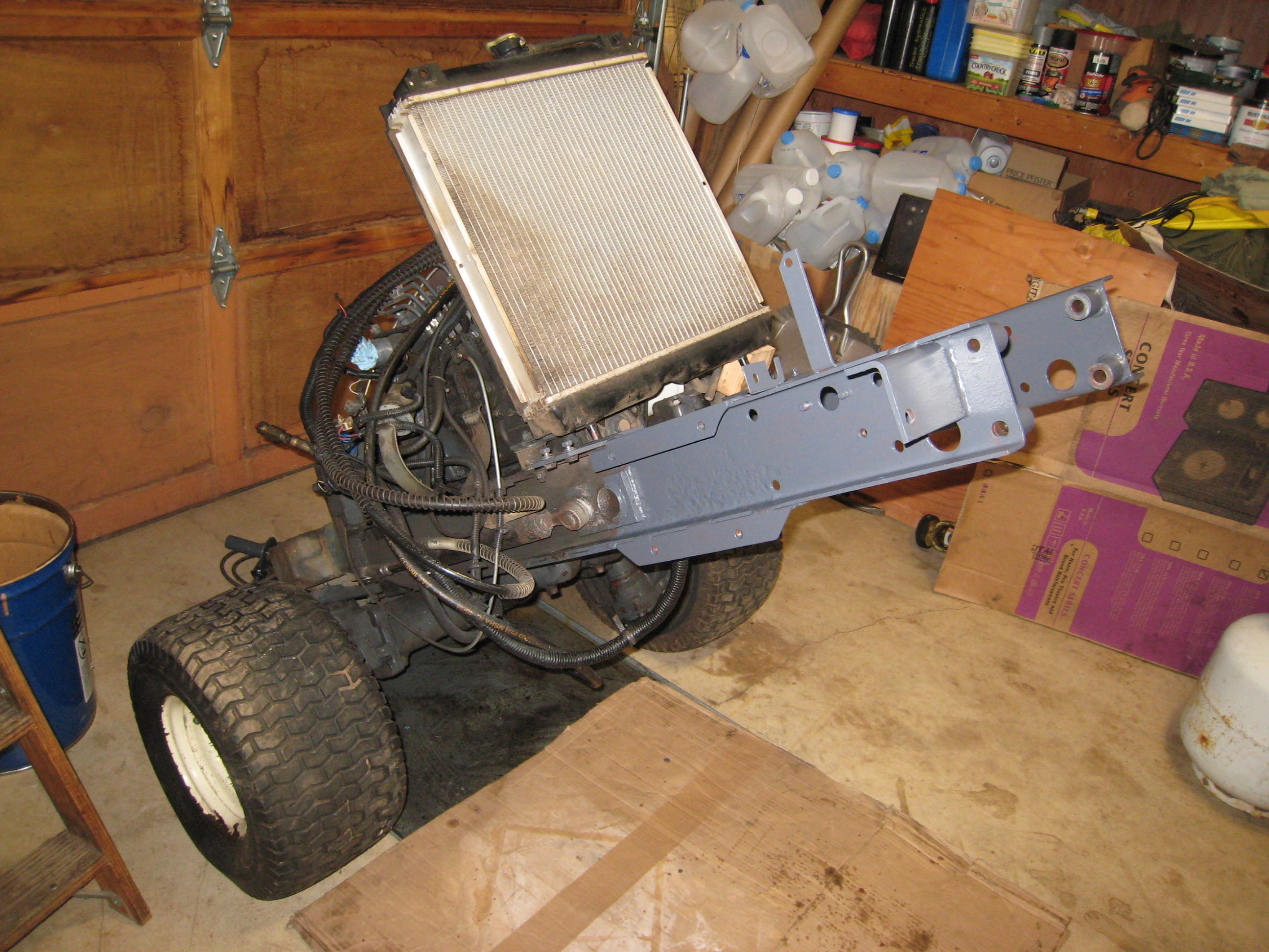

After cleaning out loose rust, treatment with Rust Mort rust converter, one coat of primary and two coats of gray, followed by truck bed protector coating, the new battery tray attachments look like this:

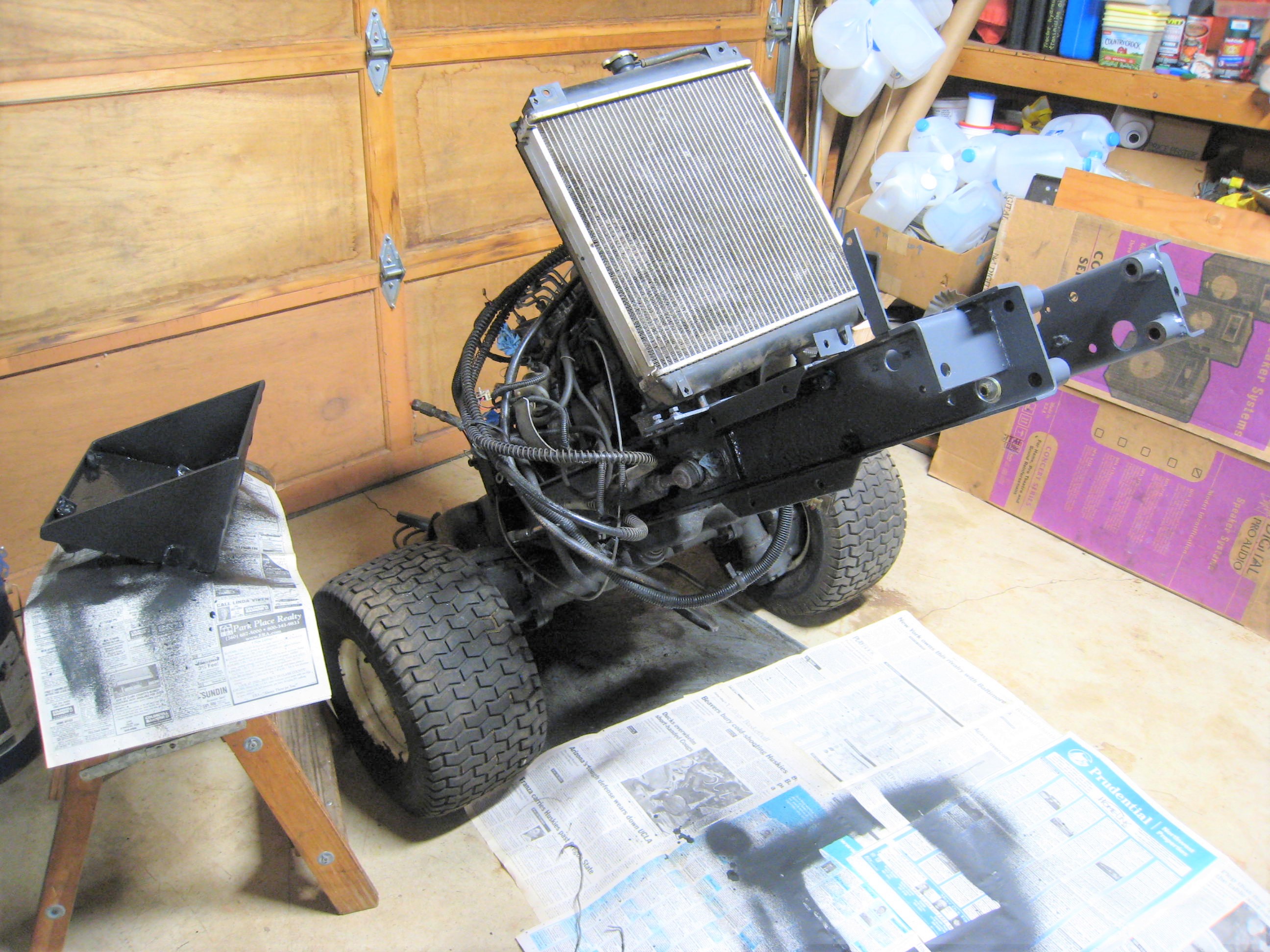

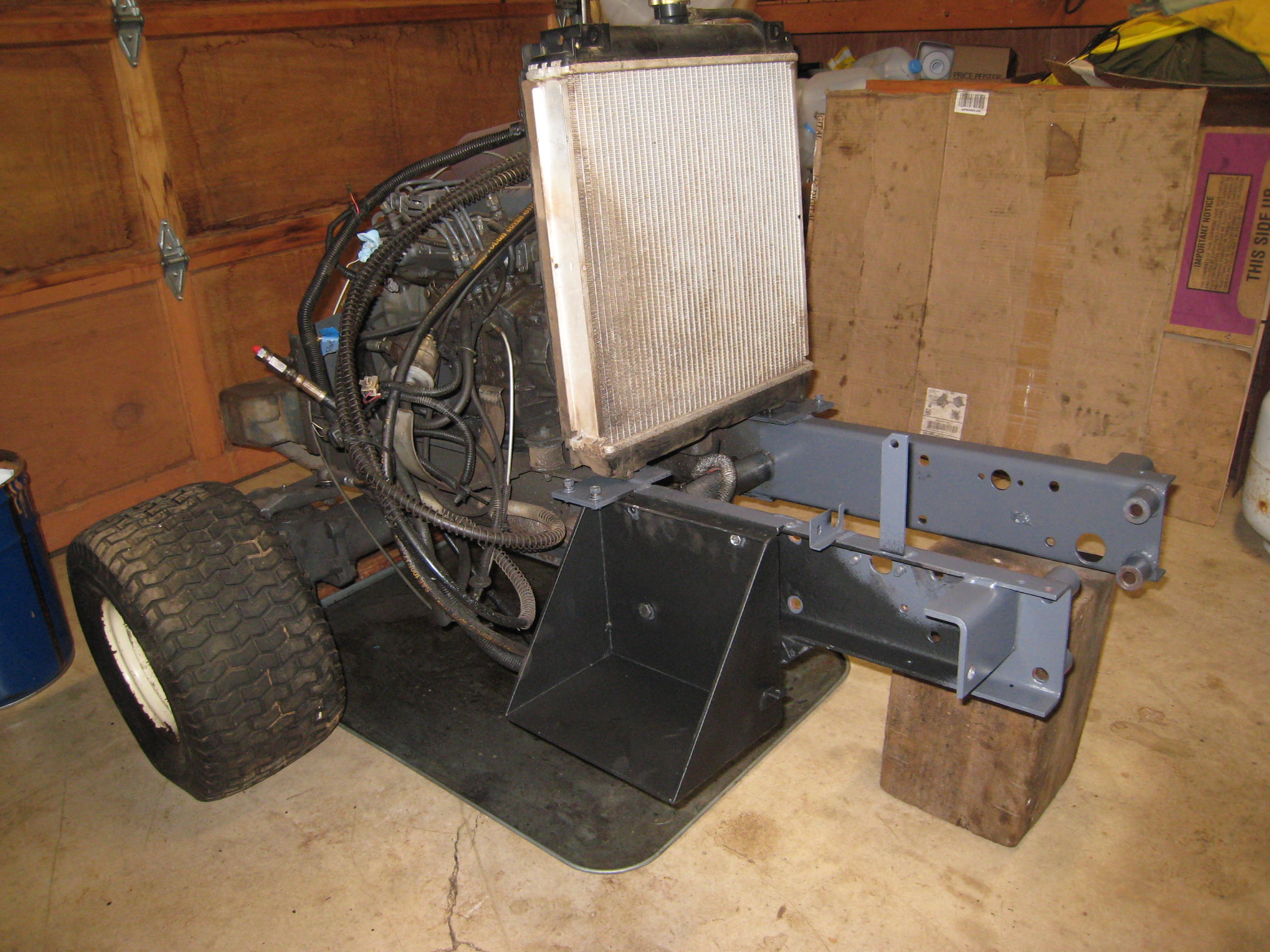

New battery tray:

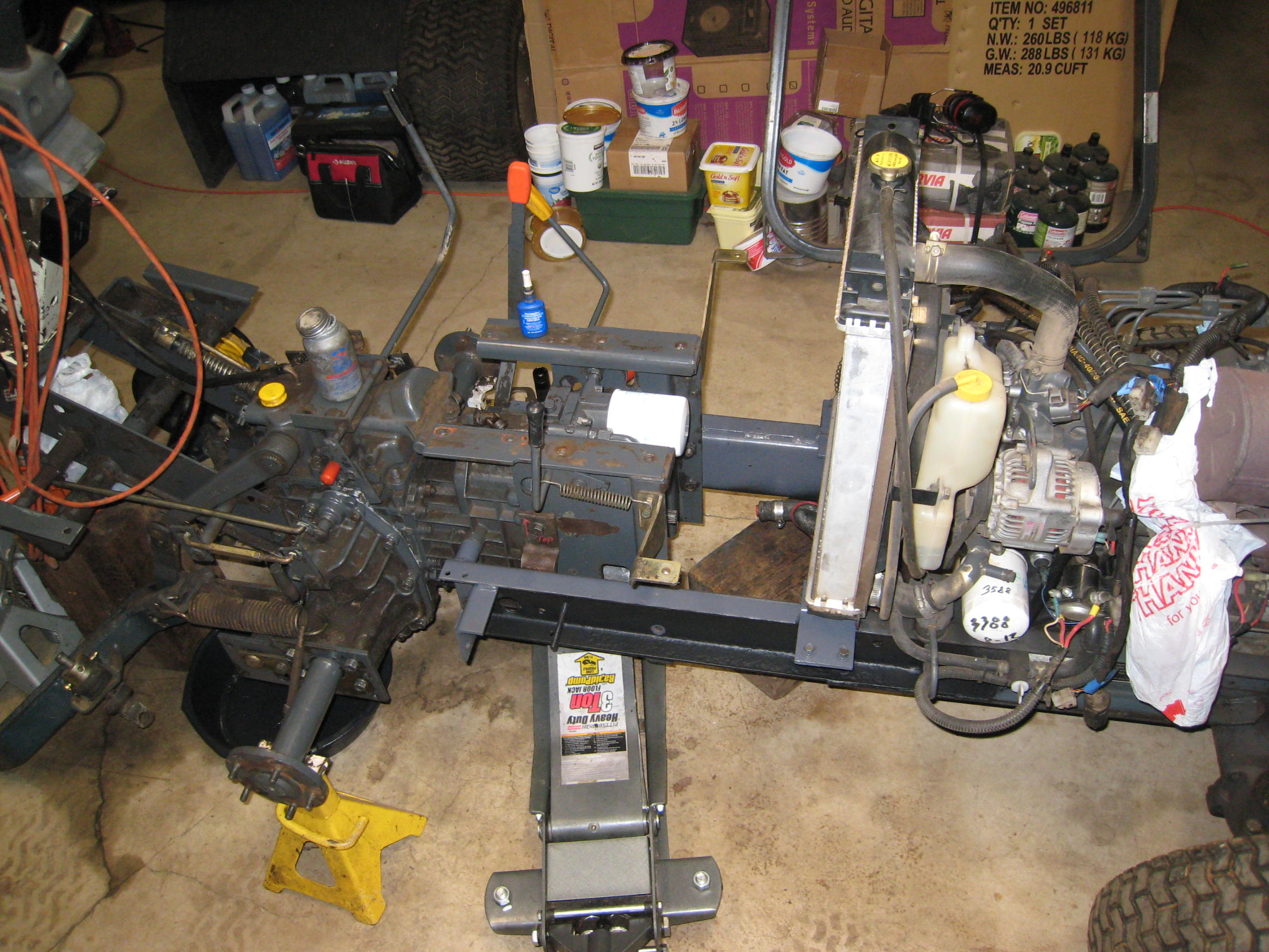

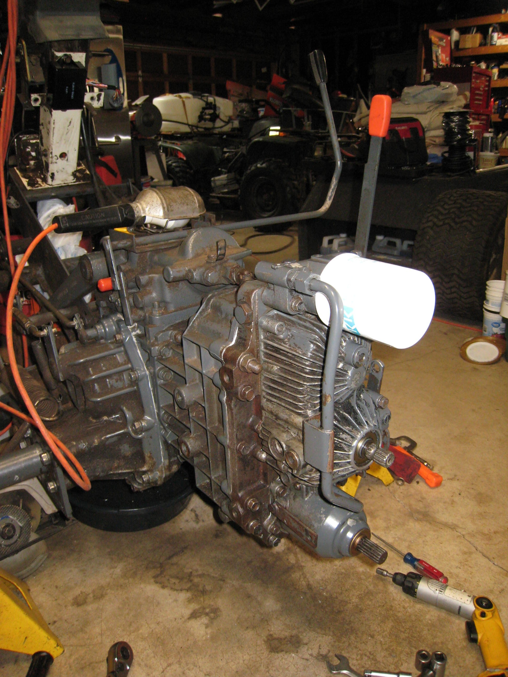

It was fair bit of work and now it's time to start reassembling the hydro-static transmission with all new seals and new swash plate cradle bearings.

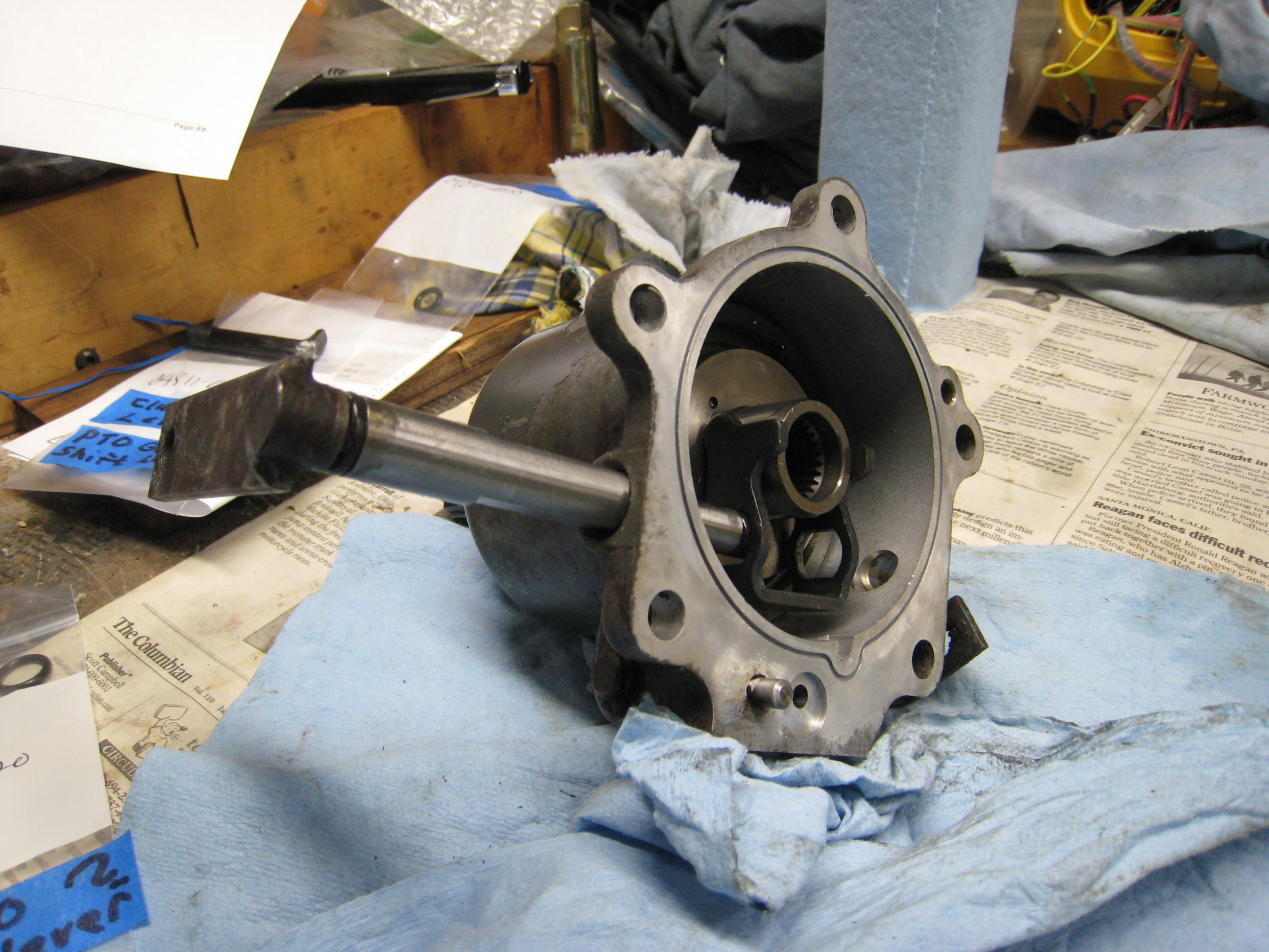

Update:

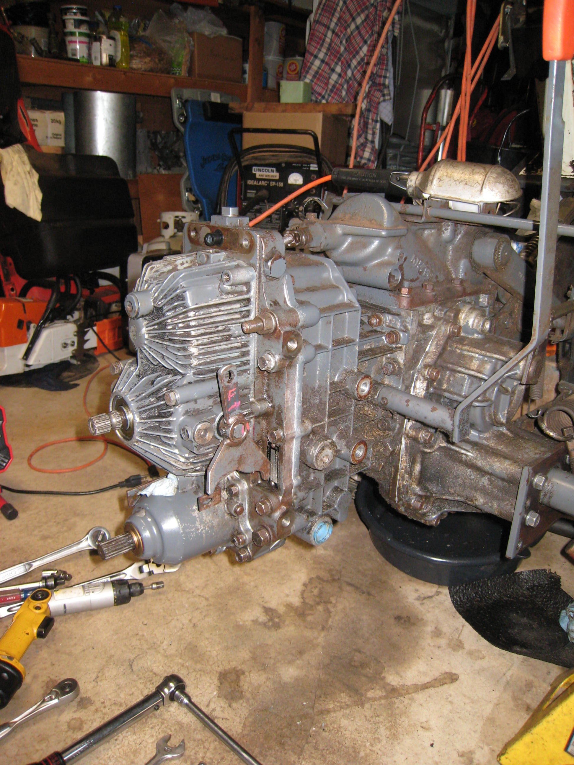

The HST is all back together with all new seals and the mower frame is bolted together!
Some of the shaft oil seals had shrunken just slightly in their outside diameter, causing them to be just a little loose in their housing, which explains some of the HST oil leaks.
There were also worn O-ring seals in the 4 wheel drive clutch lock lever & PTO shift levers causing small leaks, which could be corrected only by taking it apart.
There is lot of work involved in details and I think this type of inspection / overhaul should only be attempted by someone willing to do the homework.
Kubota WSM is certainly helpful & pretty well must have, but it does not cover even close to everything!
