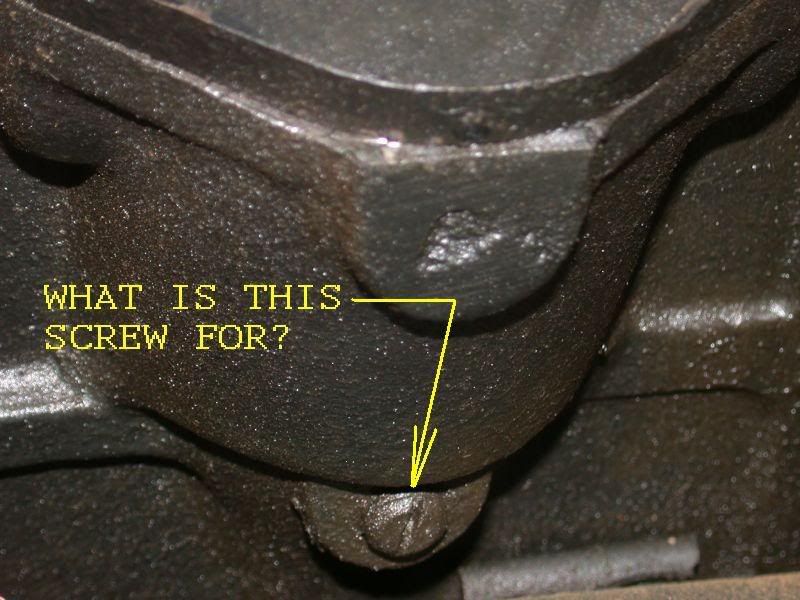

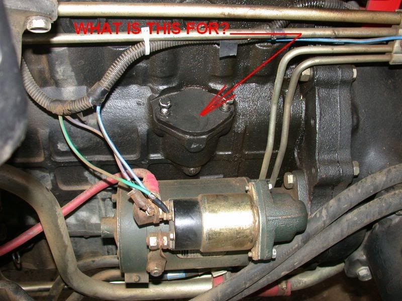

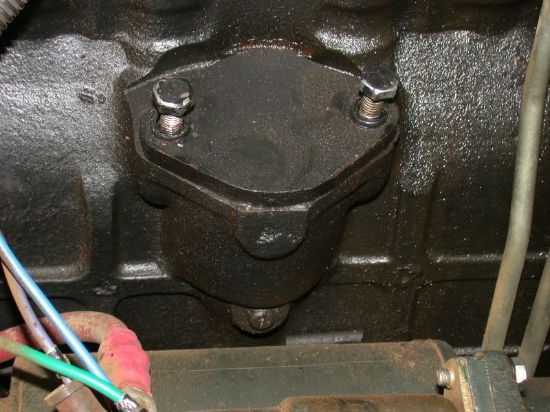

They are looking at the left side of the engine where the starter motor is. I want to know what that is, what does it do?
I took the 2 bolts off to remove the cover, but I think it must have a shank or something in it because the cover did not just pop off. Is the cap attached to something? See that screw in the 3rd photo, do I need to loosen it first to take the cap off? I stopped since there is nothing in my manual about it and I don't know what it's for. The starter is in the way of that set screw.
I was thinking of drilling a hole in that cover to add a crankcase vent like on the Jinma if it goes to the crankcase. I can take the starter off to get to the set screw, but I'd like to know what that unit is, first.

Pretty sure your photos are of the cover plate over the (optional) air compressor mounting location. Presumably that lower screw is related. Very good chance it's a set screw as you suspect.
About the blowby - first SWAG is one or more valve guide seals. But first - how old is the oil, when was the last time you had the valve cover off, and exactly where does the valve cover get "oily when it's been running for a long time"?

Under that mistery cover is a gear that runs on the camshaft and drives the oil pump. the screw at the bottom is a plug into an oil galley.
I don't know of any blocked off breather plug... the breather is in the oil fill cap.

OK Chip,
Thanks for getting that information on the "mystery" cover. I guess I won't be going into that then.
