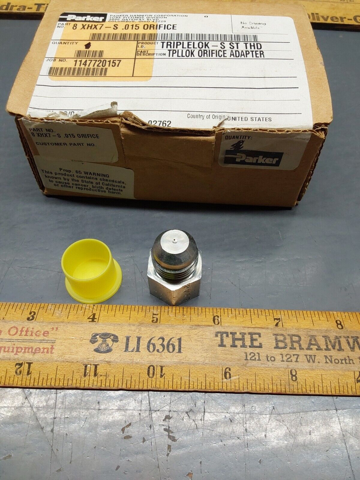

I have an old Case DH4B trencher/excavator combo. Finally got the excavator up and running with the controls in the two joystick SAE configuration. When I run it, the boom drops FAST. Barely move the stick and she slams down. The left and right control is not quite as bad, but it is too fast. When I swapped out the old 6 stick valve for the twin joysticks, I could see screw in orifices in a few of the ports. They had pretty small holes and they were threaded in somehow. I couldn't get them out with a big flathead, they had a slot in them. Is there anything like that I can add to the current control valve to slow the cylinders down like the orifices? They looked just like sprayer orifices.

Will this work?

Likely the orifices you saw were orifice checks that were port options in the valve. The checks allowed free flow in one direction, restricted flow in the other.
Most circuits using orifices are typically installed to allow exhaust metering, especially on circuits that gravity can affect, like your boom down. By restricting the exhaust, there is back pressure in the cylinder to prevent it from running ahead of pump flow.
Parker did make a fitting that had an orifice check that was part of the fitting. It was available as a check and a number of sizes. I don’t know if those are available in the consumer market. Maybe contact a Parker parts store.
The adjustable flow restrictor is a good option, you can have free flow one direction, restricted flow the other. They don’t have to be at the valve, you can install them at the cylinder ports or in-line if needed.

What is the GPM of the machine and what was the GPM rating of the valve?
Sounds like the valve was too big. It comes up often on here but you want to try and match the rating of th valve as close as you can with the flow of the machine. If you have a machine that runs at 8gpm and put a 25gpm valve on it you loose the ability to feather the controls.
Its like trying to control a garden hose sized stream of water with a fire hose nozzle. Barley crack the nozzle and you are already at full garden hose flow....
