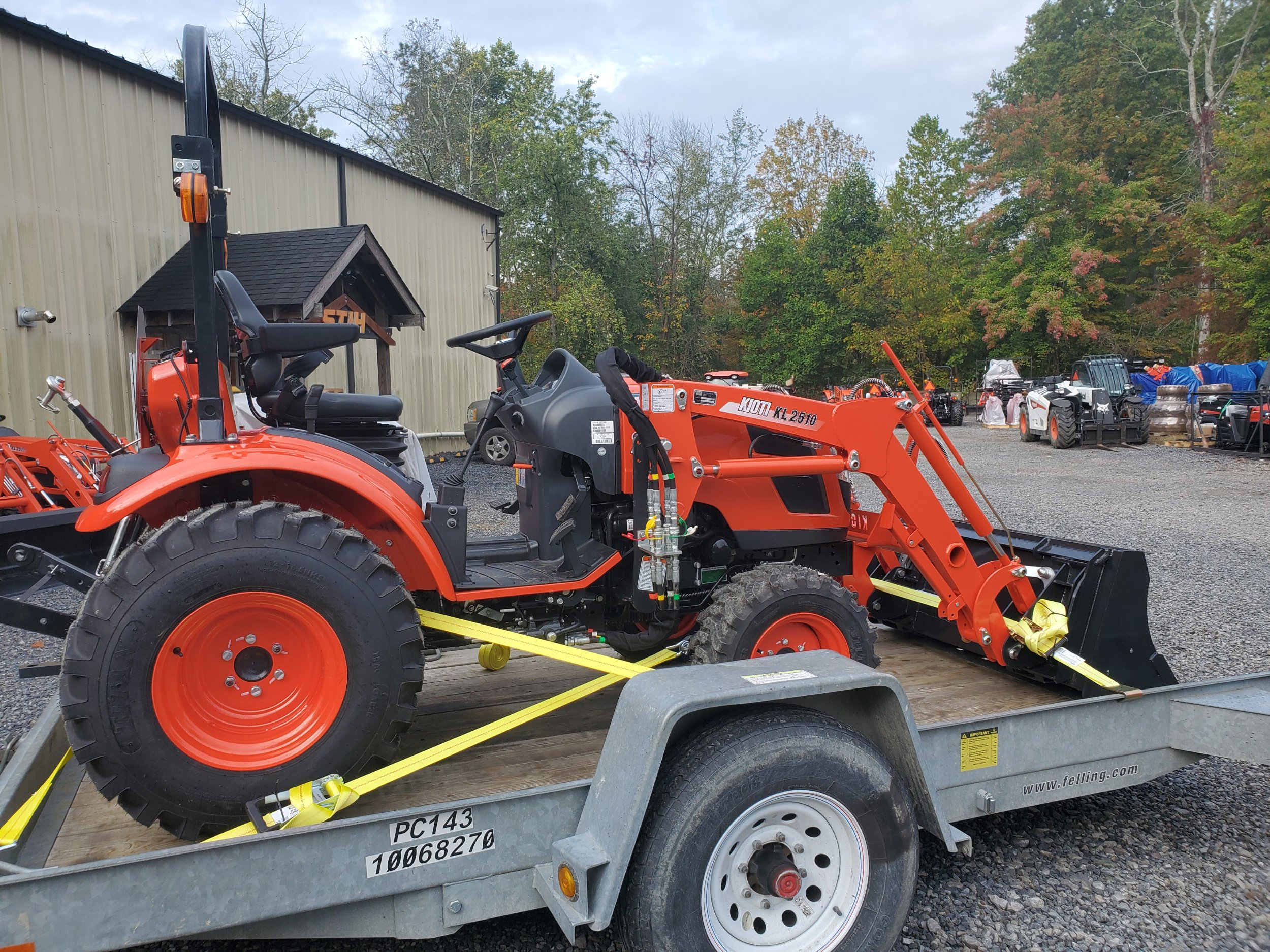

I rented a single axle tilt bed trailer from Sunbelt and took a Kioti cx2510 from New Jersey to Cincinnati with my F150. 7000# GVW. Tracked and towed great.
