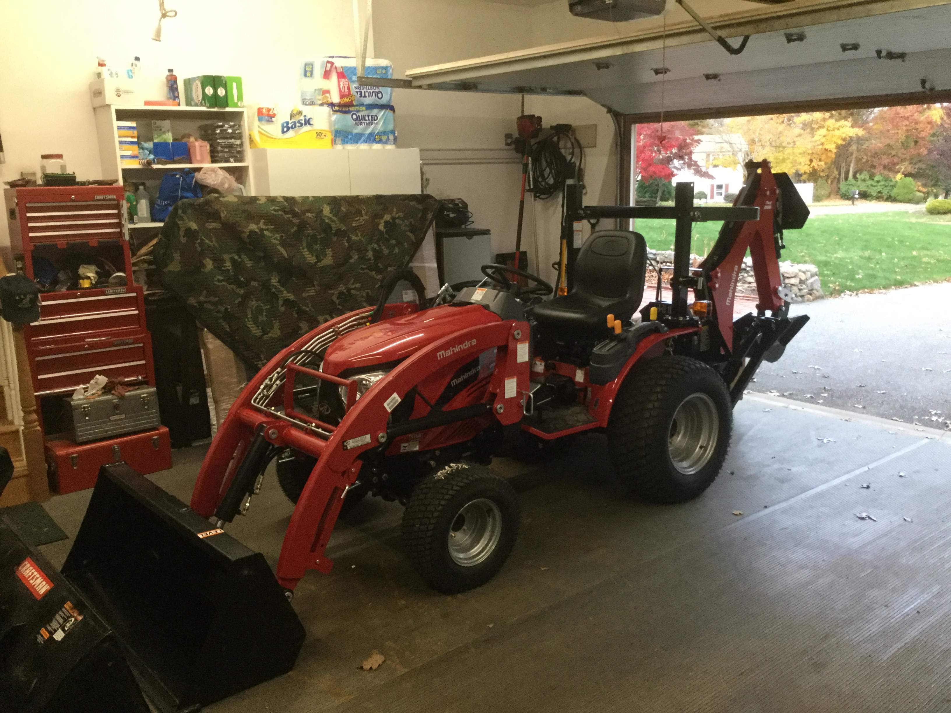

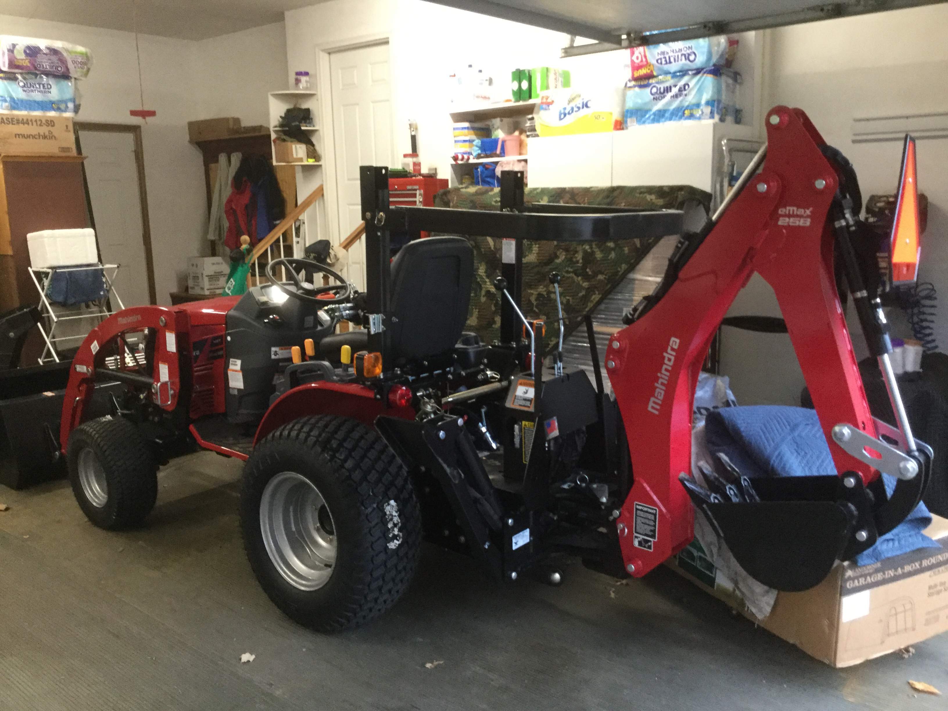

I have the Mahindra emax22 with backhoe and loader. So far it's a good machine.

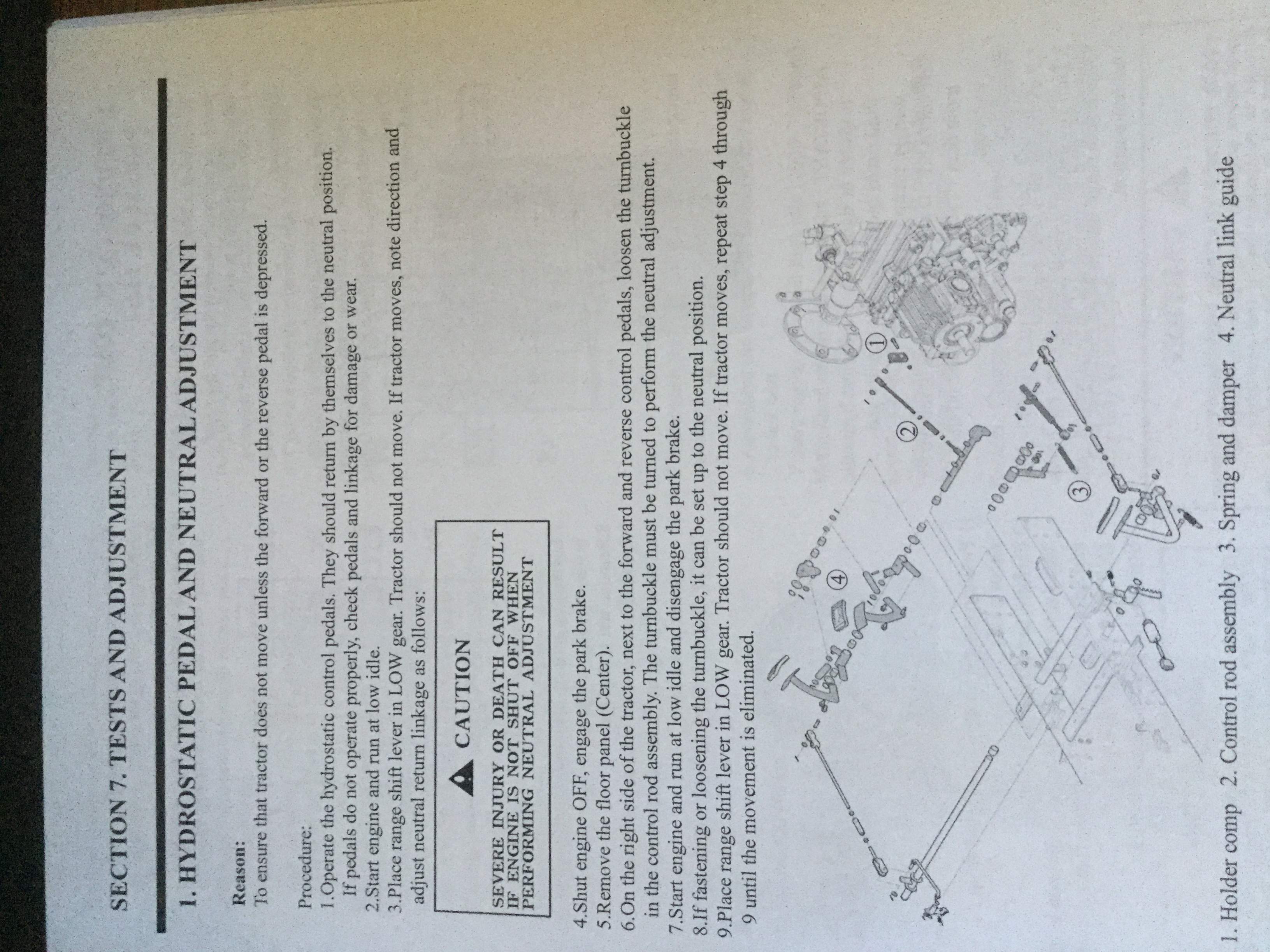

I have read complaints about the HST units going in reverse while they were in neutral on another site. I can't say as I have experienced it yet with mine. I know one of my Craftsman garden tractors does it.
Do you have the service manual? If you do you could try adjusting it.

I don't have an emax.I was just curious. I heard some scuttlebutt that the emaxs were having problems with the neutral adj. This was supposed to be an issue with units equipped with backhoes.Seems the frames were twisting under heavy use.
   / eMax 22/25 info? #128
They have a kit to fix the creeping, not sure if the word is out yet. It involves some shouldered bolts that fit the frame holes precisely to keep flex down, and I think a different neutral valve. Anybody with this issue might want to contact their dealer who would then contact the service rep and see if these are available yet. If not, soon. And new TLB's coming out of the DC's have this improvement. All the little SCUTS with a ladder frame have some flex, that isn't a problem. Managing the flex is key, it needs to not cause issues with any of the systems.
