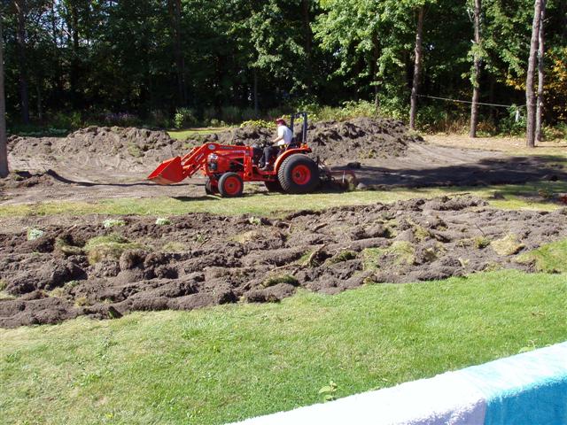

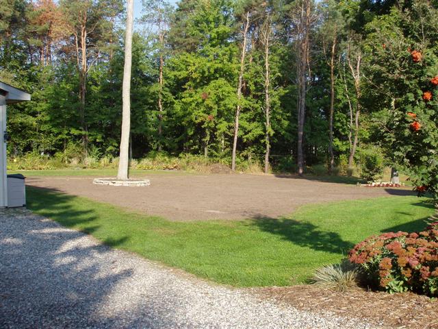

I think the best tool you have for this job is the BH. You can loosen the dirt first and then use the BB and FEL to move it farther up the hill. Once the dirt is loosened up the whole job will go much faster. I have used my 2 bottom plow to loosen up areas I wanted to level out. It saves a lot of the brute force needed to reshape hard ground or sod. My pictures show me plowing and piling up the loose dirt and sod. I then pushed it back where I wanted it and worked it level with just the FEL and a RB. This helped separate out the sod which I had to hand rake out. That took some time but you can see my results in the second picture after it was replanted to grass.

   / Easing Rise Methods #26
Been there, done that. Start at the top, back from the edge, at the point you want the slope to start. Using your FEL follow your dotted line, not the existing slope as you work down the incline. Go forward (down the hill) until you get a bucket full. Back up and dump where you want. If you have trouble backing out, your dotted line is too steep to work later anyway. After the first couple of bites, you'll be cutting into a basically vertical wall. Makes it easy to get a full bucket and you can't slide down the "slippery slope". Obviously, teeth on the bucket will help and will increase the bucket carrying capacity as well.
There are a couple of additional advantages: The biggest volume of dirt will be near the top. That makes for a fairly short trip (in and out) for the largest volume. The downward slope lets Old Dad Gravity help you load the bucket.
