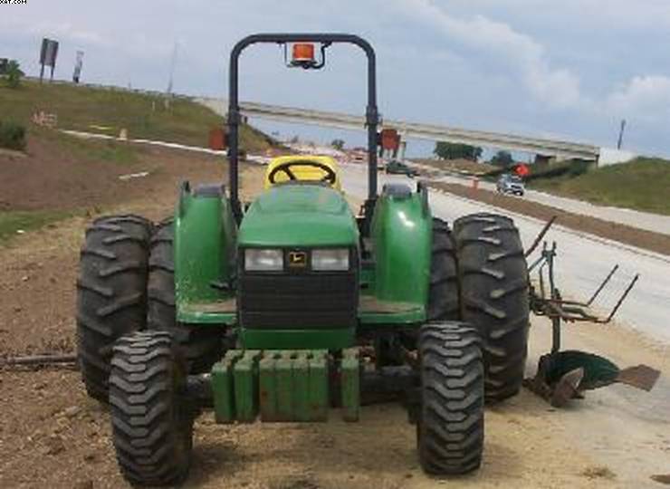

Here is a JD that someone posted a while back.
   / Duals #4
Interesting, R4's in the front and R1's in the back!
   / Duals #5
On the JD--a nice addition to the ROPS for seriously tilted sidehills. Makes me wonder if it was converted for stability, traction, or both? And does anyone load duals on a CUT?
