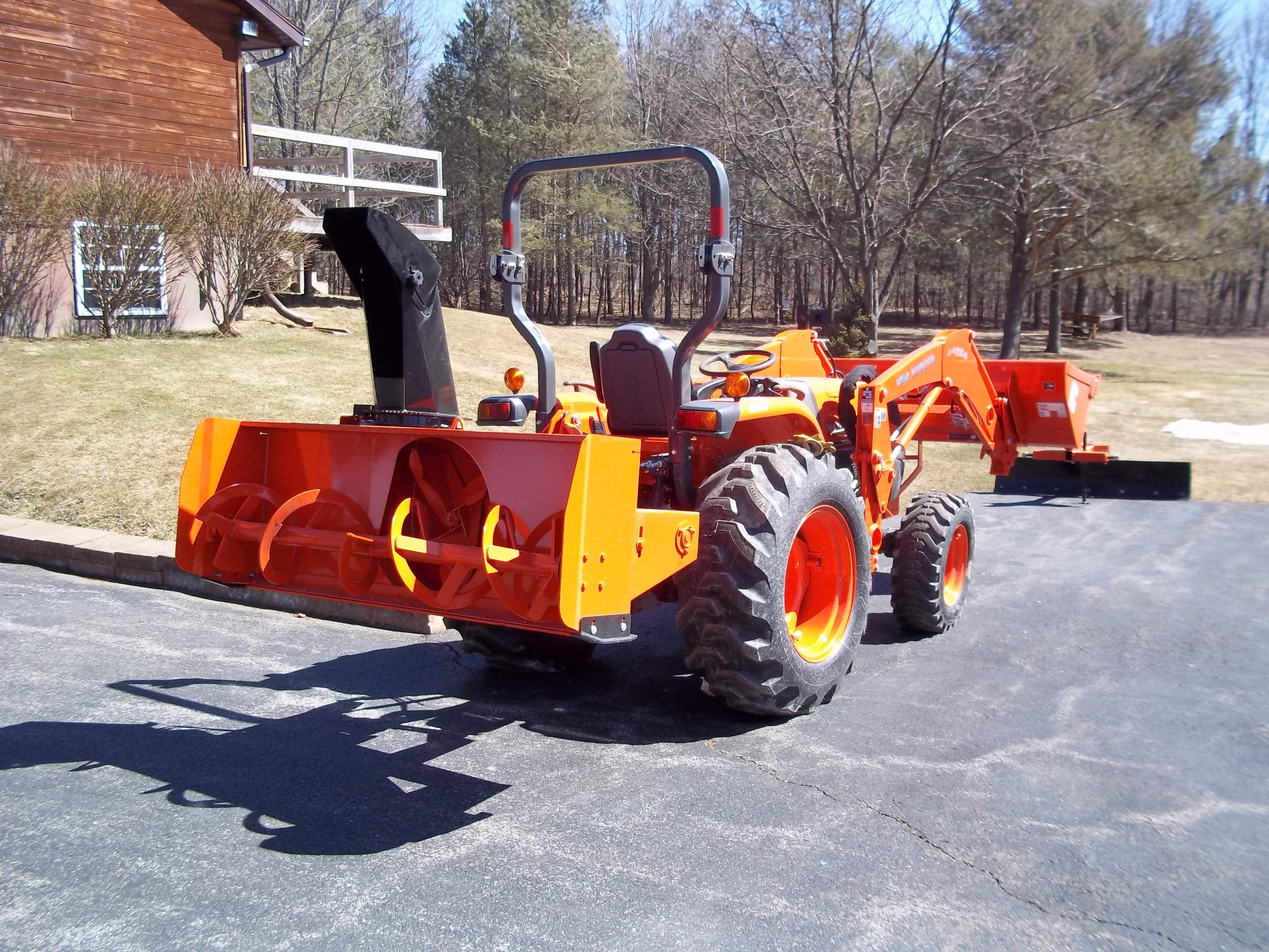

I have a B2782A snowblower on my B3030HSDC that is waiting patiently in the garage for first snow! Unlike its owner. While I stew, it occurred to me that my walk behind blower has a drift breaker but I've not seen any on any Kubota blowers. Are they not needed? I don't think it should be too hard to conjure up a design, but if you've made one already, would you share the details?

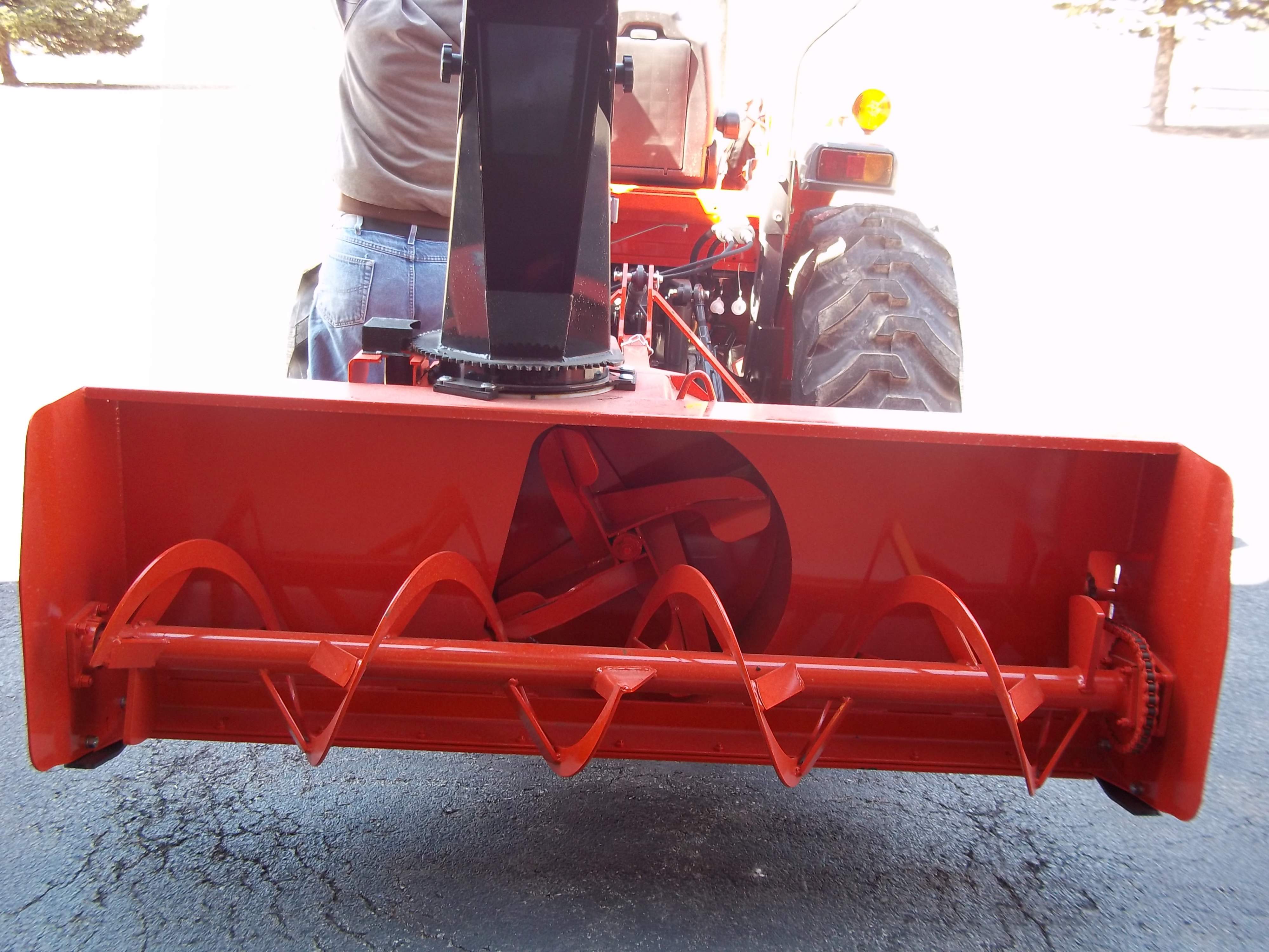

Thanks,
N. Fowler
The LA 2674 Kubota snow blowers actually have them built into the blower. Look close at picture and you can see that on each side the edges or bow out about two inches, Is that what you mean?
DevilDog
I may have misspoken. I was referring to the vertical knife-like blades attached to one or both sides (ends?) of the blower housing that cut the overhang off when the snow depth is greater than the height of the blower housing. They are common on walk behind blowers and a boon when dealing with drifts or plow berms. Rare to see them on Kubota snowblowers although Deere blowers may have them as standard equip.
