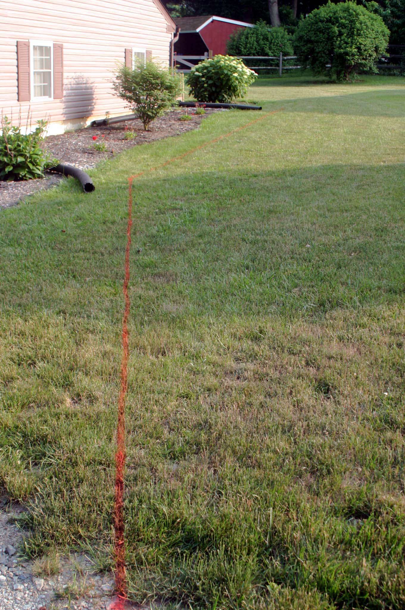

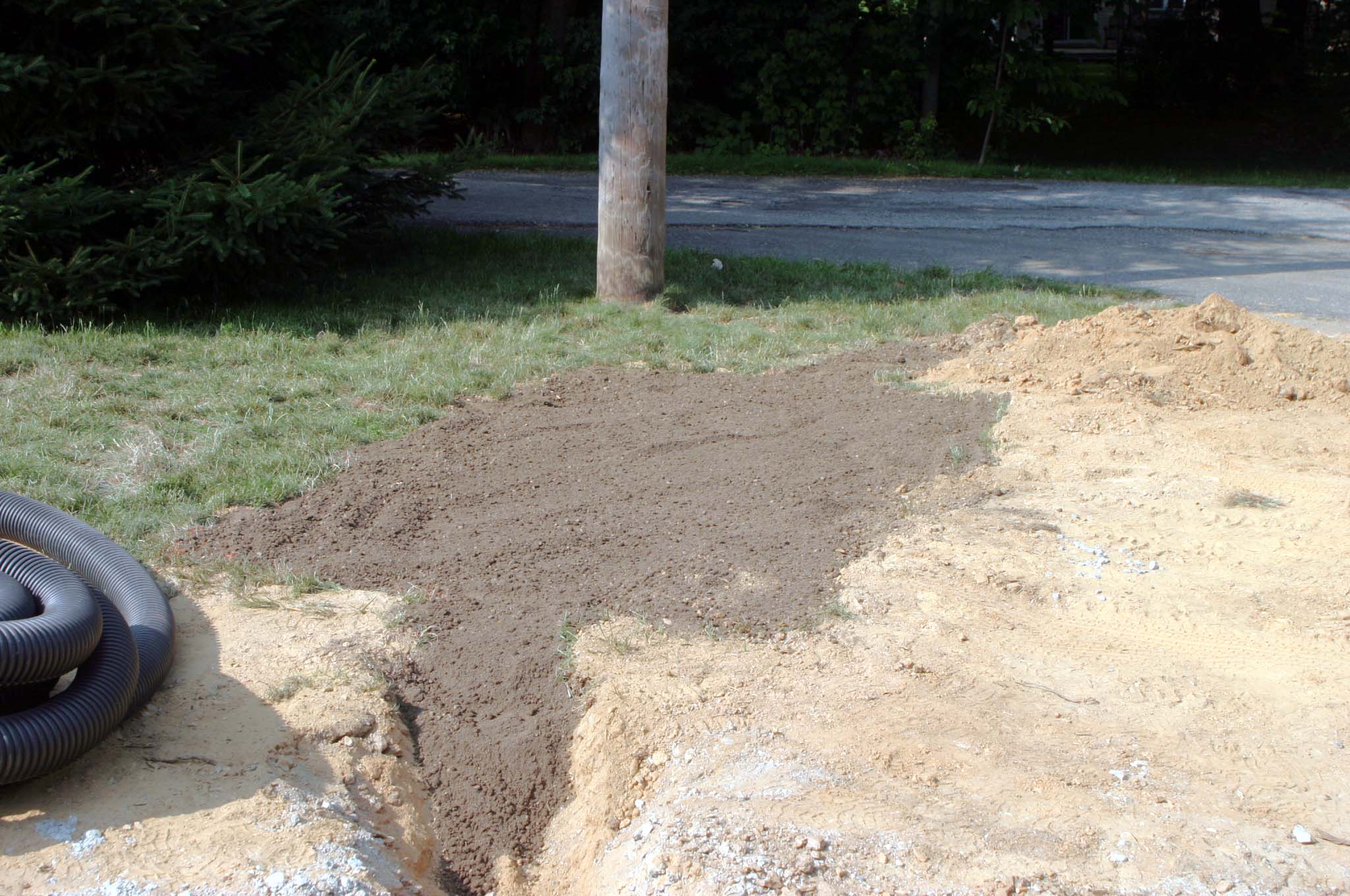

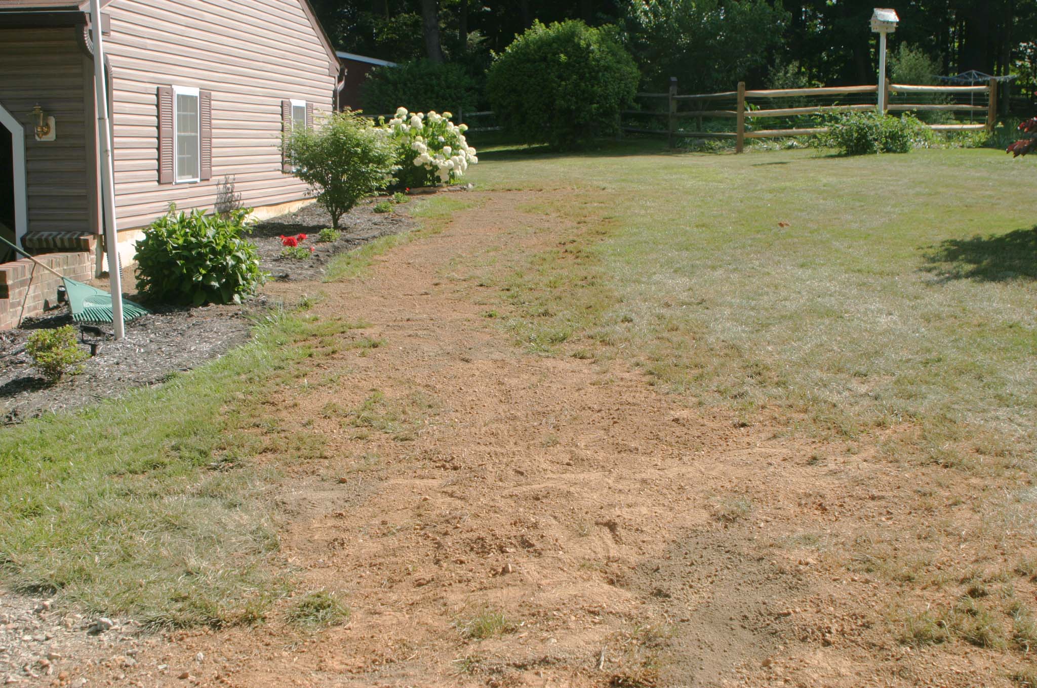

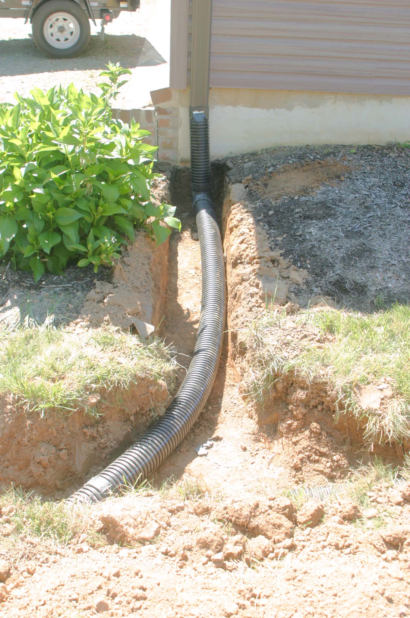

My BX24 came thru again. I wanted to share some pics of a project I did over Father's Day weekend finishing today. It took me 5 days. Worked alone. I dug a pit for my water Retention Chamber by Storm Tech. I decided to use a chamber after researching all available ideas and also to handle any driveay runoff if a low spot is in finished drive at a later date. Tight elevations don't allow me to go to many directions with runnoff on the one end of the house or the with the finished drive surface.
Pit dimensions were 9 ft long, 6 ft wide and 5.5ft deep. It was at the limit of my BX24 as far as getting a clean flat bottom...but it did it . I cleaned it up with hand work but very little. I took 10 tons of dirt out of hole with the hoe. I put 8 tons of rock in the hole. I wrapped the entire pit in non woven Geo Textile. Prior to any back fill, entire chamber and rock were lapped and completed sandwiched in the textile. I then dug an 81 ft trench to tie in the downspouts on end of house. I also put in a short section of pipe in the chamber, other end, ready to be used to put a drain in a new asphalt driveway I will have put in later. This is in the event I have a low spot that will result. I can then drain the water into the chamber. I thought better do it now as it would be to late later.
The chamber has 1 ft of rock beneath it and 6 inch all the way around sides and top. This allowed for 24 inch of dirt on top of stone, spec for weight requirements of a vehicle that could rut on ground above the chamber without pavement. Total capacity volume for water is 700 gals. Hope we never need that much but I made it large enough for who knows what....
I placed the chamber in the hole by making a sling of rope thru the chamber and hooked to my FEL bucket hooks leaving slack enough to lower it in the hole. Worked nicely.
Project went well and even with three days of 91 degree heat both me and the tractor held out. I am very pleased with my Kubota as without it the project would never have gotten done. Ground was like rock, dry clay beneath 6 inches but the hoe cut right thru it. All we need now is some Rain!:)

? - does the pipe from the gutters have holes in it, so it's also acting like a french drain as well as a gutter pipe? I need to do something similar and wasn't sure about the correct method.

The pipe is solid with no holes. It was not meant for french drain. You could use that pipe if you intend the dual purpose.
