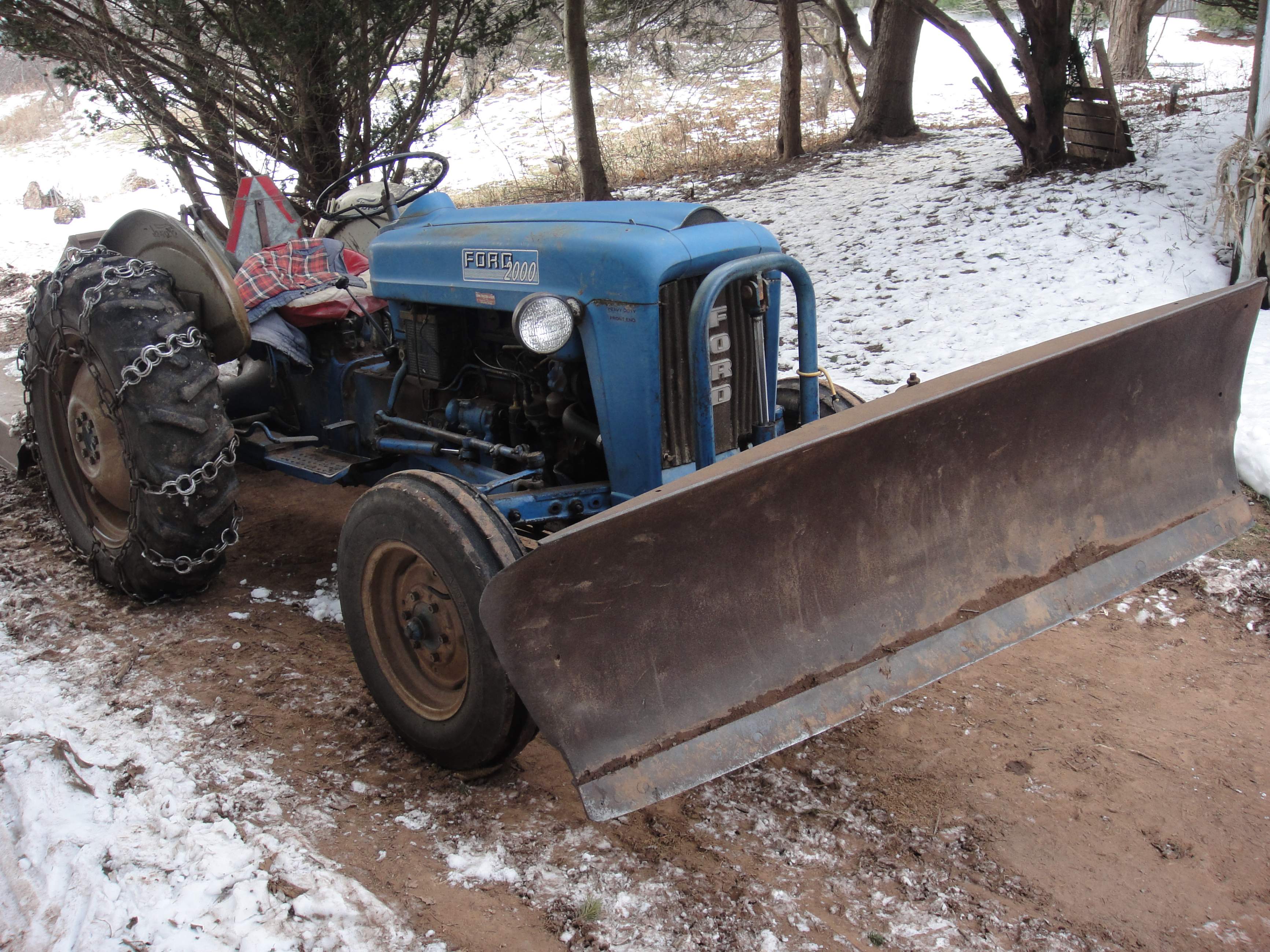

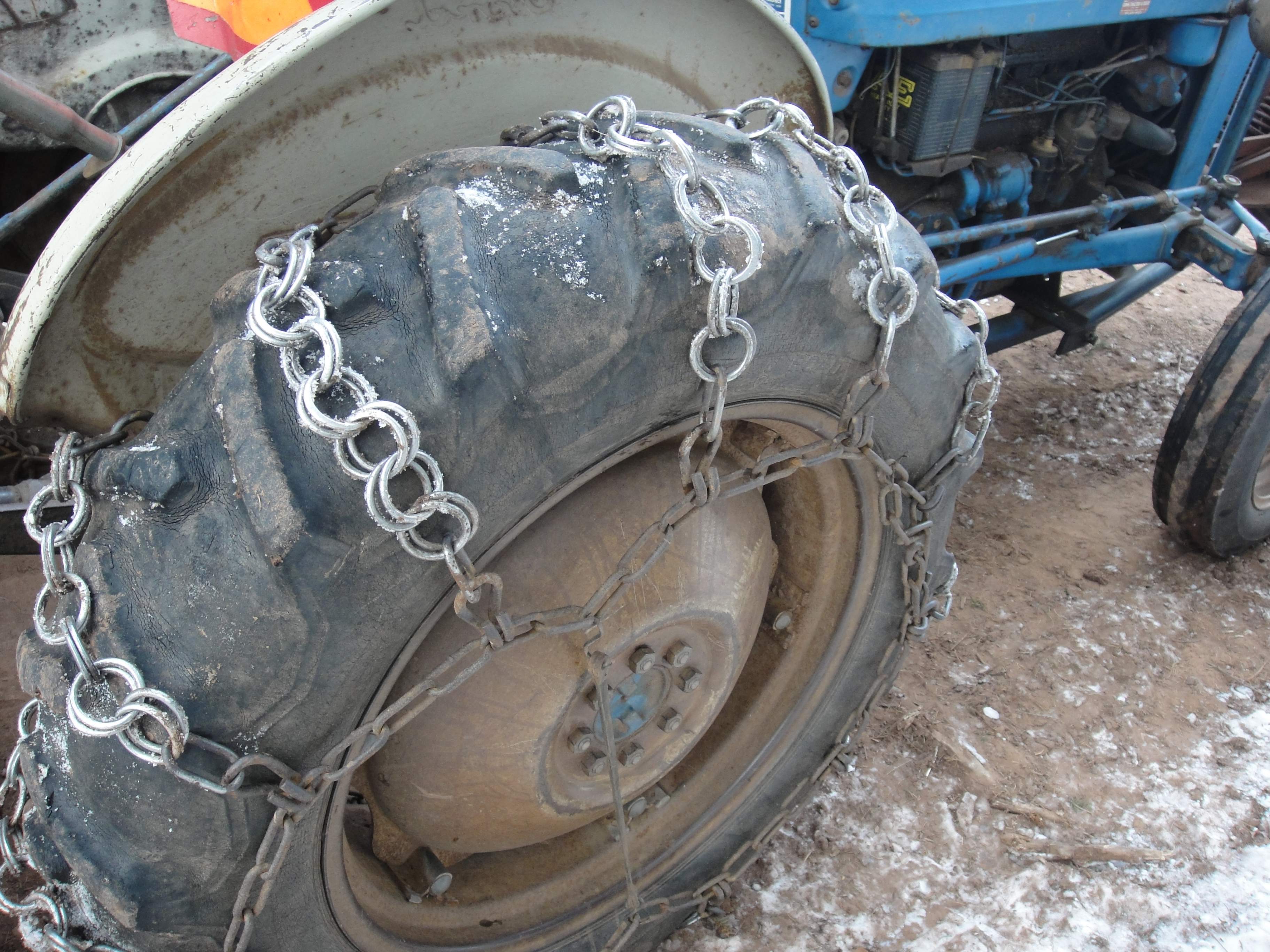

   / Double Ring chains - lateral traction ? #4
These are the chains I was talking about, seem to work good with ags, this guy is 96 years old and still drives his tractors almost everyday :)

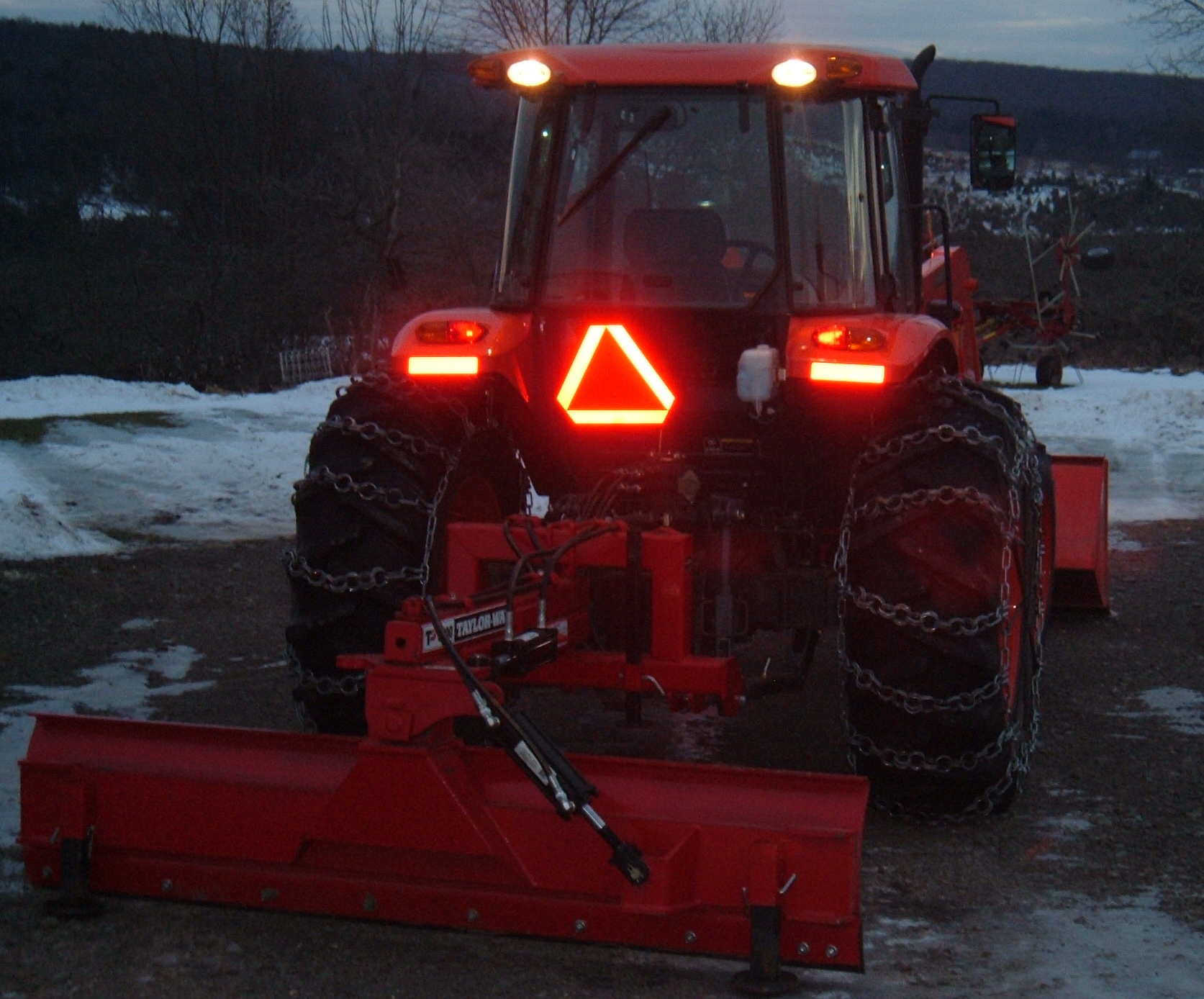

we have double ring chains on all of our farm tractors, and even the backhoe. Kuboda snow equiptment 001.jpg
