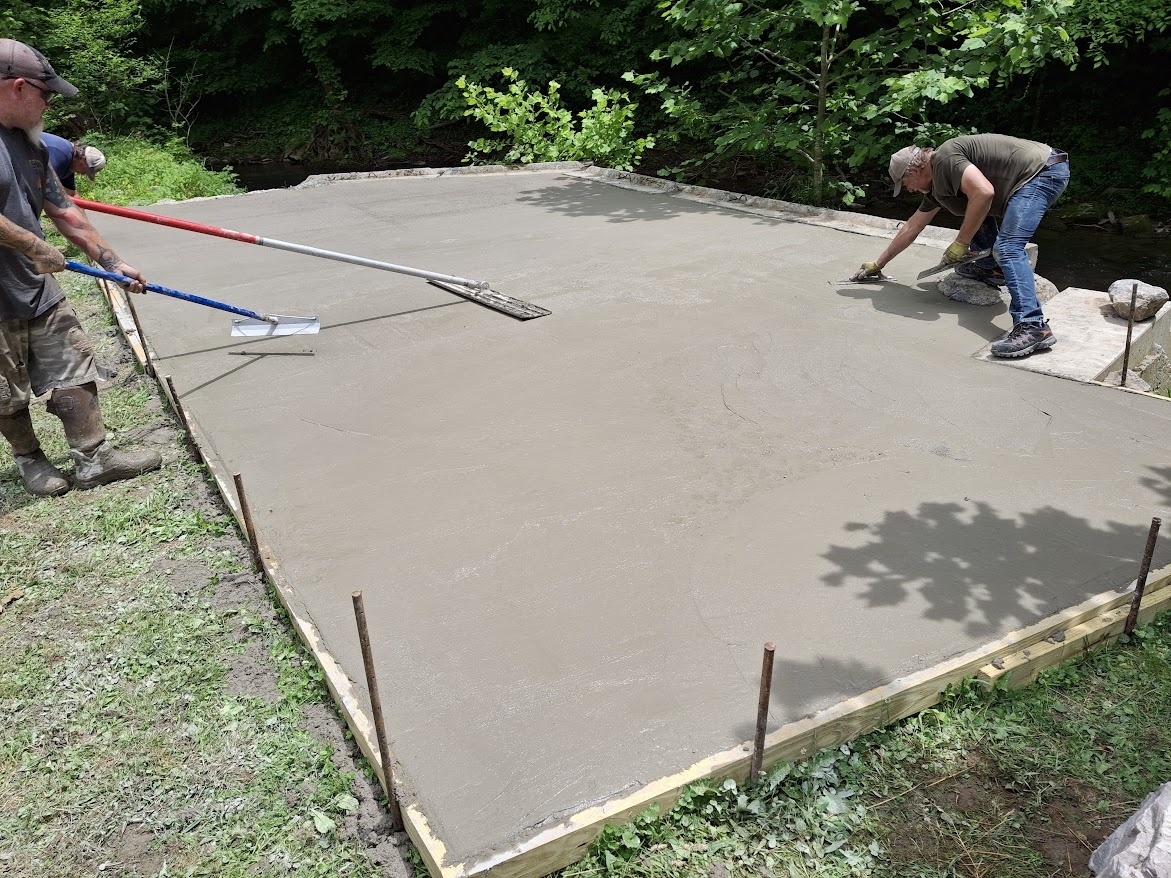

Old thread, but I just poured a 32x16 slab at the creek. Completely forgot that I could have had them add color to the 7.5 yard truckload.
So Eddie, which type of stain that you tried has failed? I was thinking using the acetone based stain.
