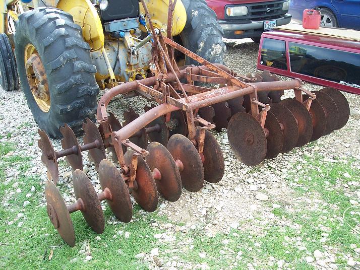

The biggest problem I see with most 3 pt. disc's is the rigid frame, not allowing the separate gangs to flex some. A buddy of mine has a CA Allis with OEM snap coupler disc, and has the same problem with the rigid frame. That's also why I have an IH Fast Hitch disc that hardly ever gets used. Rigid frame, and you need to unbolt gangs to adjust the cut on it.
I borrowed a pic of a Massey 22 disc off another site similar to mine, and to show why I do like mine. If you'll note on top of the tubular frame, there are two uprights, to allow the strut holding the inner gang to float/flex a bit. It makes a BIG difference. Although bolts are in the lower holes in this pic to make it more rigid, moving them to the top holes will let it flex.

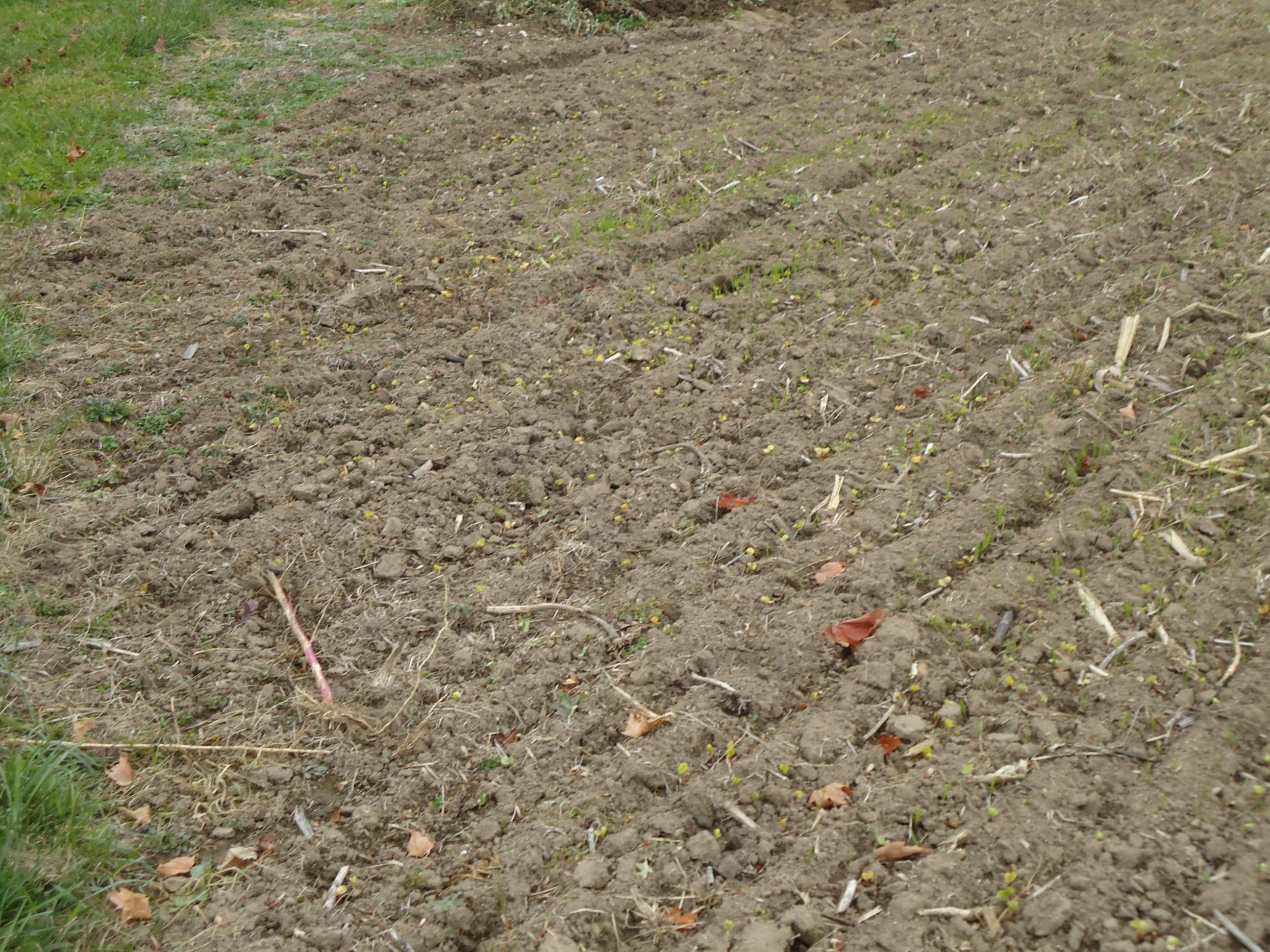

Plus it has the advantage of adjusting the cut pretty quickly with the adjusting handles. Full cut to disc plowed ground, or as mentioned, I used it to rough the sod in the fall preparing for spring frost seeding. Here is the finish I got with my Massey 22 last fall in the garden, when I sowed some Buckwheat & Oats for cover crop. I set it to full cut to disc up the left over vegetation, sowed the seed, then set it to a slight cut to cover the seed. Although I do have a 6' pull type with cultipacker attached, I decided to use the 3 pt. that day and was pleased with the results. It's most definitely a keeper..!! Oats & Buckwheat 004.jpg

I agree, that it is the rigid frame, on probably 90% of 3-pt disks out there, that is the source of their poor performance. Your problem will be trying to locate that 10%, such as the Massey-Ferguson pictured there, with moveable gangs. I have never seen a 3-pt disk with that feature. Certainly none of the new ones over at TSC have it. The ones sold by Ford, back in the 50's didn't have it. That Massey disk would give you "the best of both worlds", with moveable gangs, and lift ability for tight spaces. If You do find such a "needle in a haystack" - go for it. Otherwise, considering the cost of fuel these days, you would be far ahead, sticking with a rototiller (under 1/2 acre), or pull-type disk for larger areas.

Soundguy, once again, I messed up and did not get my point across clearly. I did not mean "adjustable", which your old Ford has, as do some sold today at TSC. What I meant by "moveable", was like on the old Massey pictured above. Those gangs are free to move up and down as the disk is in operation. That allows it to follow the ground contour better. However, I think it only allows for "up and down" motion, and not the additional "forward and backward" motion as is also allowed on drag-styles, and most lift-types. That would limit it's effectiveness in comparison. It looks like you are mixing up "moveable" (up and down anyhow), as I and DJ meant it , with "adjustable". "Adjustable" may be a good feature to have, but it don't do a hole lot for fuel economy, like "moveable" does. It does allow you to pull a larger disk with a smaller tractor, by setting at a lower angle. For example, I can use my 8 foot, drag-type, behind my aprox. 20 hp AC "C", but only if the ground is already pretty well worked up, or if the disk is set at a low angle. Obviously the lower the angle, the less effective is the disk at doing it's job. That 8 foot drag-type is a little too big for the "C" but just right for my 28 hp Ford 8n. It is grossly undersized for my 4wd, 43 hp JD, 4120.
