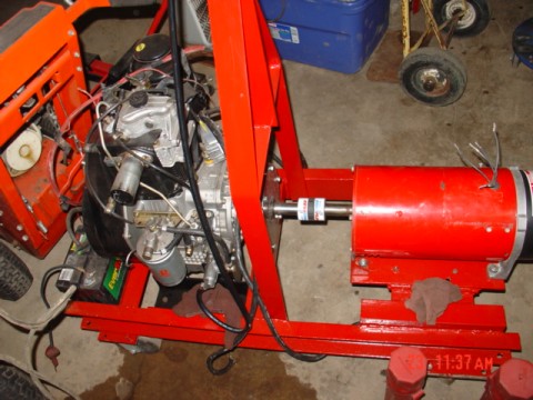

got the head back from the shop and put it on. finally figured the picture size thing. a computer wiz i am not..

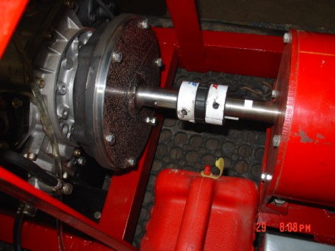

So did you run it? How was your alignment on the lovejoy? Direct drive is still the most efficient method of power transfer.

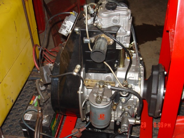

fired it up today. the lovejoy alignment is good. the a/c wiring is all done, just gotta finish the tank and the control panel.

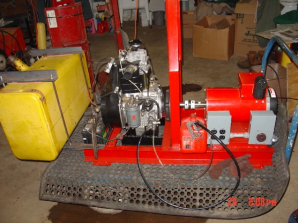

another view. the rubber mat is going to be used to isolate vibration. the old commercial kitchen mat was the trick, it worked really well.
