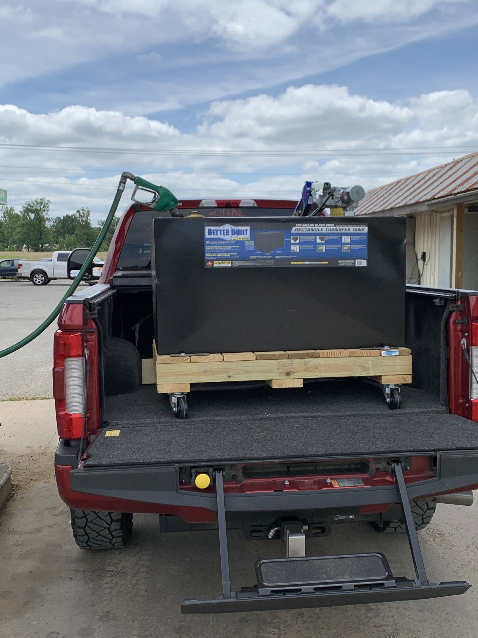

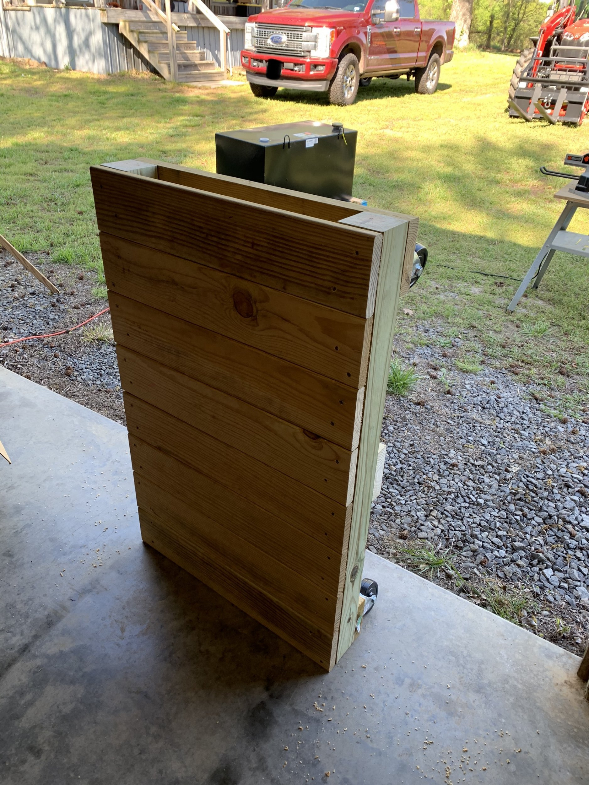

I have the same tank from tractor supply, it was dented and needs paint around the dents. it has no leaks but when I shined a light inside and saw some rust at the bottom. the diesel should stop that. I built a pallet type of cart that fits my forks. When it’s on the forks the power cord on the 15 gpm pump makes it to the tractor. I can power it with a lawn mower battery too which is light and easy to handle.
