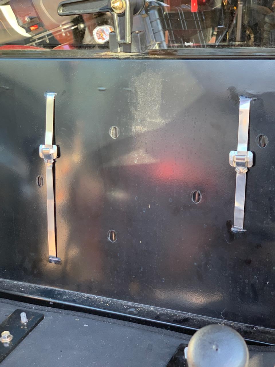

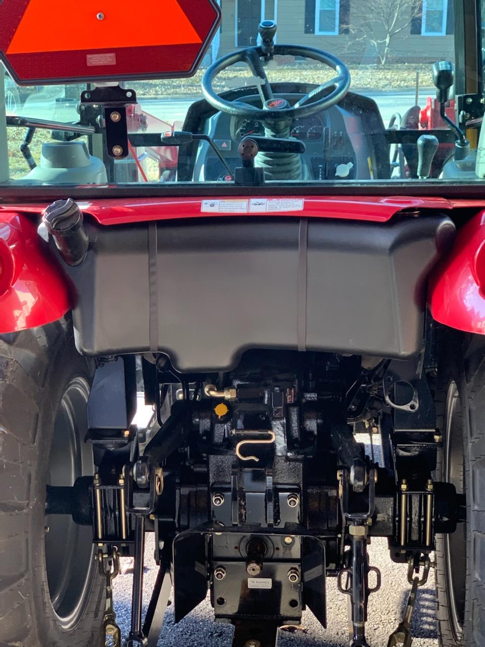

So a quick update - after careful consideration I decided to not attach the tank to a mounting bracket. After measuring and reviewing the area it simply didn't make much sense. It would have caused the tank to set out 1/2" to 1" from the back wall of the tractor cab which would have caused alignment issues with the upper metal cover. I decided to mount the tank to the back wall of the tractor using straps. You may be asking - why not use the bolts and simply bolt it back into place. The bolts is what caused the issue in the first place - every single tank mount insert cracked the tank. I didn't want to chance another cracked tank. So on to the install; I used stainless steel bands, heat shrink and stainless steel securing clamps. I mounted the tank to get an idea of how long to cut the heat shrink and stainless steel bands. The heat shrink is used to cover the stainless steel bands on the outside of the tractor. I wanted something that wasn't readily noticeable and provide some limited protection to the tank thus the black heat shrink. At the same time I also marked the back wall of the tractor as to where I would cut slits for the stainless steel bands ingress into the cab. Once I had marked the back wall (measured and triple checked) I cut four small slits in the back of the tractor cab using an air die grinder. I then fed the straps through the heat shrink (marked the bands as to where the heat shrink should rest as to not have too much heat shrink). I then fed the bands through slits and around the tank. I went inside the cab and used the banding tool to tighten the straps. The clips were the hardest part as the clips are designed for a pole (round structure). I had to use pliers to bend the ends of the clips to hold the straps in place (didn't want to hammer on the tractor back wall as to prevent damage). Note: use something under the clips when bending the ends to prevent paint damage - I used thick cardboard. I finished the project by applying a little clear silicone to the band area inside the cad to prevent water infiltration via wicking action from the bands. Overall I'm pleased with the look and functionality - shouldn't have any fuel tank issues in the future (I hope). And BTW - remove the operators seat as you'll need the added space for banding functions.

View attachment 686063View attachment 686064
EXCELLENT......looks very professional!

Wow! Nicely done, looks great!
Thank you..simply put some thought into the project and take the time to do a reasonable job.
-Chris

Looks good but I do have a question. Are the straps the only thing holding up the tank or is there something else under it?
