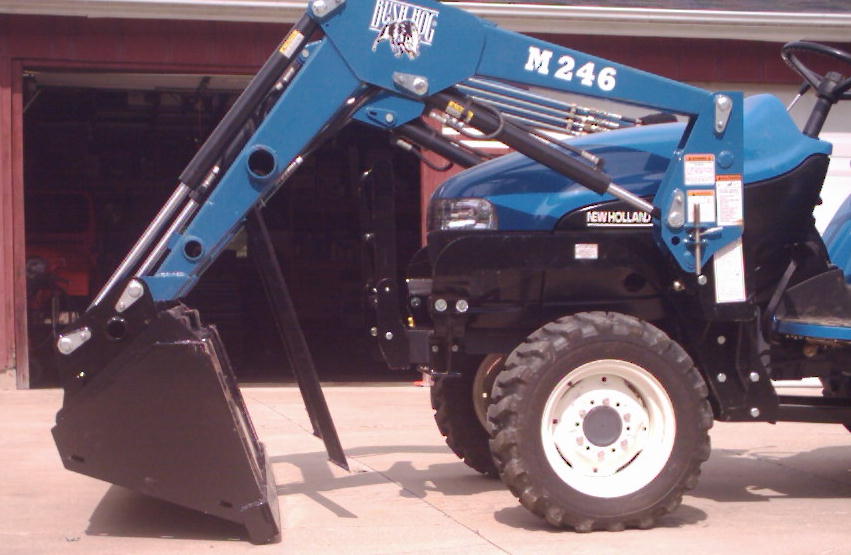

Detaching M246
This FEL cannot be detached with the bucket facing straight down like some of you said you do, as can be seen in this picture. The FEL legs are no where near the ground.

Re: Detaching M246
Mine won't detach in that position either. I have to have it flat, then angle it down somewhat. The FEL winds up with a slightly forward tilt - keeps the rain out of the bucket that way.
