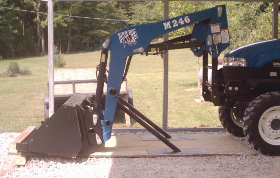

Success!
I finally got the FEL detached on the gravel. I made a platform out of 3/4" treated plywood and screwed a 4x4 on the end to keep the FEL from sliding when I attach it. I had to make sure the platform was perfectly level and the ground in front of it was also perfectly level or the FEL would get cocked when I tried to detach it. I used 2 pieces of 1/8" plate steel to support the area where the FEL legs sit, or they would dig into the wood and gouge it out when they slide back during the detaching process. Only the front wheels of the tractor go up on the plywood, so a 8' sheet was long enough and barely wide enough (part of the tires extend past the edge of the plywood).

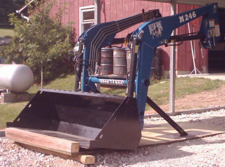

Re: Success!
This picture and the next one shows how the FEL bucket and legs slide as the FEL is detached.

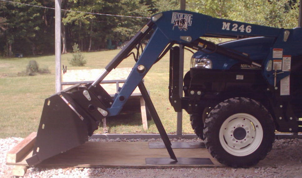

Re: Success!
As the bucket is curled in (rolled back) to lift the arms off the mount to detach it, the FEL legs move back about 6", so the plate steel is needed to keep the legs from digging into the wood.
