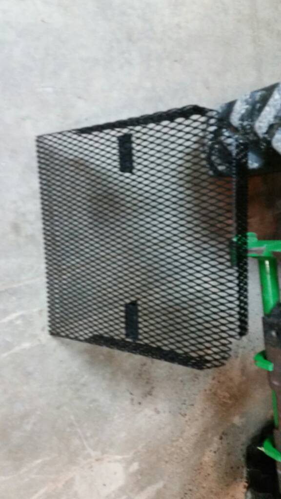

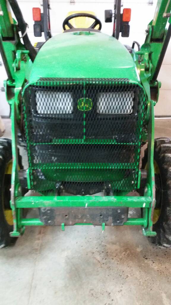

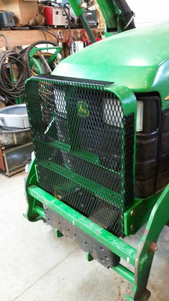

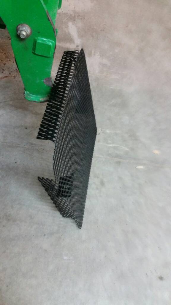

Built this today out of some expanded metal screen. Bent the edges over 180 then the 90 so they didn't have sharp edges and gave it some strength. Only put on the 2 mounts for 2 bolts. I might add an upper one later.
Since someone will ask why I painted it black, we'll I really like the Rustoleum spray bed liner. It holds really good and is more of a plastic than paint. Seals and covers rust. I use it all the time and have not seen it peel off yet. Works really good after sandblasting. No need for primer and dries pretty quick. 20180610_152807.jpeg20180610_152802.jpeg20180610_152741.jpeg20180610_152737.jpeg

Looks good.
   / Deere Front Brush Screen #3
Nice :thumbsup: little extra protection never hurts.
   / Deere Front Brush Screen #4
Good idea !! I like the way you made that.
