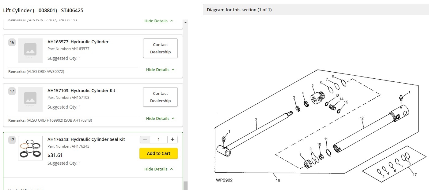

1999 John Deere 4100 w/410 loader
I have a 410 loader S/N 006943 with the AH 163577 hyd cylinders. I can't find the S/N lookup for the loader but understand there are different kits based on that. Could somebody point me to the S/N lookup or tell me is the AH 176343 rebuild kit is correct for my cylinders?

@EddieWalker is correct in saying that cylinders can be difficult to rebuild, but in this case, if you are mechanically inclined, you should be able to do it.
The kit is correct. You don't need the S/N as you have the loader cylinder number. The kit runs about $35 from Deere.

Take it to the local hydraulic shop. They have the experience and the tools as well as the ability to tell you if any other parts are required.
   / Deere 410 loader cylinder rebuild kit which ones?
Thanks for all the suggestions and I will rebuild on my own. I am used to doing motorcycle forks, and have a pretty decent mechanical acumen so this is something I know I'm capable of. Also thank you for the welcome and I'm looking foward to getting into a new hobby.
