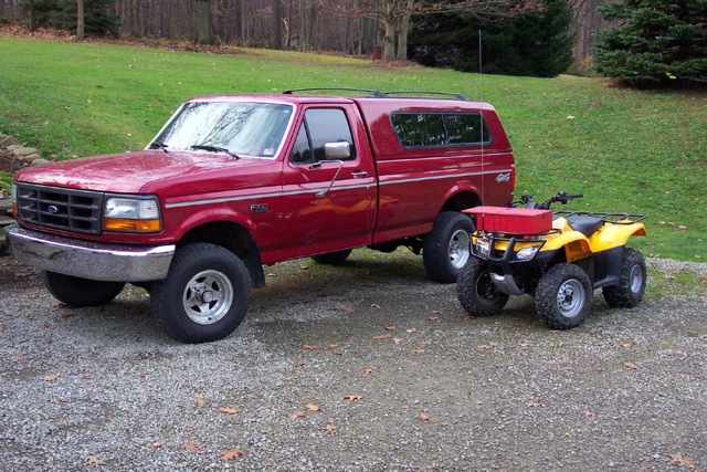

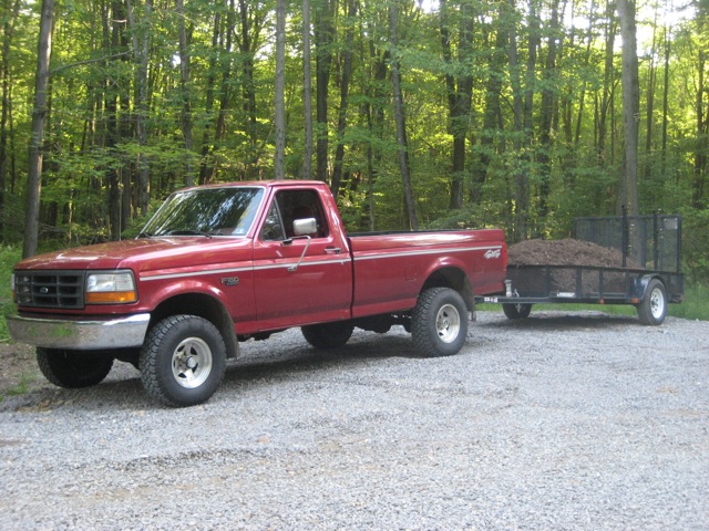

wh401 - The paint is in good condition. In fact, I just had some rust repair and painting done on it. The under body of the truck gets oiled every fall. I usually wax it twice a year, spring and fall, with washings at least once a month. This, of course, will probably be reduced to a fall waxing and limited washing.
As for parking, I plan on adding two 8' sections on to my machine shed, one for the truck and the other as an 'open' space for whatever I want out of the barn at the time. This addition will be enclosed with a gravel floor.
FWIW, here are a few photos of the truck...

That is a nice old truck. Always liked the strait 6. Plenty of torque and dead reliable.

BTW - the truck is way to nice to get rid of or trade in. I'd keep it too.

I think you should get rid of it or send it my way! I love the package 4.9L 300, 4x4, 5spd manual, Std. cab, 8' bed, especially the six. If they made them today, I buy one in a heartbeat. Best engine I ever had.
I can't part with it, that is why I'm trying to justify keeping it! I could probably get away with buying a trailer (like the one in the picture) and towing it with an SUV, but I really like that truck and can't see anyone else having it. Very reliable, indeed!
