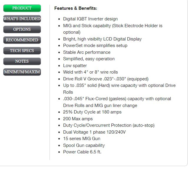

If you are ordering .035 contact tips it would indicate to me you intend to use .035 wire, so need to order .035 drive roller.... Spec sheet says it only comes with .023-.030 drive roller....

Thanks! I did overlook that.
