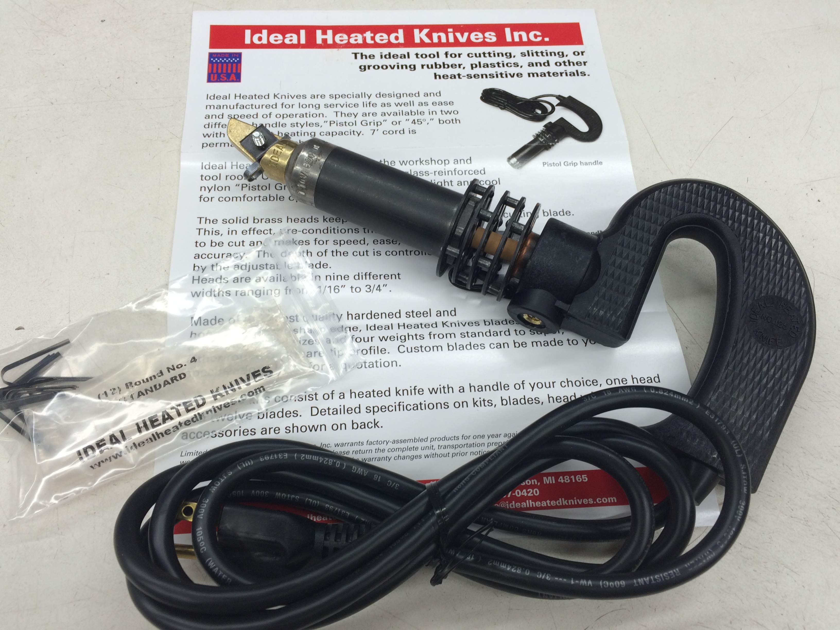

I joined "Club Sipe" today:
Nice job, Kenny!
If you don't mind me asking, where did you get the siping gun...and how much?
I have one on my Amazon wish list...not sure if it's a Ideal....price is about $72.00

Got mine on Amazon Roy, since I am "Prime" member I but most everything from there anymore. $78.97 to my door (have to pay MD sales tax now since they opened the new distribution center here) from the "Racing Warehouse" seller.
If you still lived in PA I'd ride up...

PM me your name and address and I'll mail yo mine next week and you can mail it back when you are done for the cost of shipping. I'm traveling this week but will be in NH next weekend.
