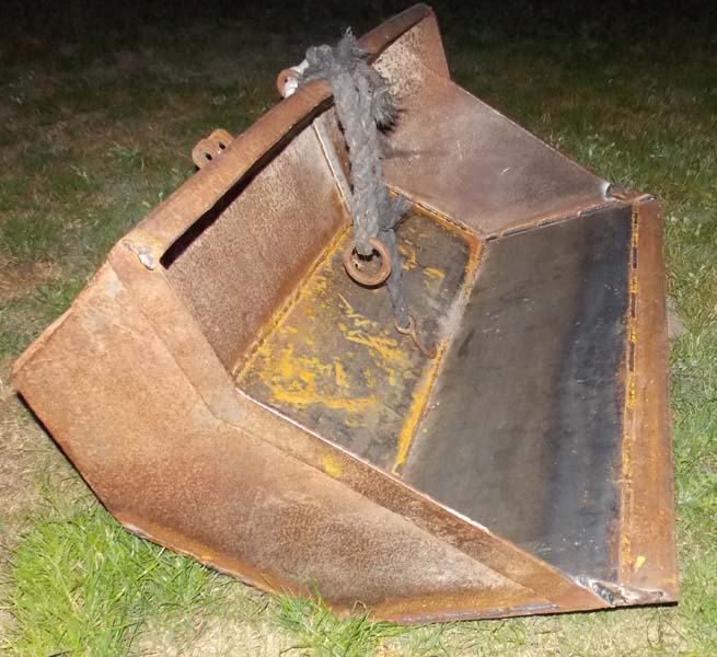

I bought one and welded it on.
It was quite expensive, a couple of hundred bucks for a 5' length.
When I took a close look I realized the bucket needed some new plate...
