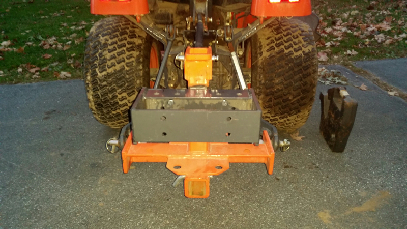

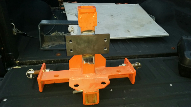

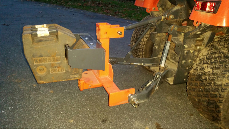

I found a brand new Kubota weight bracket with 3# 55lb suitcase weights on CL the other day and I had just the idea in mind. I had a bracket made up and welded to my Omni 3 point receiver hitch to bolt the weight bracket to. If I ever wanted to hang weights on the front, it'll unbolt and mount. Kinda simple but it works out perfect.

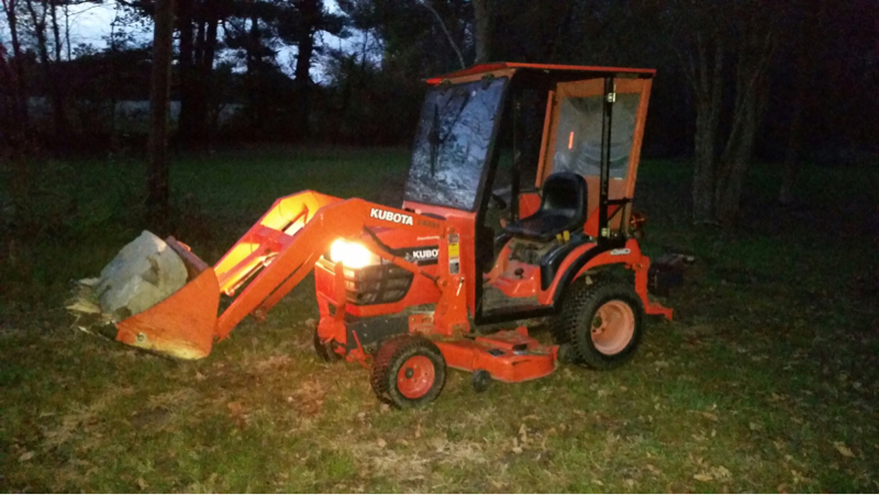

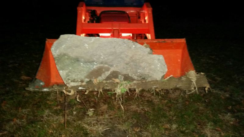

I wanted to try out the loader function with weights attached and picked up the close to the biggest rock the little BX could lift and boy what a difference.

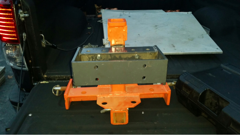

I still need to get some 5/8" all thread to bolt the weight pack together, but I couldn't wait to try it out.

Looks like a pretty nice setup. Are you sure you want to bolt them together? From this angle it looks like you may want to remove the weights when you use the receiver hitch to tow something, and it will be a lot easier on the back to remove 3 55lb weights then it will to remove one 165lb weight. Even more so to put it back on.
If you are trying to stop them from rattling around, a cheapo quick grip clamp might do the job and still be quick to put on and off. Just cut the bar to the right length so you don't chew up your shins all the time when you are walking round the tractor.

Thanks. It's only a single 5/8 x 6" bolt holding the weights together, pretty quick to take out. I really don't tow too much anymore with the BX though.
