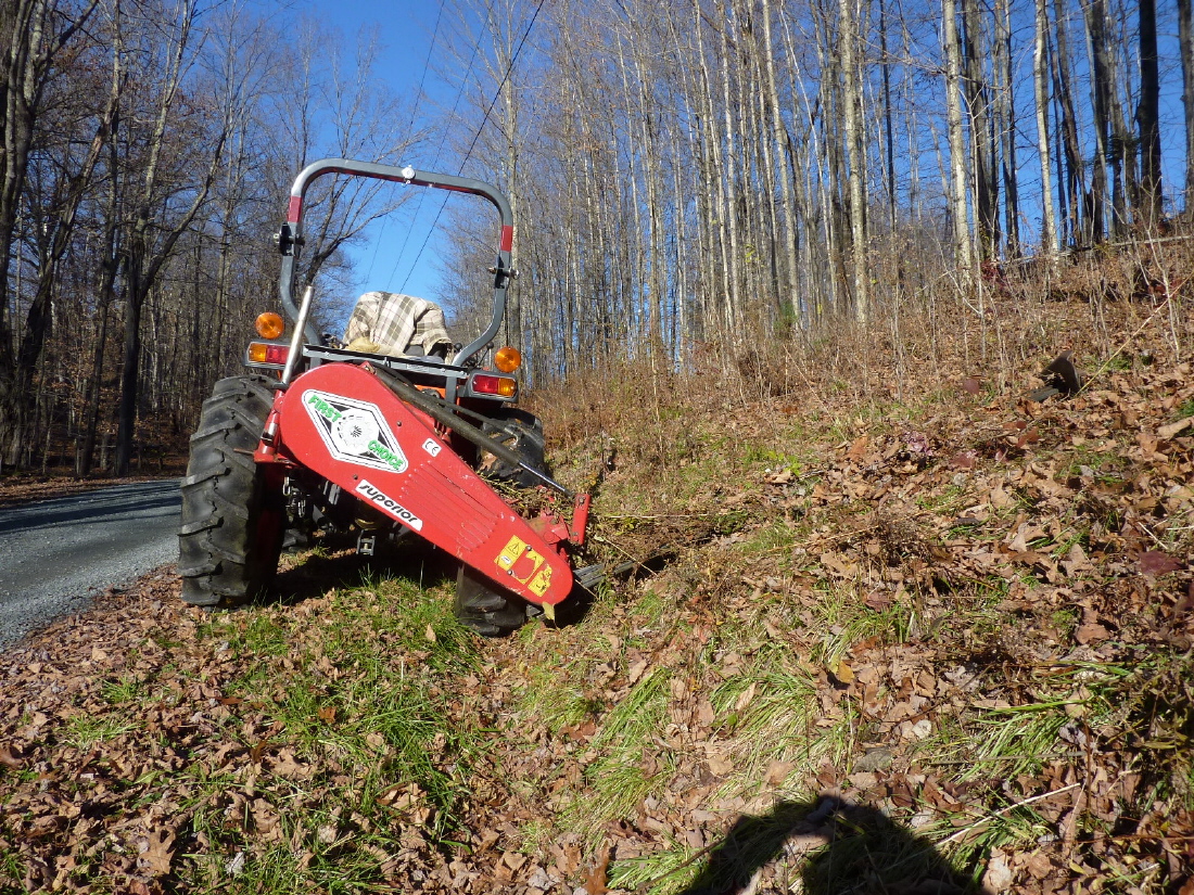

Used my Enorossi BFS 180 for the first time today. A couple of thoughts:
Why cant they come up with a proper stand so it can be mounted/dismounted level? There is a kickstand for the left side, but the right side is not level. WTF. looking at some pix on the web, a guy propped his up on a pallet with a cinder block under the right side. Any home made docking station ideas will be welcomed!
This does not fit a Titan quick hitch so any hope of an easy connect is lost for me.
Once connected, it's a beast down the ditch line, but I only see myself fighting with it once or twice a year. It was pretty expensive so I hope it lasts 25 or more years.

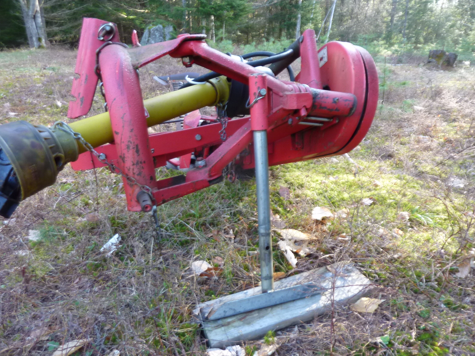

I have a First Choice sickle bar. It is the hardest implement for me to hook up.Heavy, awkward, and unstable when on the ground. But it gets easier. With time you develop a better system. For a kick stand I have a vertical pipe with several cross holes in it that slides up and down inside a short section of larger pipe with a cross hole that is welded to the mower frame. It allows me to adjust the kick stand as required with a pin through the holes. Maybe something like that would help.

Thx for the encouragement. Can you snap a pic of your stand when you get a chance? Sounds promising

This is a picture of my mower. The stand is the silver pipe sticking up on the left side. It is like an inverted "T" that drops down. Tomorrow I will go out to the field where it is sitting and get a better picture.
