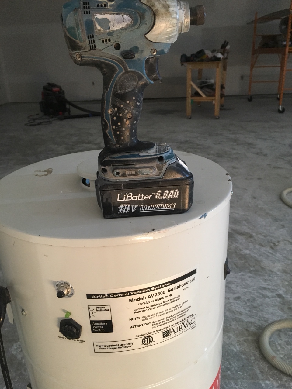

I needed a battery after one of mine died and was looking for aftermarket ones on amazon. I found a 6AH one for $10 more than the 4ah ones I already had. I didn’t have much faith in their advertising but I figured I could afford $10 to find out. I was wrong. They’re like the energizer bunny and just keep going. I think my tools run a little stronger too. IMG_4275.JPG
