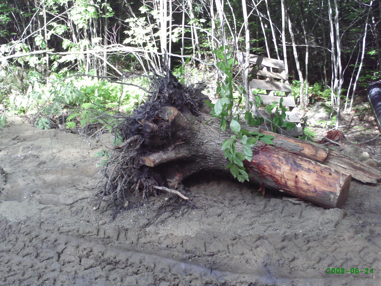

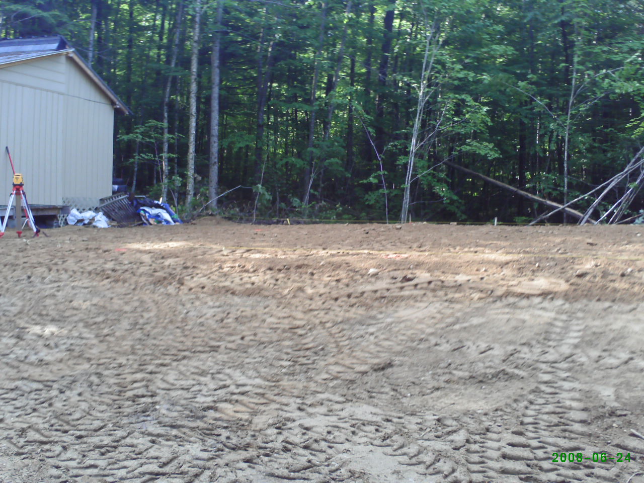

So I fell in love SteelDusts pole barn and am working on my own. Here are some progress pics of the site work Ive done. In total I have about 160 yards of boney gravel fill. The site is on a slope, the price you pay to live in the foothills of the western Maine mopuntains! Hmm seems that my files pic files are too big, will retry some photos later, in a smaller format.
/ Copy of Pole barn #2
/ Copy of Pole barn
Ok, so heres some pics!

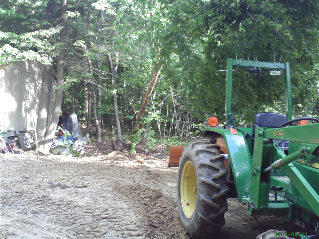

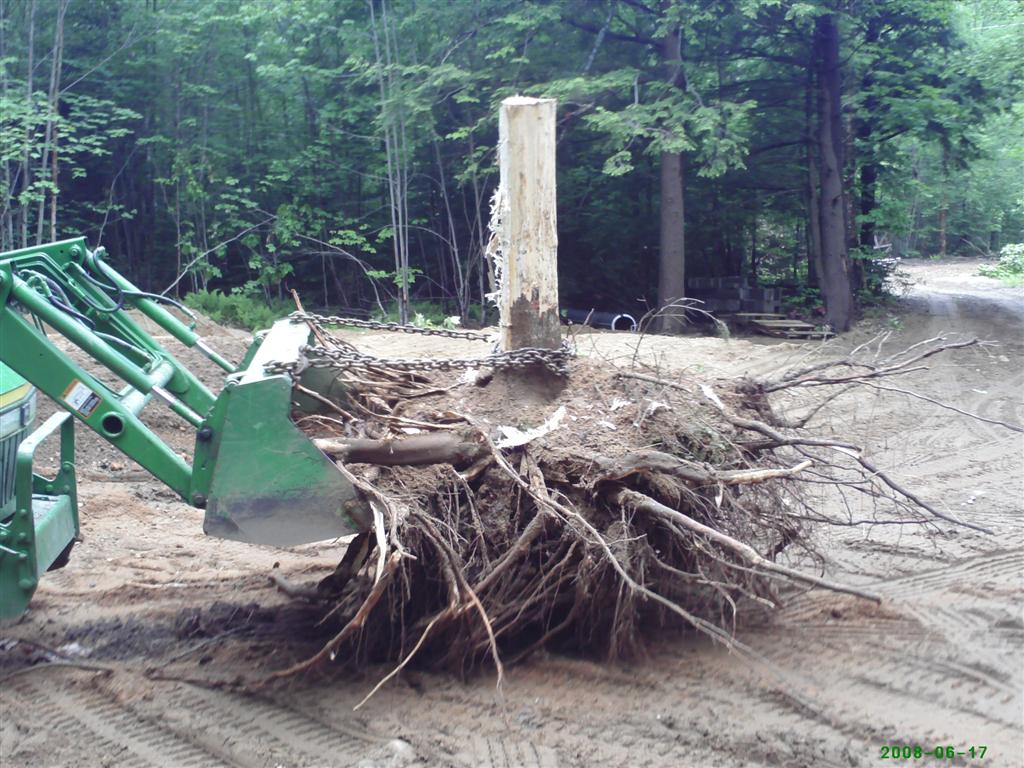

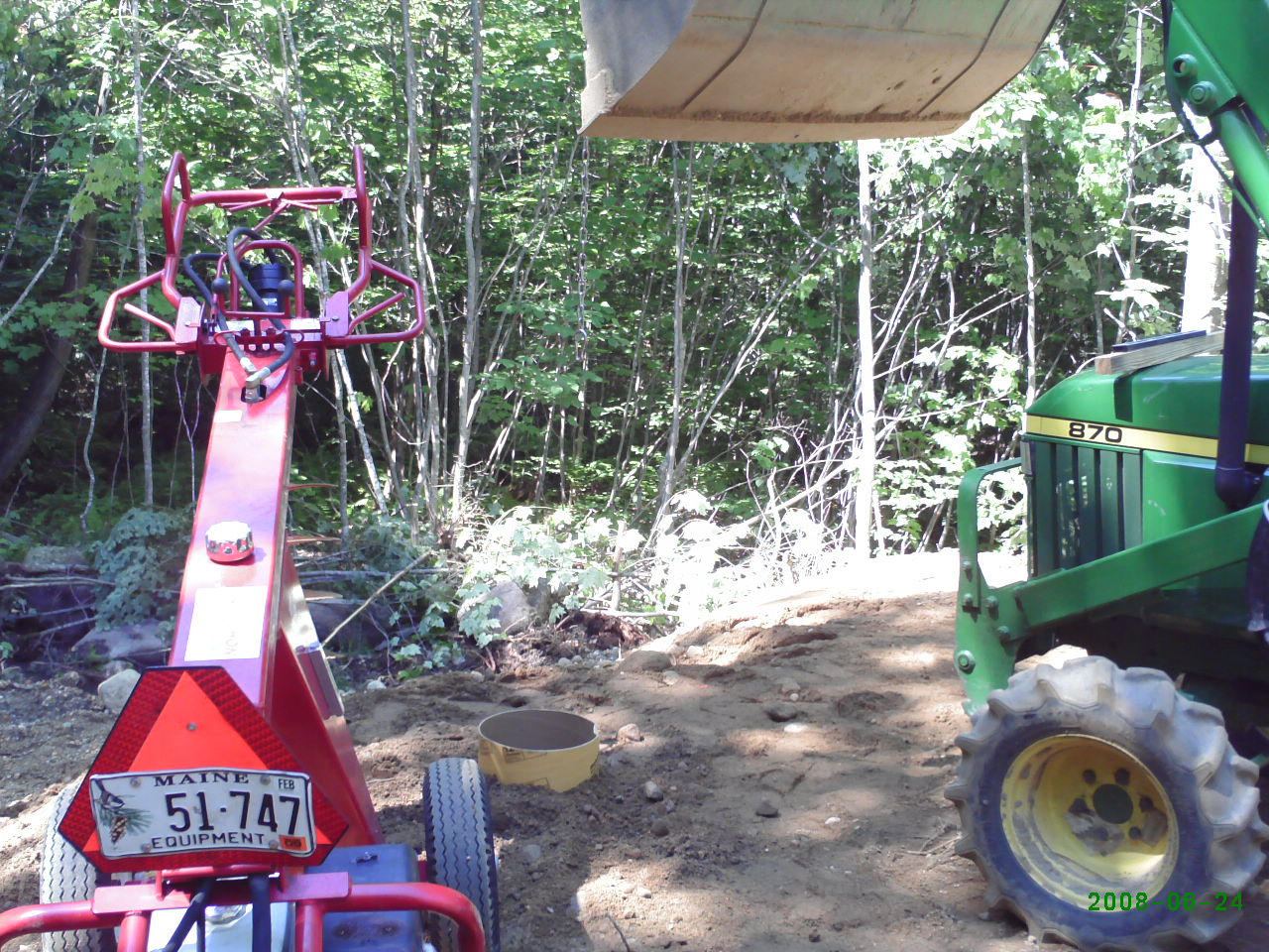

116 yards to level, a good sized hemlock tree stump. I chained off the tree about 25 feet in the air and pulled it down with the tractor. I rented a post hole digger as i dont have one for the tractor, once i had buried the auger i used the bucket and chain to extract it from the ground fulled loaded with dirt.

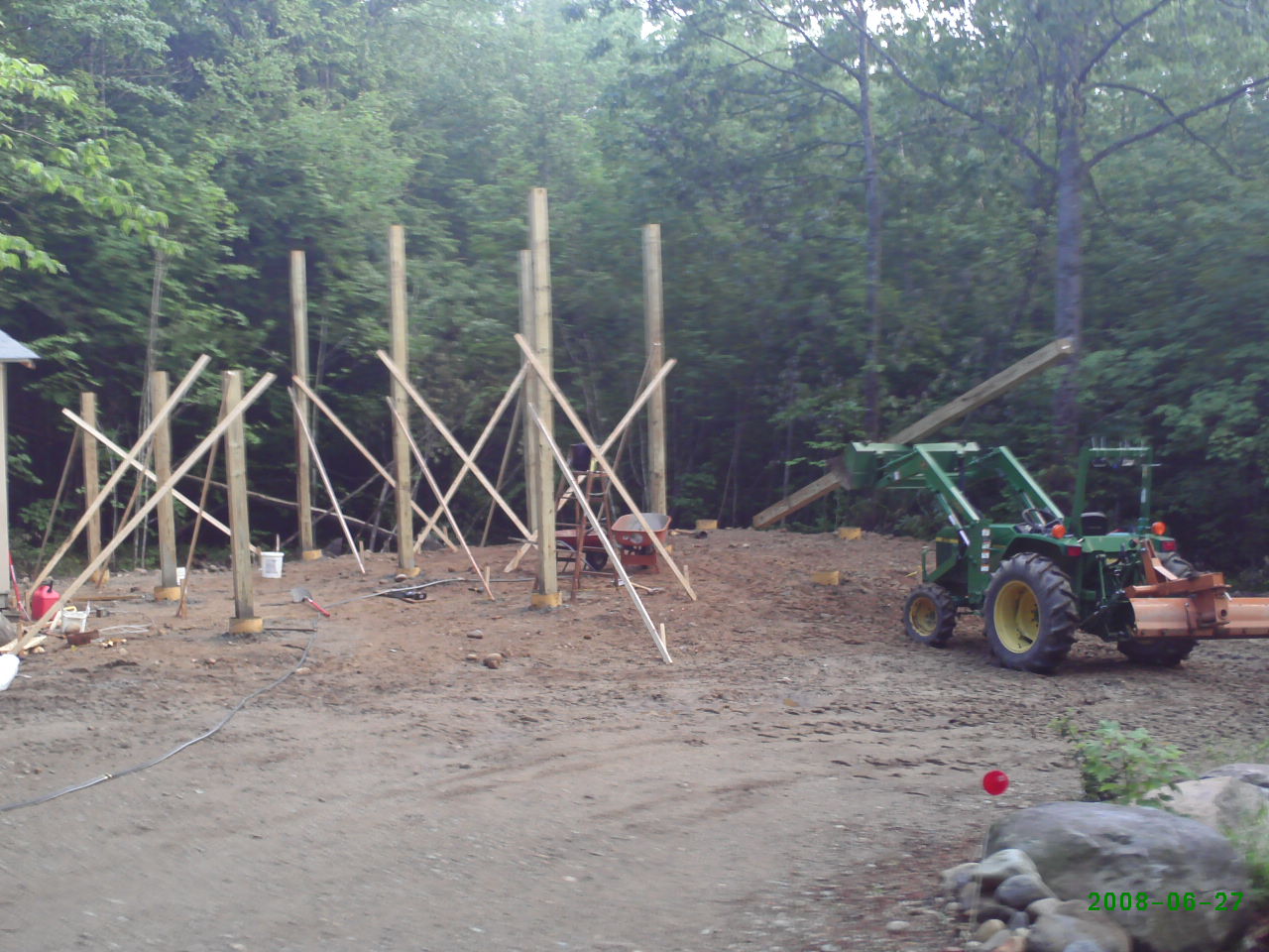

Mine will be a little smaller 32wide 24 deep. Hopefully this will be enough to house the tractor and a workshop, with area for cordwood storage. I see that on some of these barns people are running the rebar right through the 6x posts. Is that really needed. Ive got the posts set in 4 feet in sono tubes with cement. Ive already run the bar and will have a pic soon, all the posts are up.

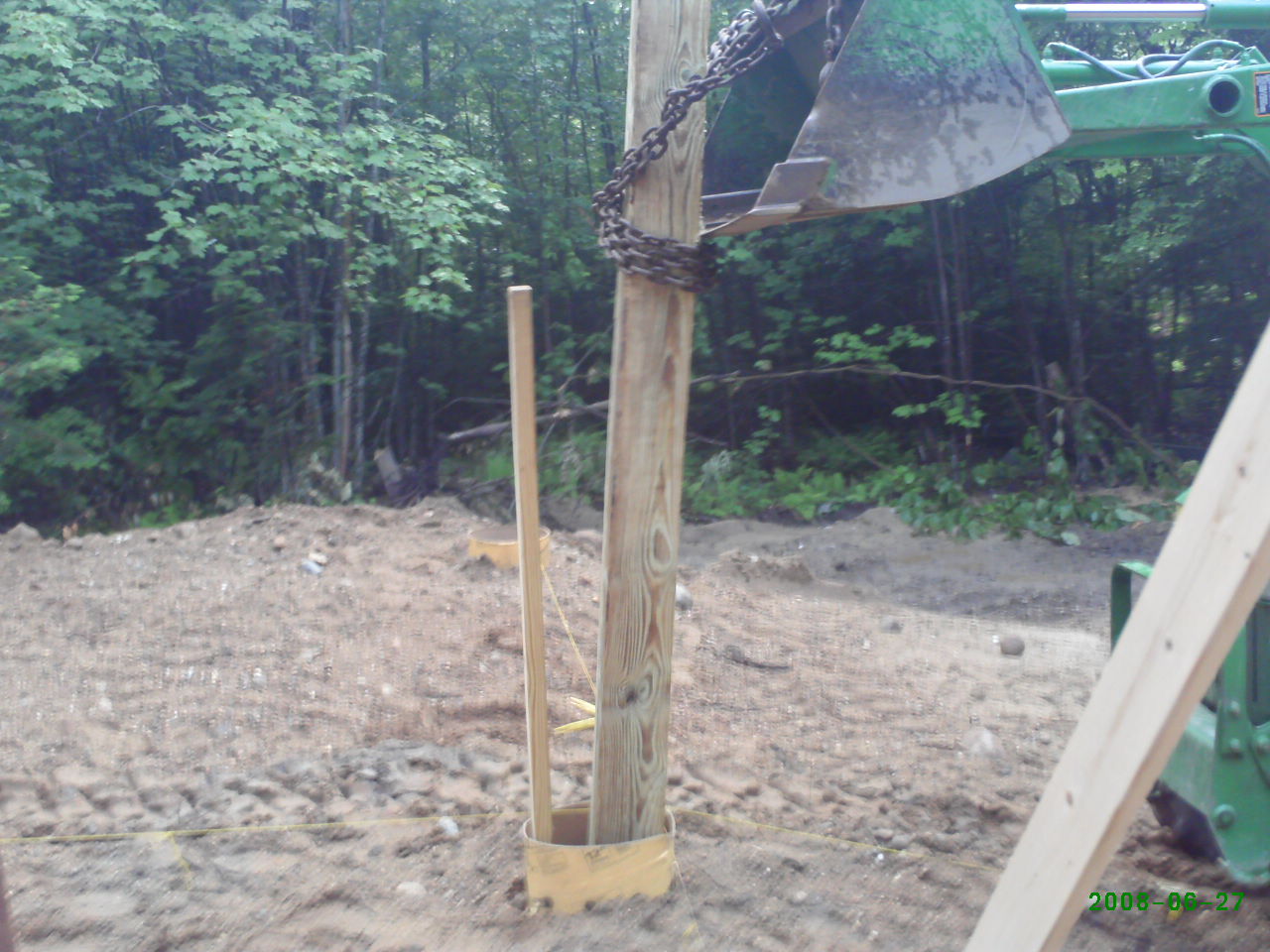

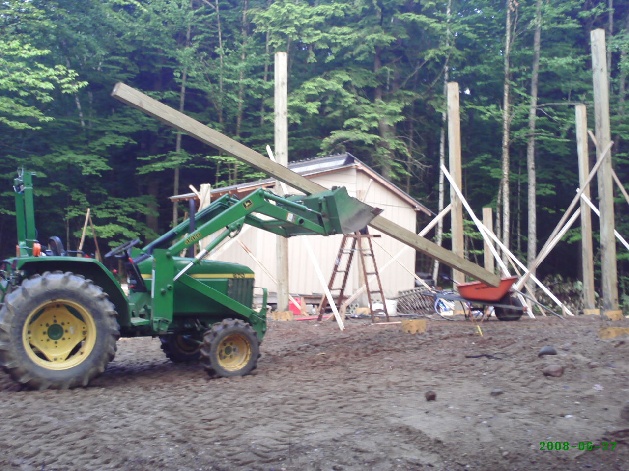

So here are some pics of the poles inserted, and a different way i used to insert the posts. I placed the 6x6x18 or 12' post on the bucket and bound it with a chain lifted it vertical and then gently lowered it into the hole, precision bucket curling!

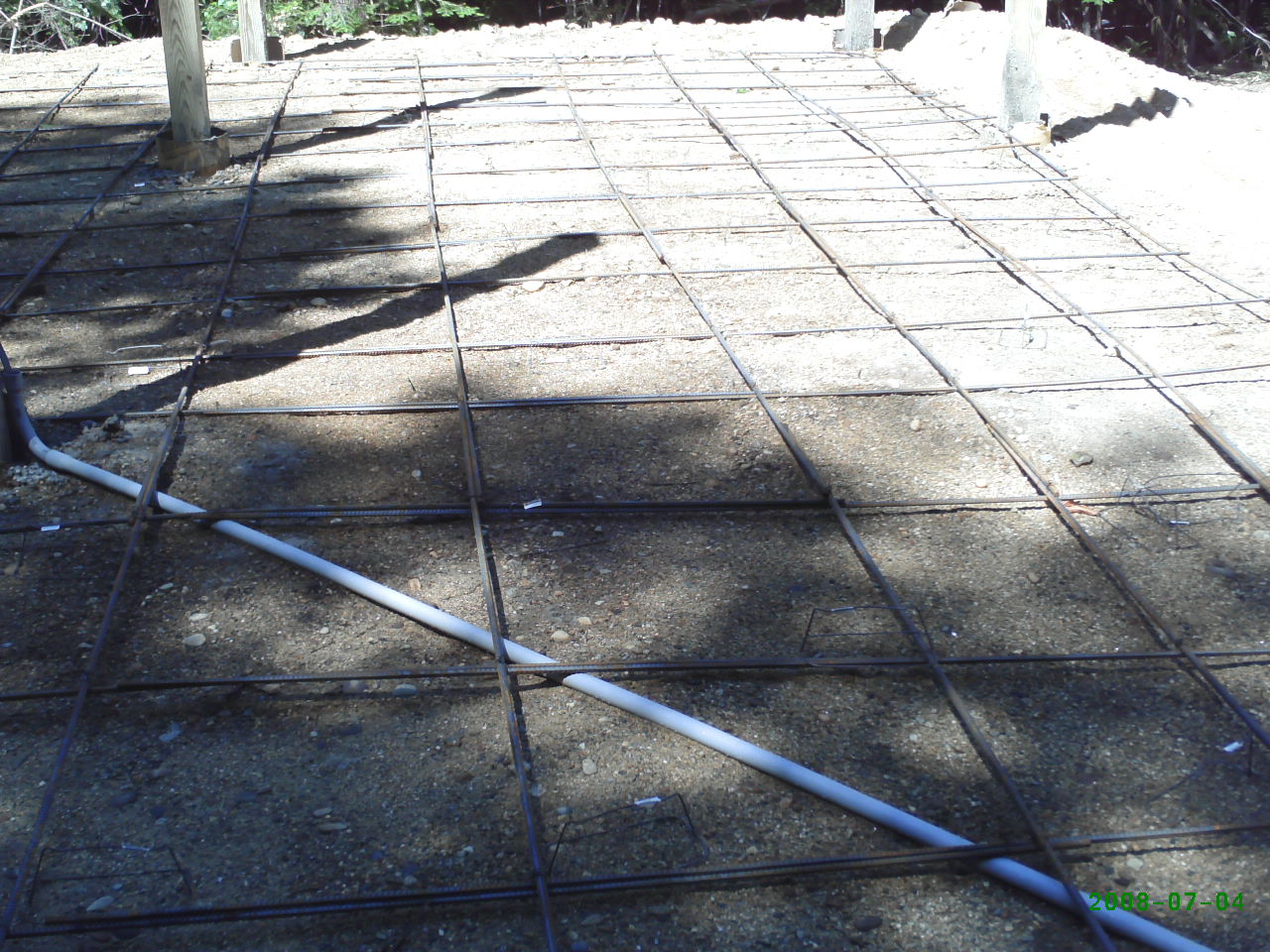

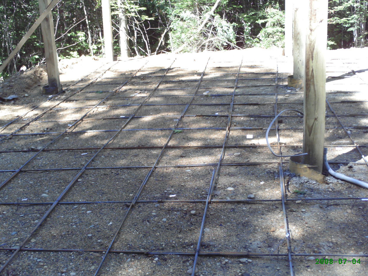

Ive got the rebar done, and here are some pics! Concrete well, when he gets here whenever that will be!

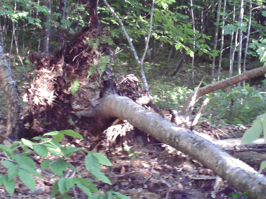

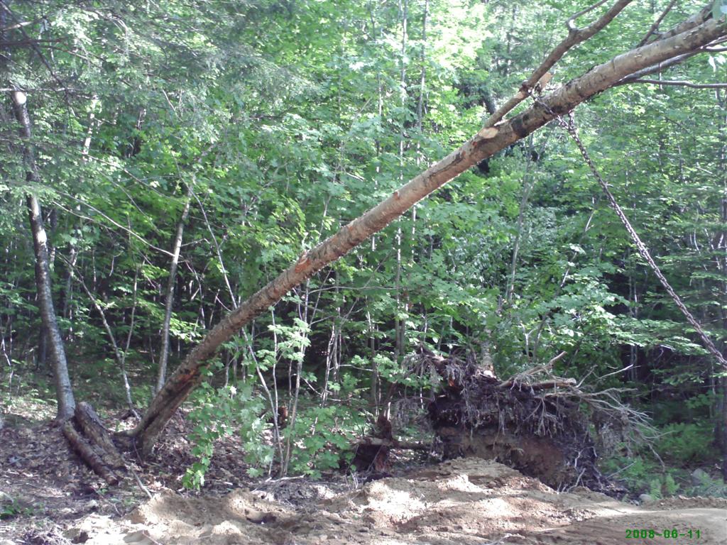

I resized some of the stumping pics, i pulled over the trees by chaining off about 30 feet up and driving forward to uproot them.

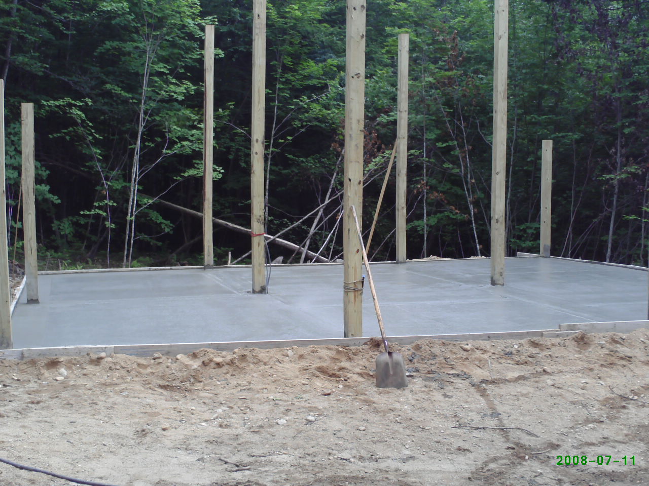

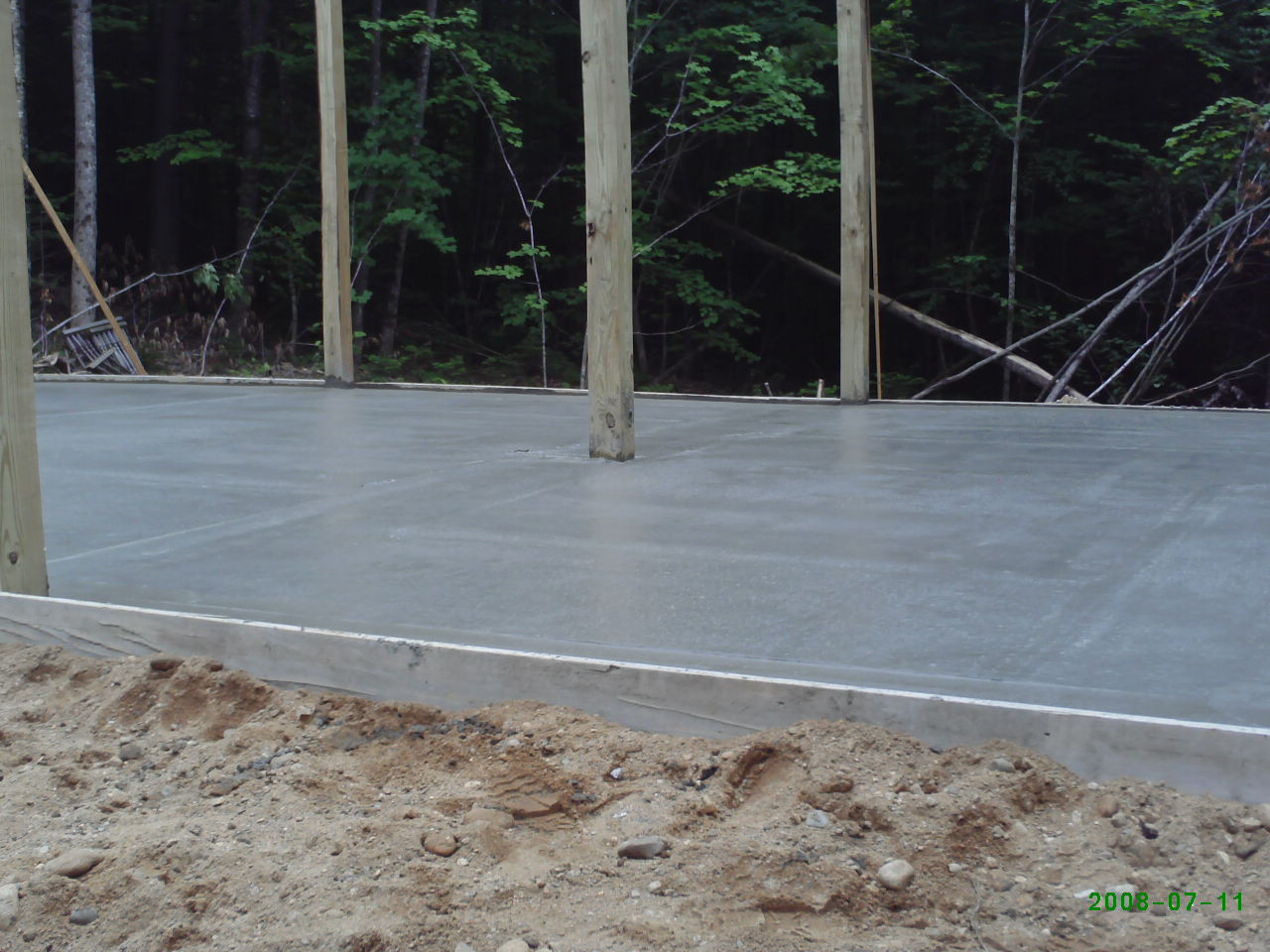

The concrete work went well, 14 yard pour for three of us. Power screed worked fantastic, and so did the power trowel. It gives the floor a real nice finish. I plan to use an epoxy coating to take the slip out of the floor and to protect it from oil/grease.

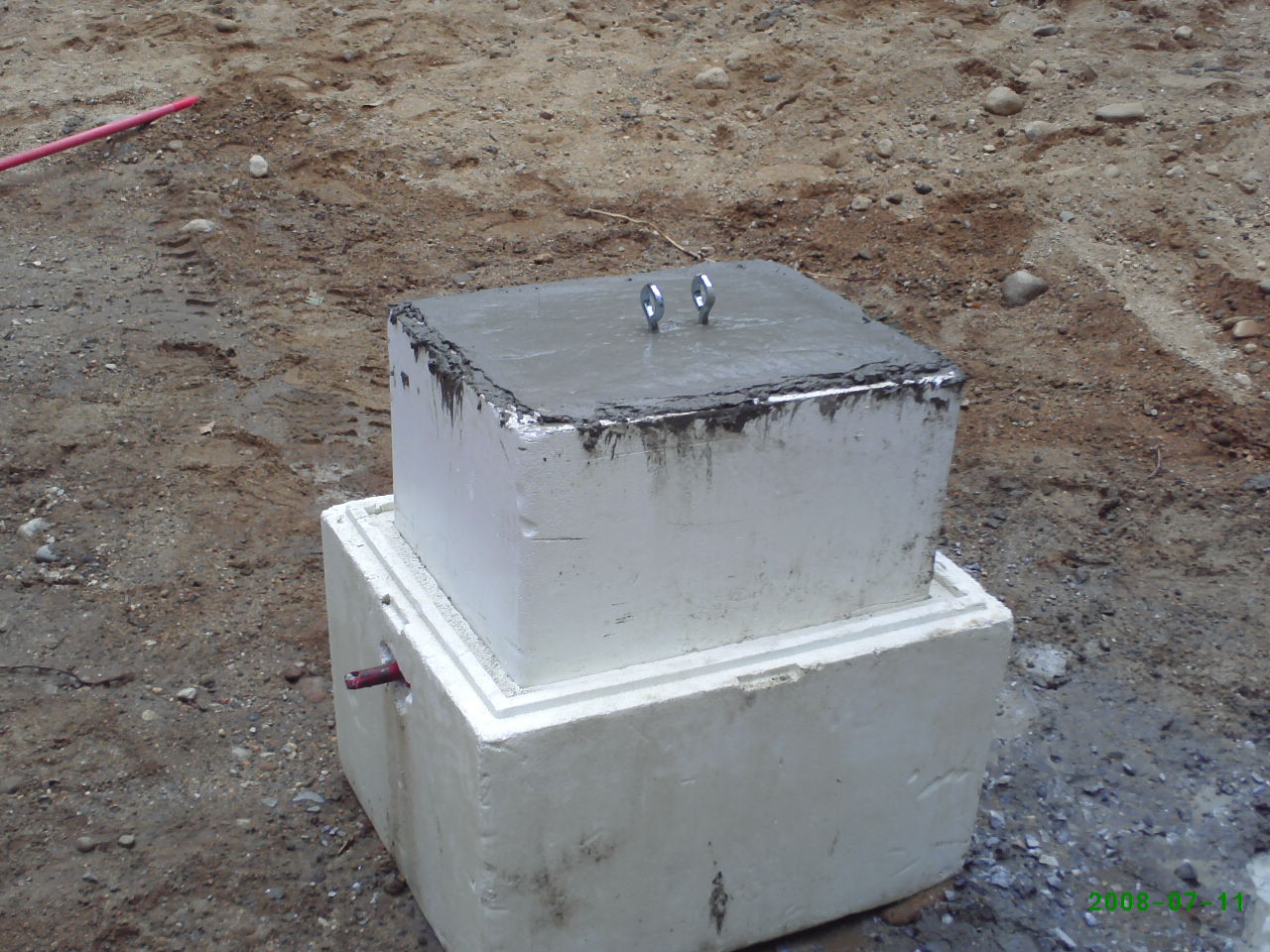

I also had some concrete to make a ballast weight for the 3pt. I used some boxes styro boxes from work, a 3pt bar and some scrap rebar. Anyone guess how much it weighs? The styro box is 3.5 inces thick on the bottom and 1.5 on top.

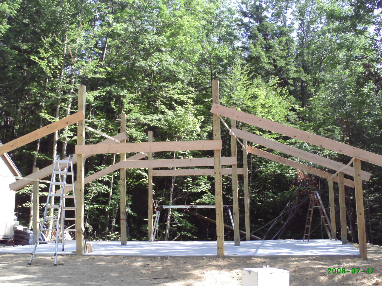

Now that the concrete has set up well it was poured on friday, and i did the framing tuesday, here is my progress.

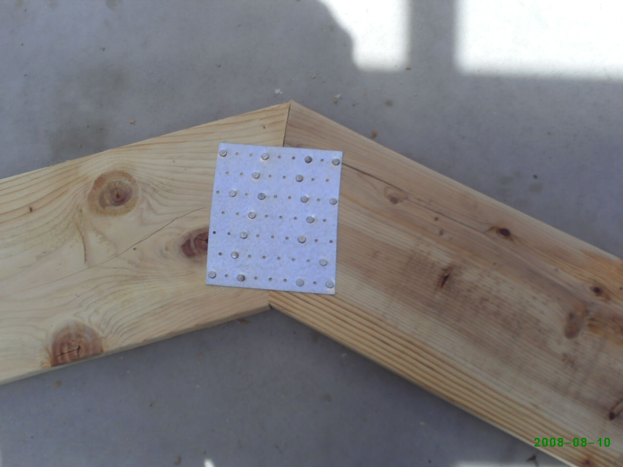

Here are some pics of the trusses that i put together for the loft roof. I used a good sized metal tie plate on both sides and a plywood plate over that on one side.
