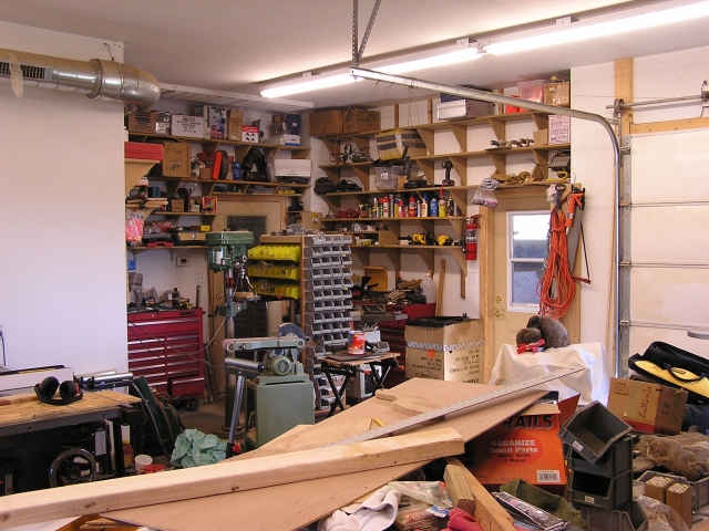

Picture of cluttered shop was included by accident.. The door leads to the metal shop however.

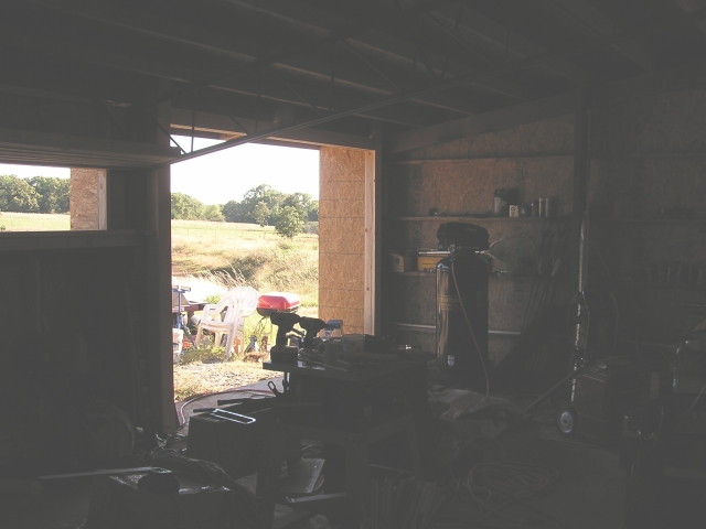

Dark picture is inside the metal shop looking out the hole for the overhead door (inline with overhead door leading into wood shop. The wood shop has nearly everything on wheels so I can move stuff out of the way and bring a vehicle into the shop to work on it under A/C or heating.)

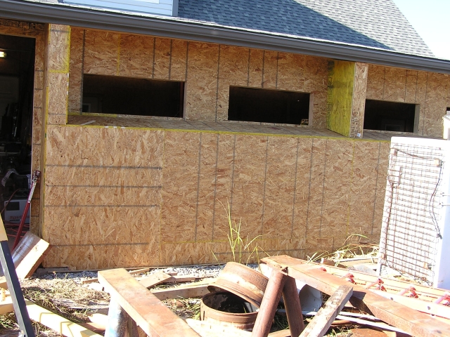

The picture showing 3 recessed windows shows the newly built wall. There are 6 windows, 2 per 12 ft bay (3 of the 4 bays) with the 4th getting an 8 ft tall 10 ft wide overhead door.

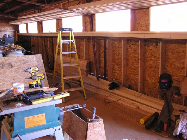

The picture with the ladder in is is inside the metal shop showing window holes which now have windows installed, pix later.)
The windows are recessed 2 feet. The apace below the windows will be shelves.

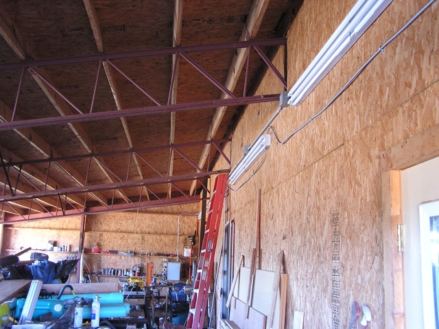

This is the picture supposed to be posted in place of cluttered wood shop. It shows the lights on the wall instead of the ceiling where they started out.
