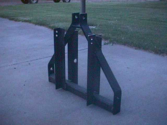

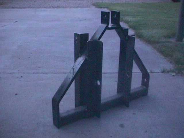

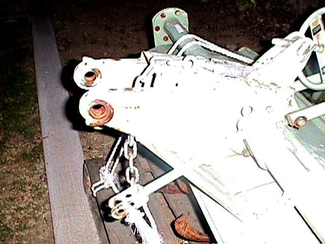

Dave,
I bought a Yanmar 2-pt with the same intentions as you in converting it. I found that my particular Yanmar 2-pt tiller has a 16-spline 30mm shaft which no one seems to have an adapter for. Fortunately mine did come with the short double jointed u-joint that adapts it to a std. 1-3/8" 6-spline. I have a welded-up std. 3-pt triangle with vertical 2" angles each side that will attach to both the 3-pt (on one side) and the 2-pt (on the other side). Haven't tried it yet but am hopeful....this way I won't have to modify the tiller and it can still be used as a 2-pt. The only challenge now is that I need some way to lock the splined metric adapter to the tiller input shaft since it has no circumferential groove cut into it for that method of securing it.....not needed on a 2-pt I guess.
Bill

I layed out the hitch interface/adapter in AutoCad and that's how I came up with the design and hitch pin locations. See attachments of hitch and tiller. Sorry about the picture quality....it was late.
Bill

Pic #2

Pic #3

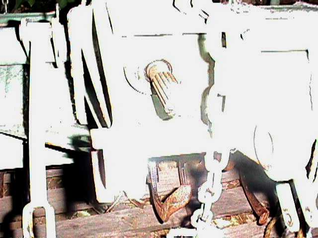

Pic #4

So, it turns out this tiller does indeed have a 16-spline presumably 30mm input shaft. Does anyone know if there's an adapter to mate it to a standard 6-spline PTO shaft?
I've asked to seller to now tell me if, when you turn the tines by hand in the direction they are supposed to turn, the input shaft turns clockwise or counter-clockwise.
Someone check me here: a standard PTO turns clockwise looking at the tractor, right? This would mean that a standard input shaft would be turned counter-clockwise if you're standing on the hitch side of the tiller looking at the input shaft, correct?
Thx,
Dave
   / Converting a 2-pt hitch tiller to 3-pt? #10
I went out and checked my tiller and tractor (with standard PTO) and they do indeed both turn correctly.....that is, tractor turns CW looking at PTO from rear of tractor, and tiller turns CCW looking at the tiller input shaft. Whew! But good luck finding a splined adapter. I searched all over the WWW and looked at the site for the mfr of the coupling, but no luck. If the tiller in question does not come with a splined coupling for that input shaft, I would leave the tiller where it sits ....... unless you can get one of these couplers from a grey market dealer.
