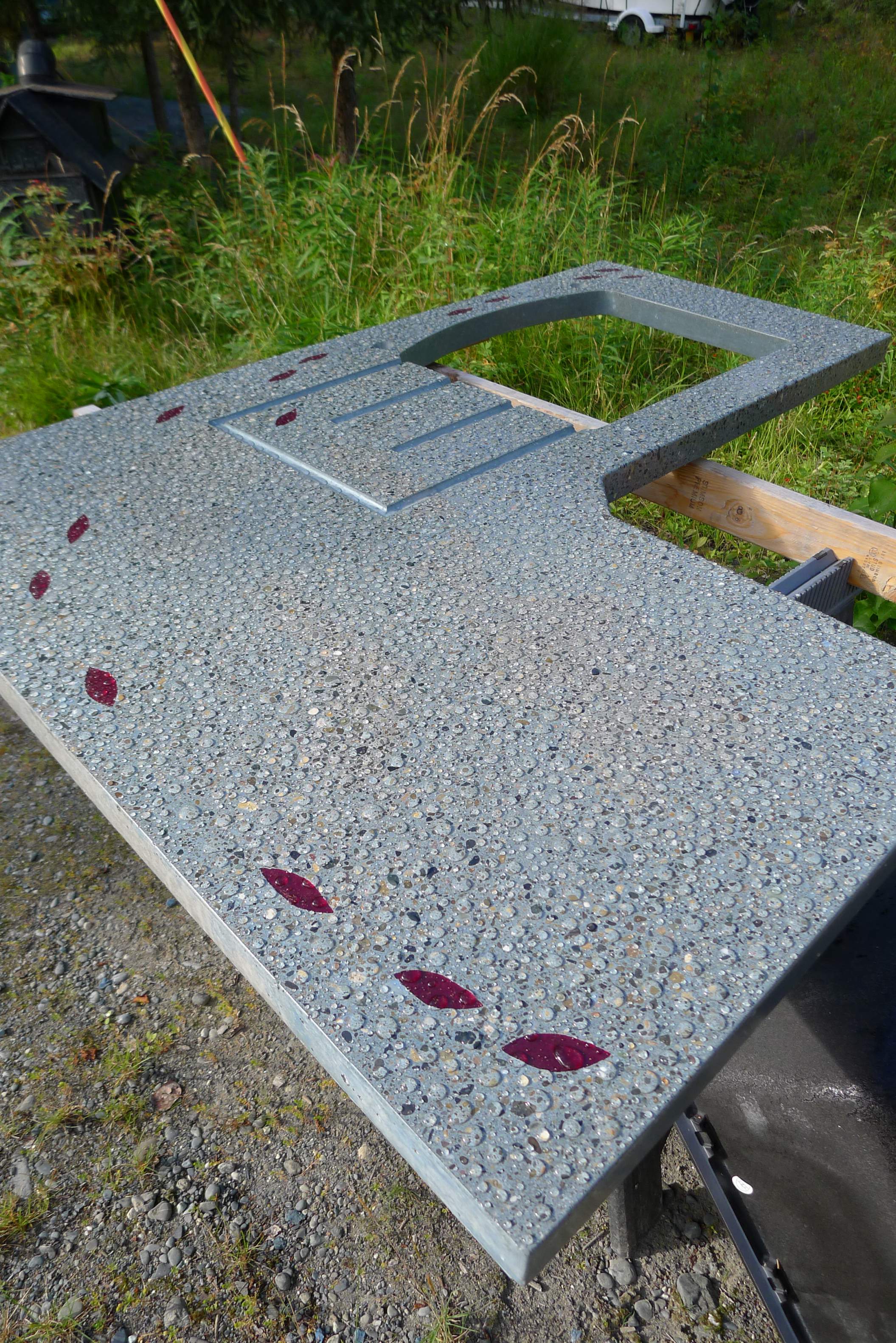

I've never used a pre-made mold, but I made a mold out of melamine for my countertop project.
Very impressive! What techniques did you use to come up with what appears to be a pretty unique surface??

There are countless cool things you can do with a mold. In this case, i applied some glass fragments to look like red salmon, and after the mold came off i ground the surface away to expose the aggregate stones. There is also some blue pigment that i added to the mix.
