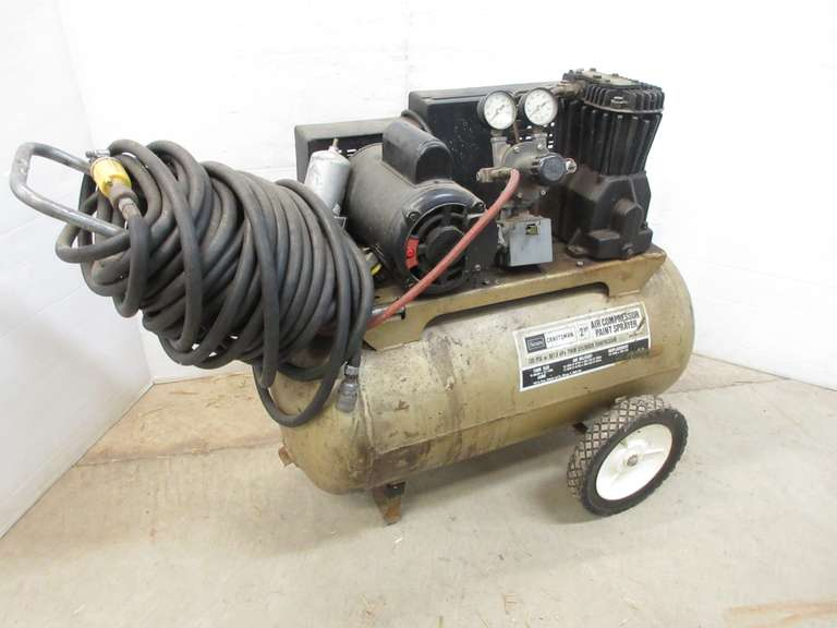

I am trying to get the compressor running but this piece is bent and leaking and I have to replace it.
Can you cut it at the bent spot and use a compression union? Maybe drive a punch inside it and straighten the tubing enough to get the union on?

I can say that for my compressor, the original tubing was hardened, not soft tubing. The original tubing got extremely warm, warm enough to have the copper change color. That makes me wonder about the longevity, and wisdom, of repairing the copper line rather than replacing it. FWIW: The copper line is available as a part for many compressors.

Anyway, got a piece of tubing from ebay and the compressor is running again. Love it. Two stage is so quiet. I added a ball valve and hooked it up to my air line system in the shop. Picture is not mine, found it on the internet.
