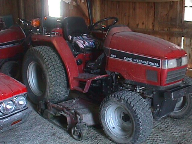

Neil, jwnge is correct in that the Mitsu's sold under the Mahindra name were originally sold in the US by Case back in the early 90's. They were then sold as Cubs for a few years. they're now the Mahindra 15 series. Check out this thread...
Mahindra/Cub/Case
You're correct in that those Mitsu's have nothing in common with the current crop of Case compacts, which I believe are mfg by Shibaura.
   / Compact Cubs vs Kubota #54
You said..."There is absolutly nothing in common between a Case and a Mahindra".....The 1140 and 1120 Case Ih of the early 90's were made by Mitsubitsi just as the Mahindra 15 series are today. I would say that makes them have something in common, maybe even a lot..
