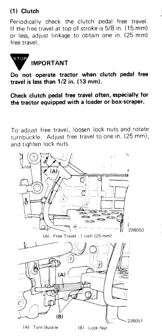

I have a shop manual with parts list and breakdown, but see nothing on clutch adjustment. I see the turnbuckle picture with a rod that connects to the clutch pedal.
Two questions:
1. Not sure which way to adjust... Do I need to twist the turnbuckle making the distance longer... or twist it the other way to make the distance smaller?
2. How do I measure the 5/8 freeplay? Should the clutch pedal have 5/8 of no resistance where i could push it with my finger, or is the free play measured 5/8 until the tractor starts moving?

   / clutch question- Yanmar #8
See instructions below
The distance you can move the pedal with your finger.
Hope this helps.
